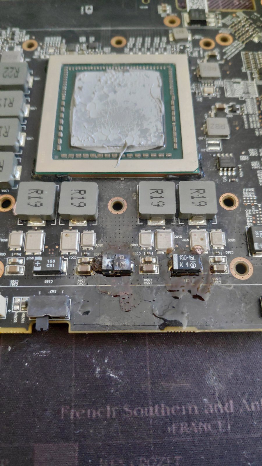

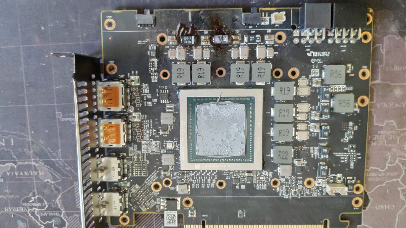

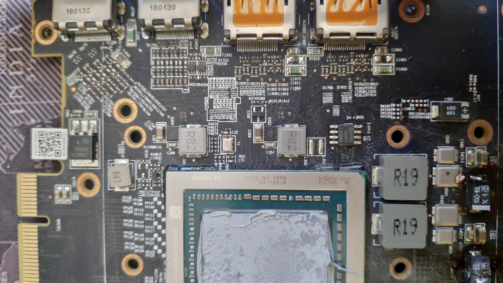

    Hello.
    I have received a GPU for 50GBP . As non-tested. I cleaned it before testing, i plugged it in , and i heard a "PUFF" sound. I saw a capacitor was blown .
    So i had measured the next to it, to find the "colprit" .
    I have ordered 3x SMD 150 with 16volts SMD.
    C547 & C558 was blown.
    I replaced them .
    I plugged it in , and now again it has blown the C547 (C548 is fine) .
    But the C547 ,melted.
    As you will see in the picture like hirosima nagasaki.
    Do we have any ,way of seeing what is the "problem" or even if i have used the correct capacitors ,maybe i did a mistake ?

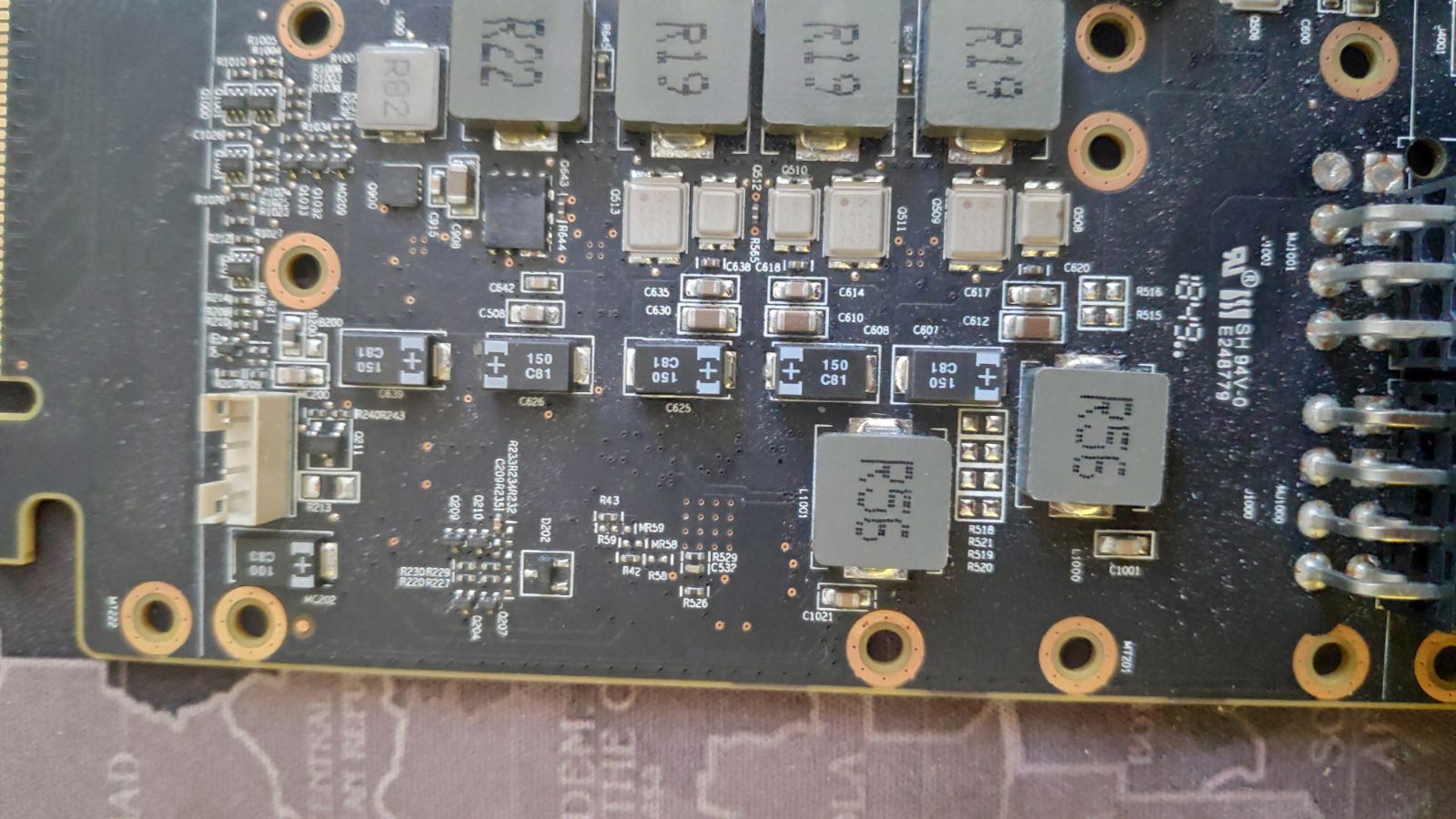

    Re: Red Dragon HBM VEGA 56 (Triple FAN) - Blown ?
    You installed the capacitor backwards, it is different from the other two, see picture
      I was almost sure that all the capacitors were facing the same way.
      But, you are right in the picture that you showed me.
      I have 1 replacement left,i will try today and change it the right polarity.
      And crossing my fingers because for those x3 capacitors i waited almost 1 month.Due to the "rarity".
        We got a post!
        We finally got a post, i reversed the capacitor that i had, and is working now.
        Tonight i will test it in gaming and hope for the best.
          Yes ,we have 2 hours of FuMark stress test,and gaming like 4-5 hours ,and nothing occured.
          Really happy now.
          The capacitors is the main fault guy , it's common in this series , as i have found .
