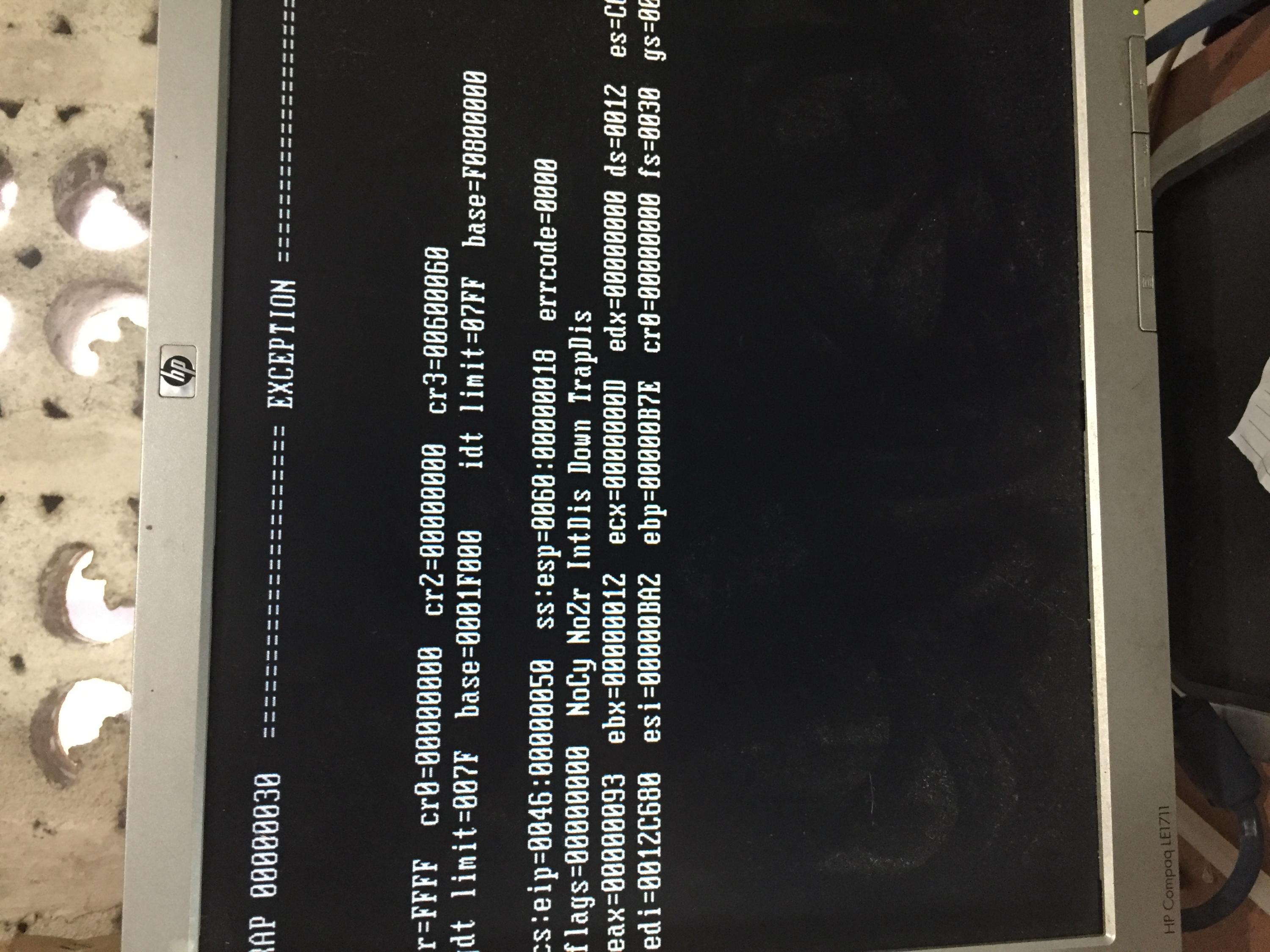

    I have this asus board which bios is corrupted , i flashed with one from the manufacturer site but still the same issue giving me this error attached, also tried replacing the chip same error shows cannot continue to reinstall os, please help on this

    what os you instal.

      Re: Asus P5QPL-AM problem
      windows 10 and even windows 7
        already tried replacing ram both slot but still same issue error message cannot continue to boot to install os
          Are you installing the chipset driver .inf`s during the install ?
            @smdflea during the install set on bios to bootable usb after detecting bootable not continue shows that error message nothing happens
              now there is problem after shuts off for a long time bios got corrupted again show boot block incompatible

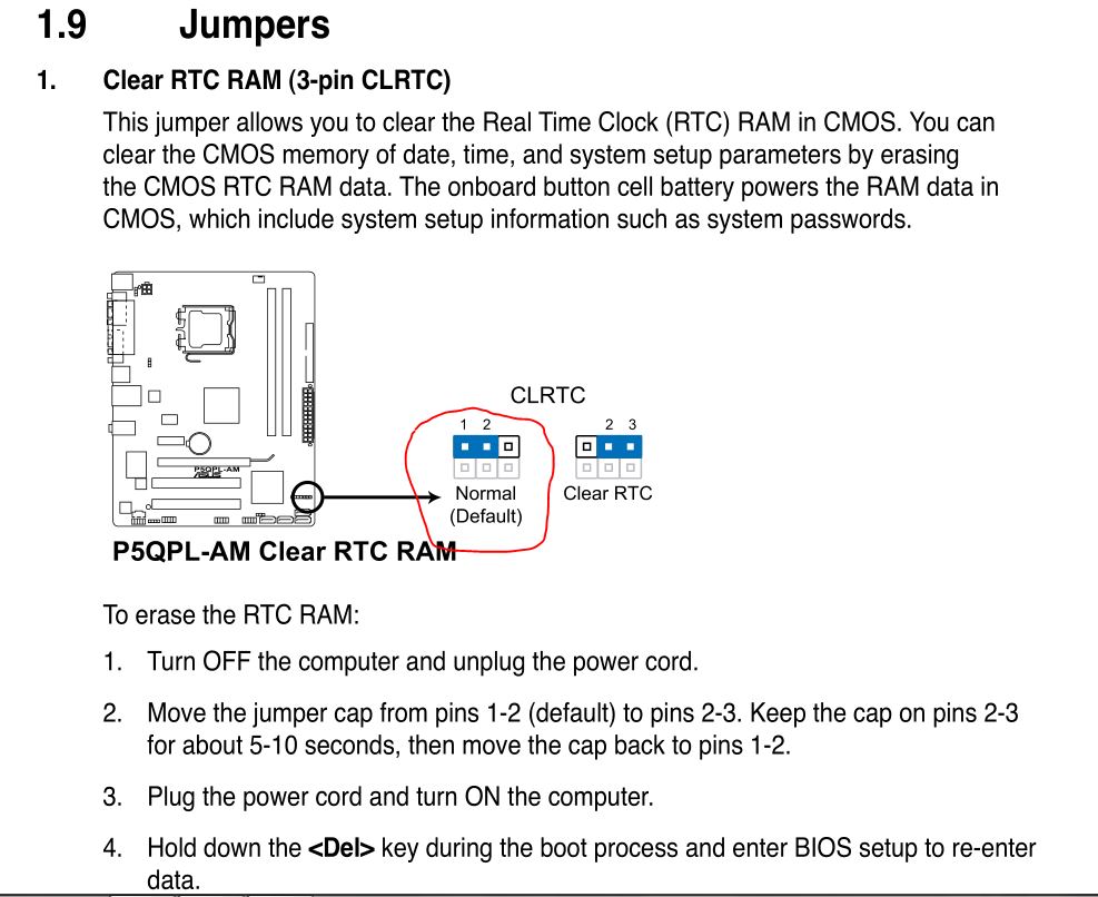

                    • 20898
                    Re: Asus 7 problem
                    Do you have the clear CMOS jumper set on the normal position
                      Clean the dust bunnies off the motherboard! Check for dust bridging any cap legs! Looks like in that screenshot that Linux distros or the like are crashing.
                      I had symptoms like that with my Asus P5QL Pro, after popping in a Wolfdale and it looked like I ended up moving dust around, so I got dust that interfered with connections.
                        That doesn't sound like a CMOS issue, but worse, which the PSU may be the cause!
                        What PSU do you have?
