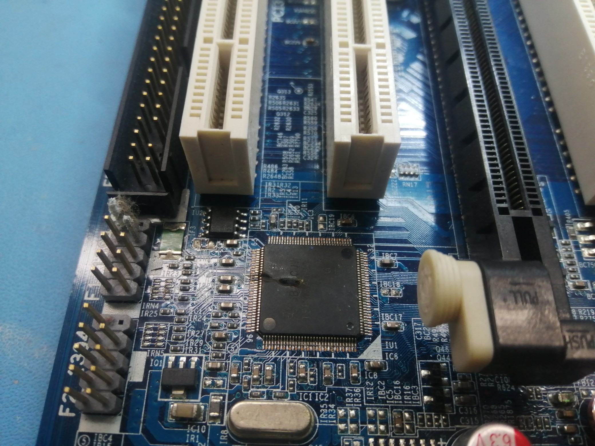

    I have this Gigabyte GA-N650SLI-DS4
    It does not have onboard SVGA
    With no graphics card fitted it beeps as you would expect then continues to boot (According to the POST test card) to 7F
    If I put a graphics card in the PCIe slot nearest the CPU it gets into a loop up to C1, repeats several times, then goes to C3
    If i put a graphics card in the other PCIe it beeps to say there is no graphics card, then hangs for a while and eventually boots to FF
    I thought there may be some problem with the North Bridge but then I spotted this QFP near the PCI slots that looks somewhat distressed
    It's a TSB43AB23 which is readily available on aliexpress for a couple of euros. The datasheet says it transfers data from the 33MHz PCI to IEEE1394
    http://www.ti.com/product/TSB43AB23
    So obviously I need to replace that. I wonder if it is actually causing all the problems with the PCIe slots as well, I thought PCIe was North Bridge bus and PCI was south bridge? but I will happily believe this could cause problems on the other bus. Also what would cause it to burn out? Someone connect something wrong like a USB to the 1394 header? There is some corrosion on two pins of the 1394 connector as well, maybe something got inside here?
    OK so anything else worth checking first or just order a chip?

      These SLI boards usually have a bridge card (that empty slot between the blue PCI-E and PCI slots) and will exhibit these issues without them.
      Oh, and that TSB45AB23 is just the 1394/FireWire chip.

          Re: Gigabyte GA-N650SLI-DS4 motherboard not detecting PCI-e graphics card
          +10
          You need that bridge card to get a video card working (whether in SLI or single mode), as Dan suggested.
          As for the TSB45AB23 Firewire chip... you can just remove it for now, and the board should still POST without it.
          Finally, I suggest adding a fan on the NB heatsink. nVidia nForce chips are known to run hot *and* go bad over time when they do that due to bumpgate issue. So try to keep that NB as cool as possible.

            Oh wow. This is a perfect example of why I love this forum! The knowledge and help here is the best on the 'net IMHO
            I'll go order one.
            hmmmm.. does that bridge card thingy have a specific name i can google?
              I found it in the manual. Should have looked there before
              The pic of the one in the manual says GC-SLISW-C55
              But the only used ones I can find seem to be this type
              https://www.ebay.es/itm/Gigabyte-Gc-...0AAOSwmaJcMWMl
              which looks similar on the pics but may not be the same.
