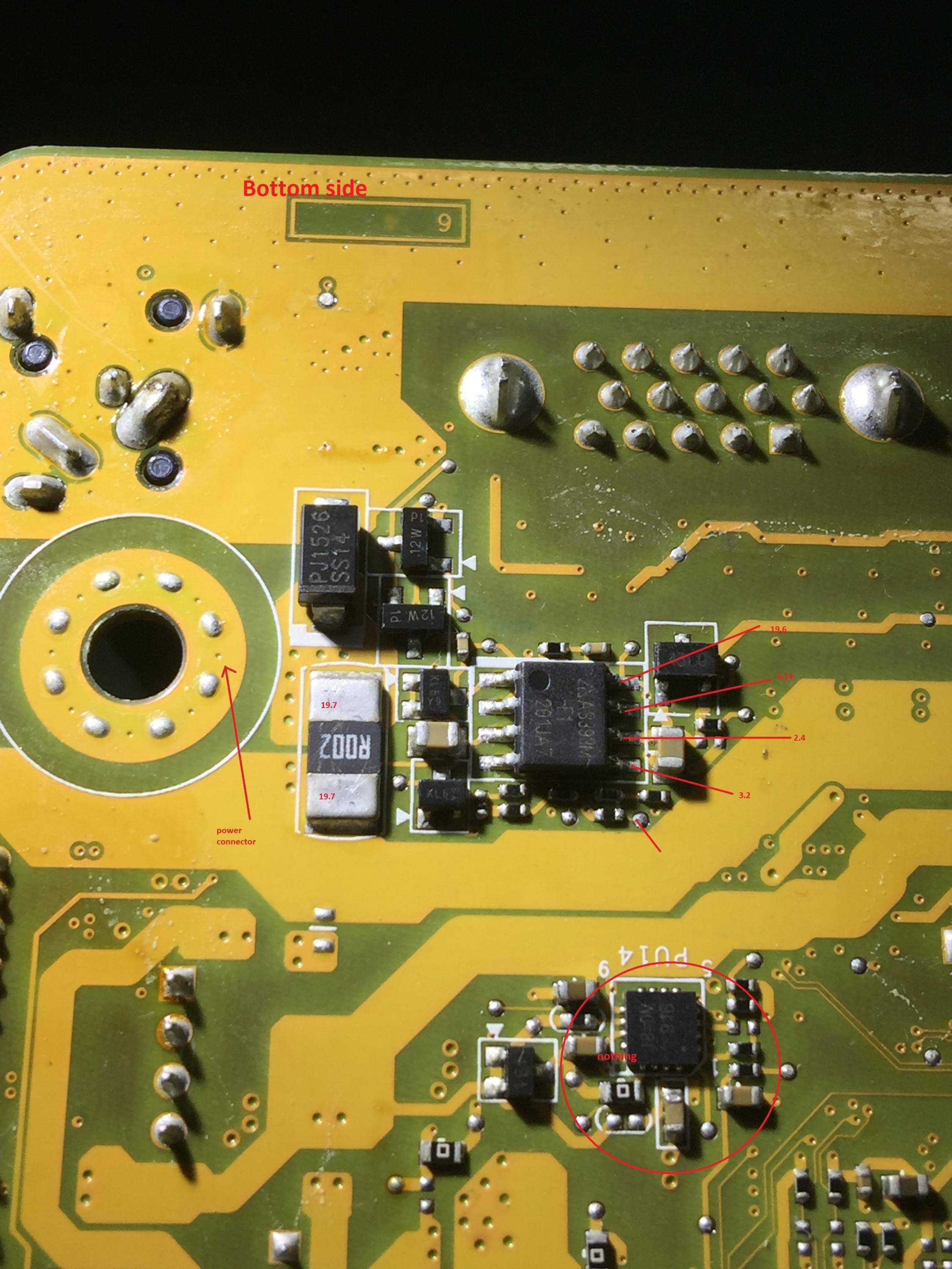

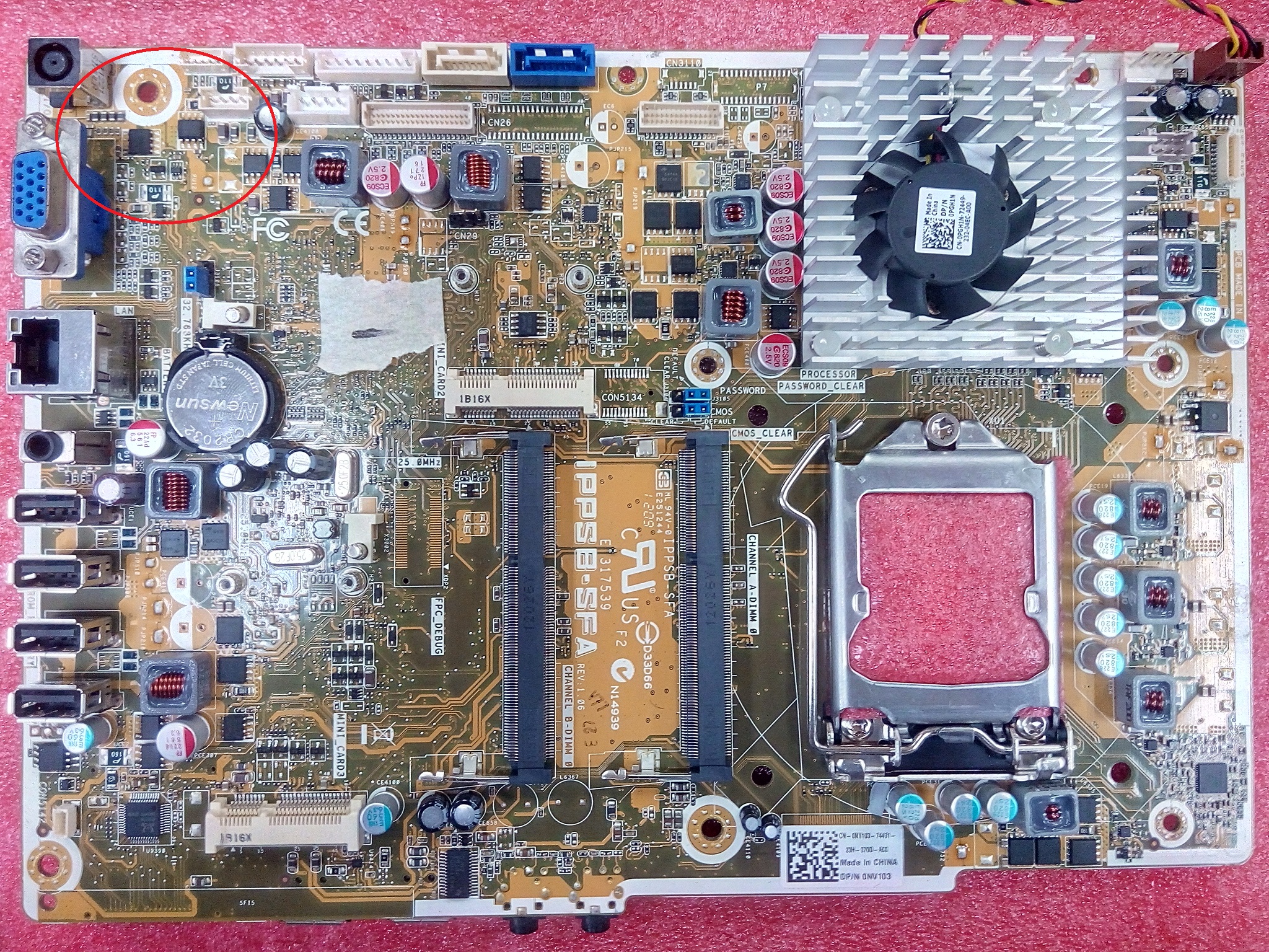

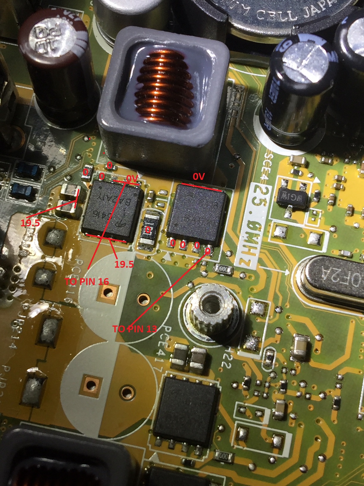

    Hi everyone
    I have a Dell inspiron 2320 all in one seems to have the 19v rail. the power LED is not on. The charger I am using is for another Dell Laptop it has the correct voltage and polarity. Amps are a little low for this computer but should be enough to turn it on or give a power light. Don't know if the sense pin would be a issue.

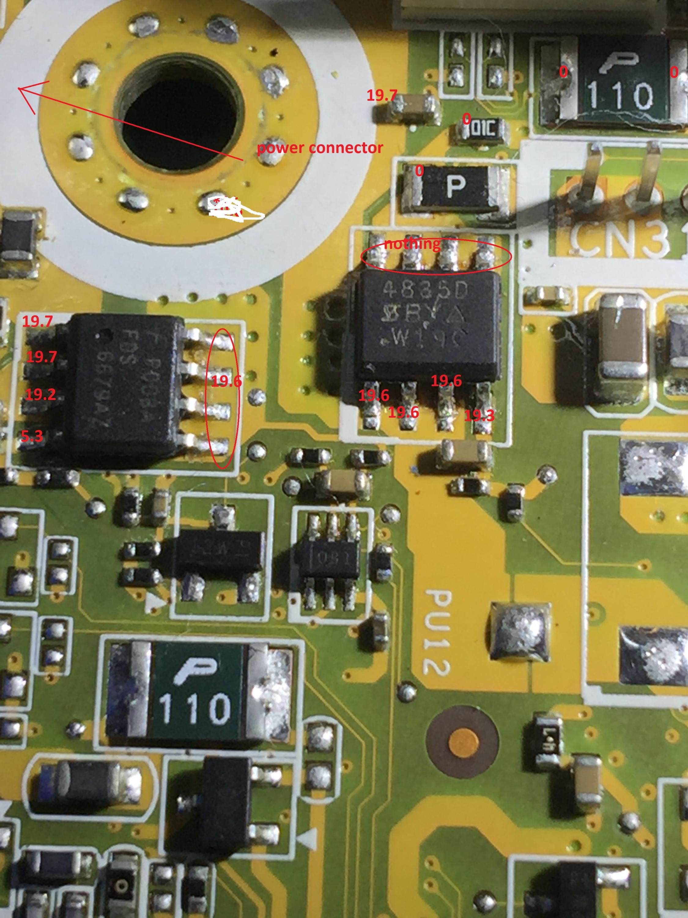

    I have the 19v rail but not the others. I am including a few images with voltages. mosfet 4835D has nothing from drain. I am still learning this and would hope someone could point me in the right direction. a few other mosfets has 19v but nothing from drain. the only areas I could find 3v and 5v are in the images. checked the Bios chip for 3.3 on Vcc but no current at all to the chip.
    Any help would be much appreciated

      SIO Pin 85 0v Regulator 8 17 20 0v pl401/403 coils?? 0v. I was thinking 3/5 regulator..but it's not getting any voltage. nothing getting hot on the board..

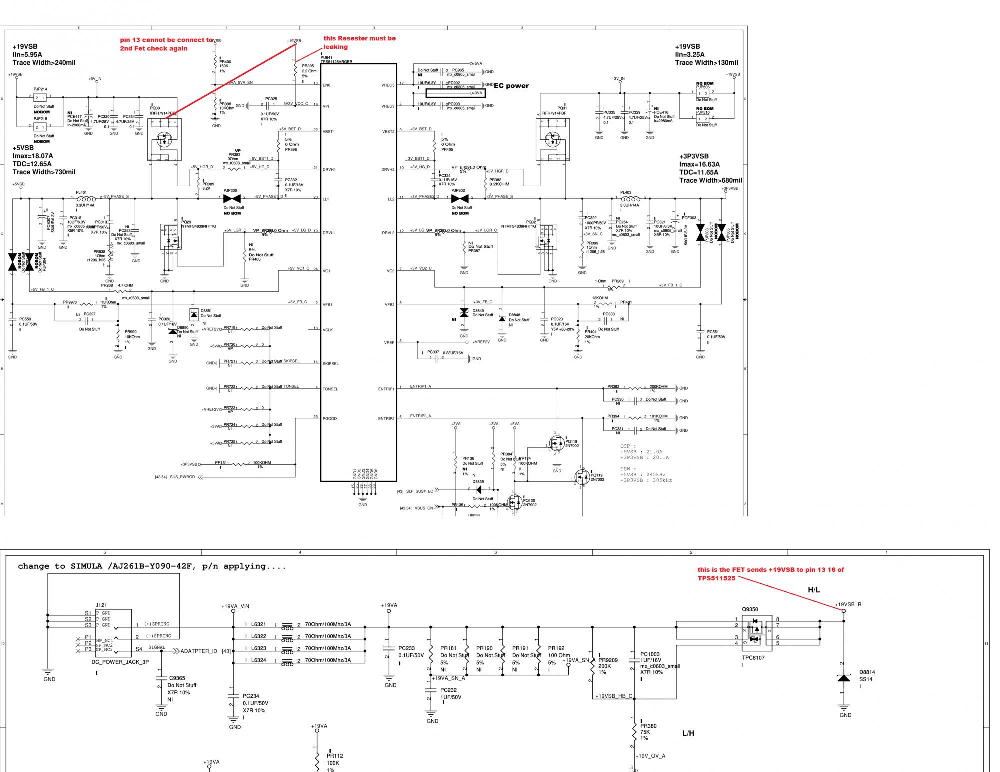

                        TPS51125 pin +19V Test the PR395 PC325 for short +19VSB
                        Pin 13 ENO must be 1.19V test PR400 PR398 or track it back

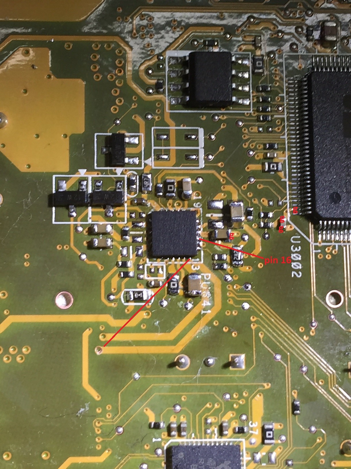

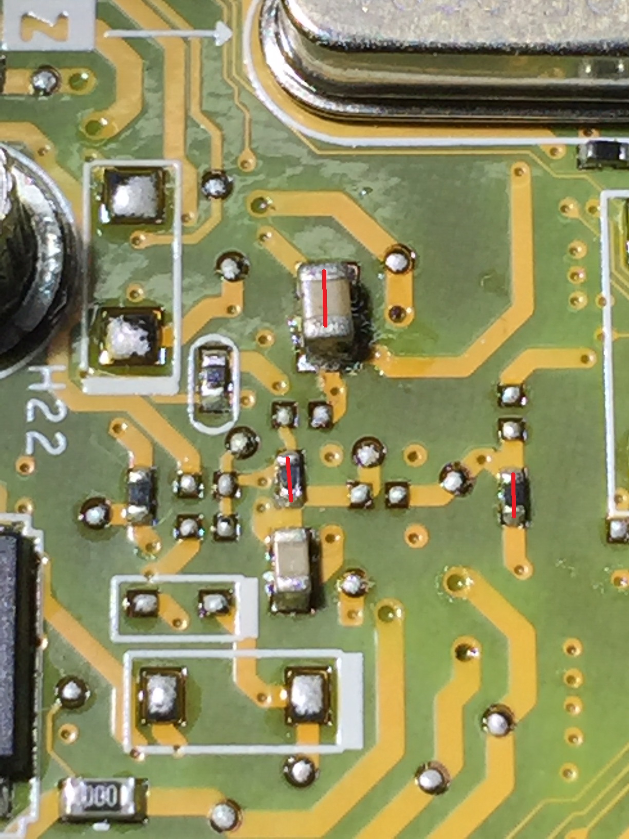

                          According to the schematic pin 13 of TPS51125 " pu641 " runs to pr400 and pr394 but on my board pin 13 run to a Via unless I am look at wrong chip. I traced pin 13 to the opposite side of the board. seems to be some cap's and resistors in that area. a few of these has continuity " photo ". pin 16 " vin " of pu641 seems to be shorted to ground. I did not have much time to look at this yesterday, I should have more free time today.

                              Sorry I was checking wrong pin before. Pin 13 and 16 are not shorted. I traced both pin's to the opposite side of the board. the both end up at mosfets. one has no power at all. the other is getting 19.5 in but nothing out. in the attached image the mosfet on the left is a 6416 the other is a 6418

                                uplode a close up pic of TPS51125 with the caps & resistors
                                • TimT
                                  • Nov 2012
                                  • 268
                                  • us
                                  Re: Dell 2320 AIO IPPSB-SFA missing rails
                                  The info I posted for pin 16 was incorrect. pin 16 is shorted to the SIO? a few caps along the way? pin 16 has no trace. So I cannot see were it connects to anything unless it connects to the pad under the ic. pin 13 runs strait to a via and connects to a mosfet. pin 16 has continuity to any ground I touch

                                    If Pin16 of tps51125 is shorted to gnd, then you have short in 19V rail as this pin is VIN for this ic and is supposed to be 19v. If you have dc power supply, then inject voltage on that pin to see what is getting hot.

                                      I ordered a new tps51125 and problem solved! Thanks everyone!!
