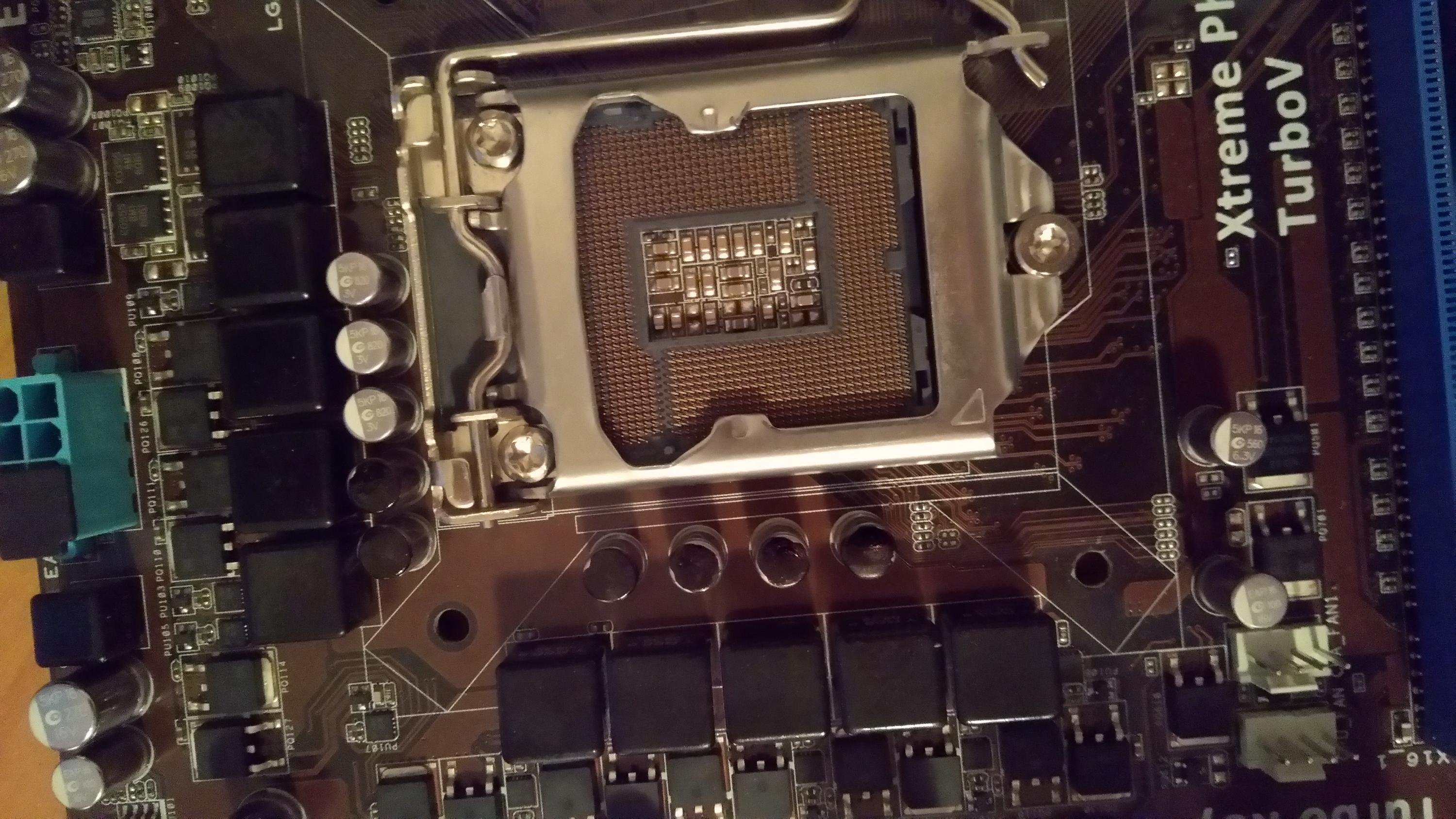

    Hello.
    Have this PC board AsusP7P55D LE rev. 1.10G - that not start
    Post card show no clock just still light RSTJ led
    Im new to PC board repair. Have somebody clue what can i check first?
    I checked all power mosfets but everyone shows some good voltage

      Re: PC borard ASUS P7P55D LE - not start
      Well that is easy. Start tracking the voltage from dc in.
      Somewhere there is a short or something doesn't output.
      There needs to be 3.3v always and 5v.
      Even in diagram you will see them with 3.3alw or something similar.
      If those voltages are missing the you don't have power button voltage(3.3v)
      Bios voltage(3.3v)
      Reflash the bios (sometimes it makes the laptop dead)
      Take the charging ic from diagram and measure all the voltage and write them here.

          power button and alw voltages are present. the board starts after switching power button, all mosfets have voltages presents, but RSTJ light on postcard not shut down like normal
          dont have diagram for this board. i found it on vinafix. but dont have registration on it
              Damn guys what could be wrong?
              i smell something bad so i remove processor, touch capacitors around him and got REALLY BAD BURN to my finger. i mark that capacitors that got really hot
              Do u think that thats capacitors got little short? because voltage was about 1.1V and slowly drops to 0.9 and coils got heat
                Diode mode each mosfet,lift coils, lift caps out
                  Solved
                  It was real pain in the ass and cost me about 2 hours to replace that 9 caps but it worth that.
                  replaced caps for caps from GPU im now repairing and board comes to life

                    Fantastic!
                    Can you confirm those polymer caps could go shorted?
                    Do you have esr meter or capacity?

                      Its great because it can identify many components/mosfets, diodes, caps, esr meter, transistors/ . its built in esr meter cannot identify component - that caps. it cannot identify caps if it is bolded and are sure bad
                      i think that caps have so high resistance that act as a load, because it burn even without processor
