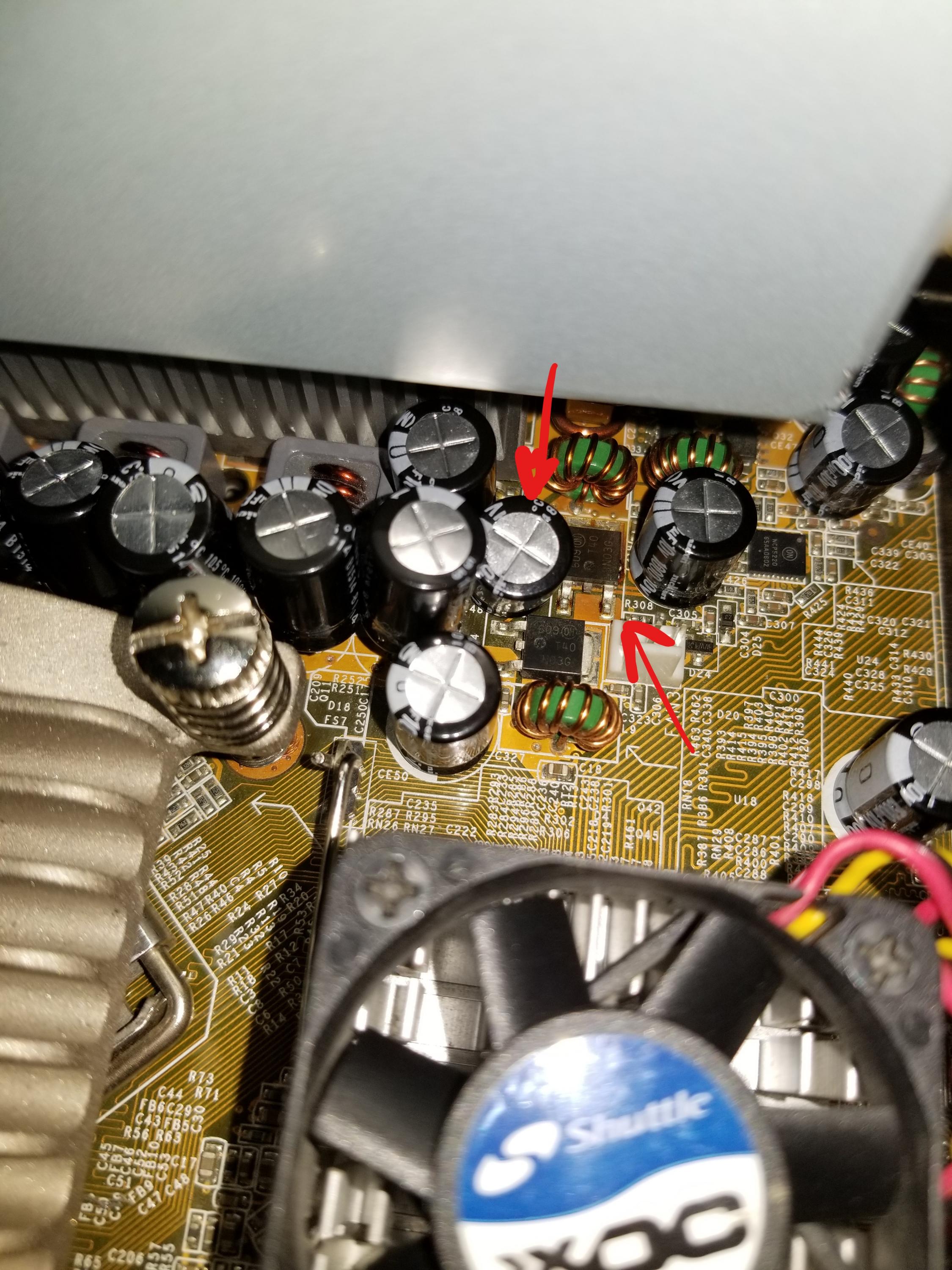

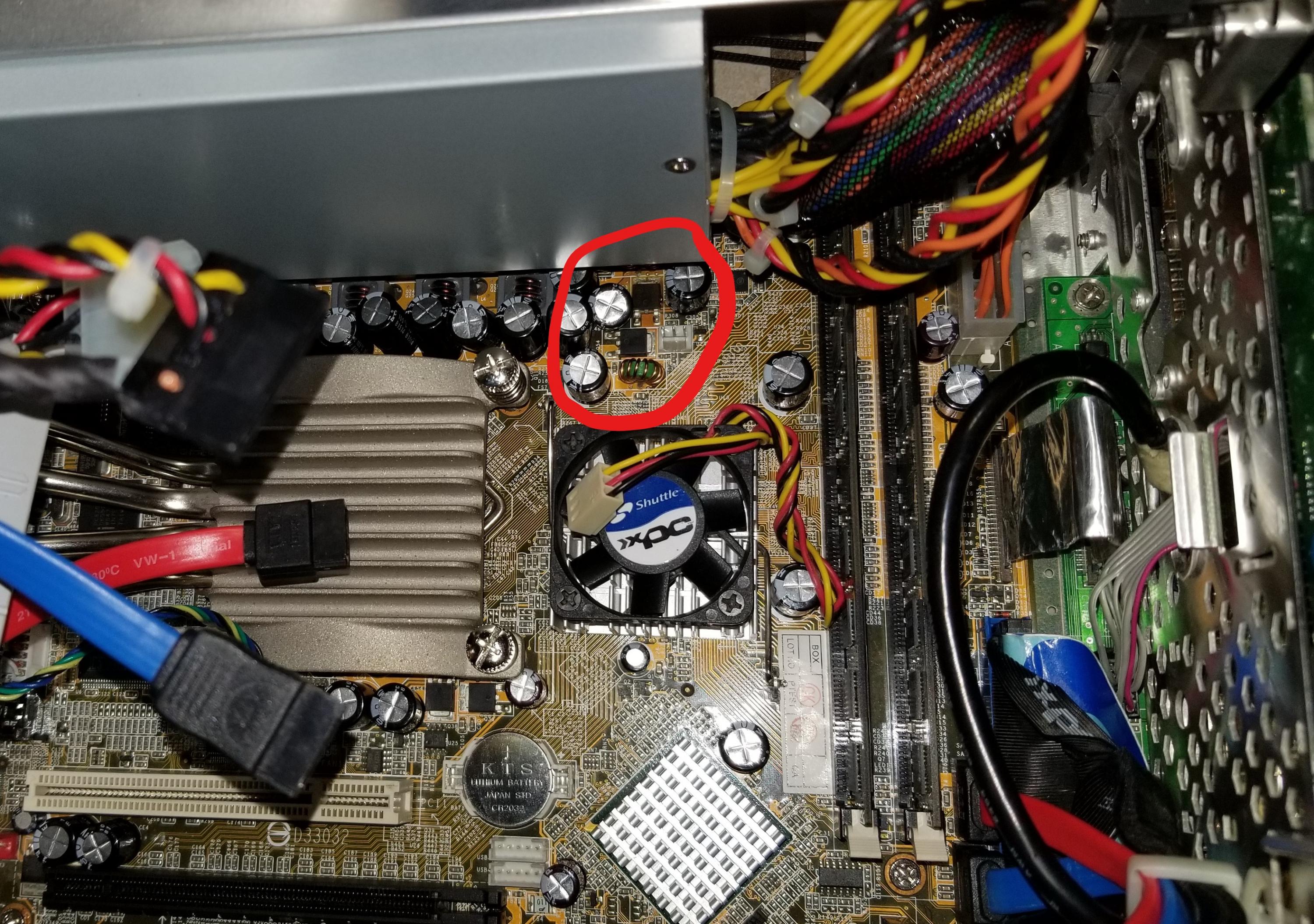

          Ok here are 3 pictures progressively more zoomed in to give you an idea where this is on the board. In the first, I circled the area. The second picture has the arrow to the cap that was originally bulged and the chip that is very hot. Third is circling something coming from under the chip that just doesn't look right. It looks almost metallic with a flashlight like solder, but not sure how that would be.
          BTW, the cap next to the chip there is intentionally angled, since the Nichicon caps were slightly wider than the originals, so it was hard to fit everything right down on the board with so little room to spare.
          I may replace the caps right around there again because of the heat they experienced. I don't know if they got damaged. I have the burn on my finger to prove how hot that damn thing got in less than a minute of being turned on.

            That's a MOSFET. The metallic bit underneath it looks like where the solder has started melting and coming out! I'm not surprised you burned your finger on it. It should not be getting that hot.
            Inspect the board where you worked in it and be sure there are no shorts, for example some solder could be bridging pads.
            Otherwise, that MOSFET or another connected to it could be damaged or the controller driving it could be bad, or both.

              So, I tested the MOSFETs according to this post on this forum: https://www.badcaps.net/forum/showpo...4&postcount=19
              Q53, the one with solder under it, measured the following:
              Pin 1-2 = 16.2 ohms
              Pin 1-3 = 14.6 ohms
              Pin 2-3 = 1.8 ohms
              Q54 next to it:
              Pin 1-2 = 27.5 ohms
              Pin 1-3 = 3.6 ohms
              Pin 2-3 = 24.9 ohms
              According to the MOSFET testing post, these are shorted. I tested identical MOSFETs on other parts of the board and they measured in the Mega Ohms with one pin combo measuring around 30 ohms. So am I safe to assume that these two things absolutely need to be replaced? And am I safe to assume that they are the root cause of the system instability and heat?

                Something does not sound right with those readings, yes, you should have similar readings to the other MOSFETs on the board, but it's harder to analyse the results without knowing which pins are which.
                Can you list which numbers you used for which pins? (Gate, Drain, Source)? Did they match those in the attached datasheet?
                One of those MOSFETs should have the Source pin connected directly to ground. Is it Q54 or Q53? Also, one should have its drain connected directly to the 12v rail. Which one is that?

                  Yes I looked up the datasheet for it. My pin labels match the datasheet. Pins 1, 2, 3 left to right. Pin 1 = gate, pin 2 = drain (which is just a stub going to no where on these, but is continuous with the large pin 4 drain on the datasheet), pin 3 = source.
                  So it seems for Q53, pin 2-3 (source to drain) is at 1.8 ohms or practically continuous. For Q54 pins 1-3 (gate to source) is at 3.6 ohms, which seems to indicate a short between the gate and source, no?
                  I'm not exactly sure how to tell which is hooked to 12v. But I figured that pin 11 of the 24 pin connector being 12v would be a start. I used the common leads of the 4 pin power connector to test ground.
                  Drain of Q53 (the large part soldered to board) is 0.2 ohms to 12v. The Source (pin 3) of Q54 is 0.2 ohms to the common lead of the 4 pin ATX connector - ground.
                  Worth noting, the drain of Q54 and pin 3 of Q53 are only 1.8 ohms from 12V. That seems very low?
                  I wish I understood this better to provide you some better info.

                    I think you understand it quite well actually. Your info is good anyway. OK. So Q53 will be the high side MOSFET, and Q54 the low side.
                    At the very least, It seems Q53 likely is bad. The low side MOSFET is harder to check in-circuit because the CPU or chipset presents a low resistance to ground in parallel, but a dead short will of course be obvious. The 24.9 ohms you get there would likely be normal, but the readings show what looks like a short to the gate also, so Q54 is probably bad too.
                    I would remove both MOSFETs at this point and re-test them out-of-circuit, to see if any readings change.

                          Originally posted by racer2086
                          Which part is that?
                          I've circled a controller in green on this image. You would have to trace out the connections to see if it's the right one for those particular MOSFETs.
                          -David VanHorn
