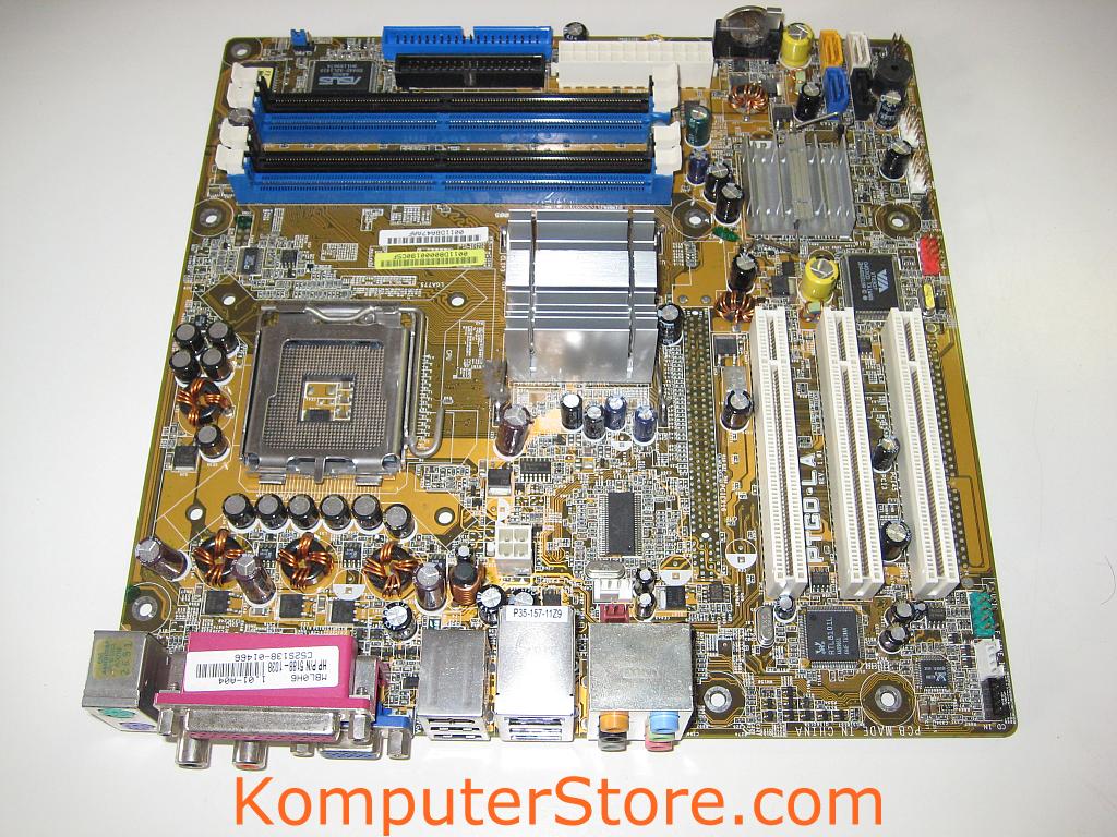

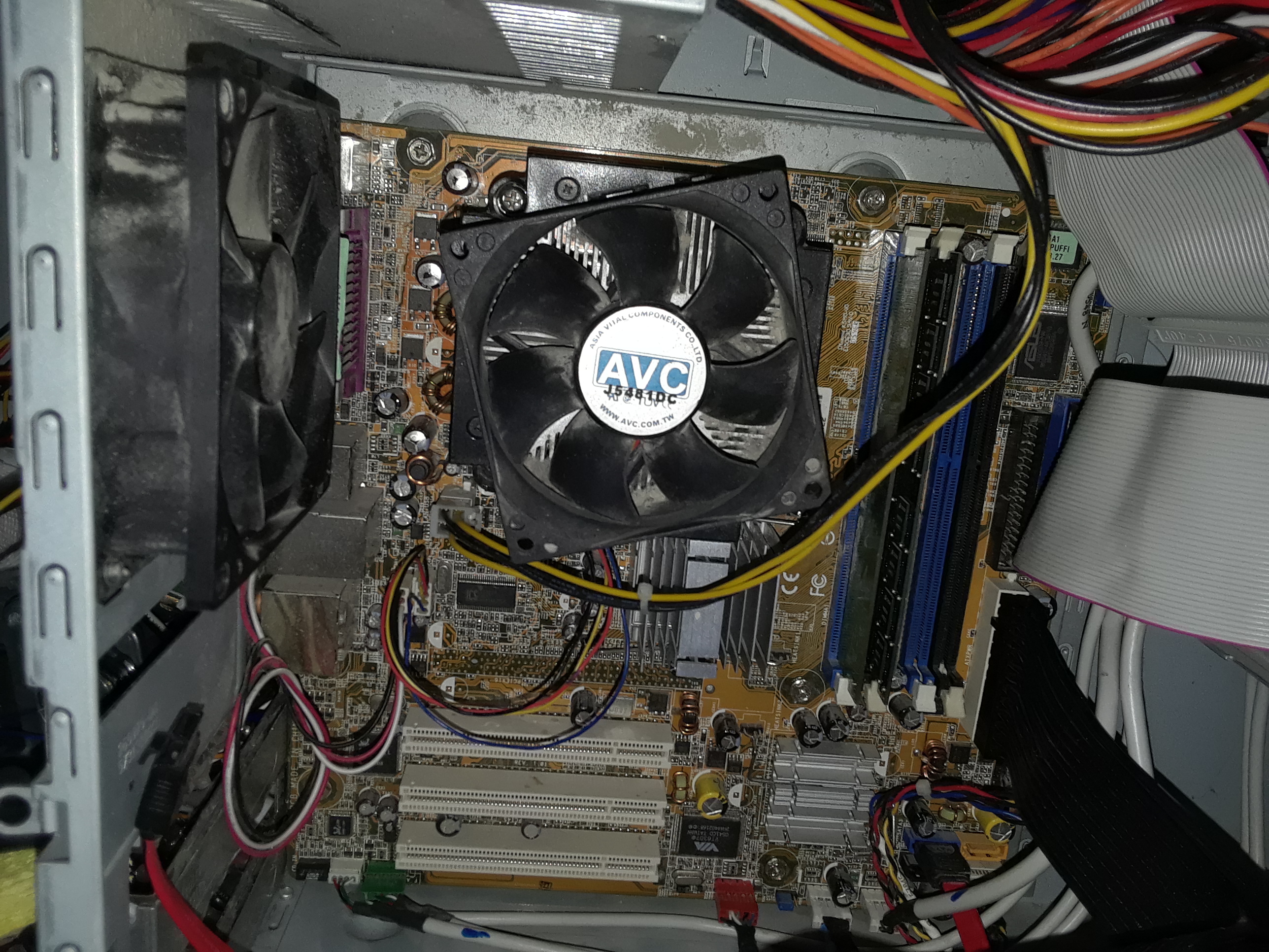

    Hello, i was given a old HP PC which has a Asus PTGD-LA motherboard with 3 dead KZG capacitors on it (all three are 1000uf 16v) I'm looking at using polycaps for this recap, the capacitors i'm looking at right now are the NCC PSG series polycaps but i have not decided if i will go with polycaps yet. This is also the first motherboard i'm trying to recap (i would not care too much if i accidentally kill it) but if anyone has any tips on how to do it without killing the motherboard then i would highly appreciate if you could tell me.
    Here is the best photo i could get of the motherboard as of yet.
    I'm not a expert, I'm just doing my best.

    Just go with Kemet A750, they are cheap and close enough to the original KZG.
    Those PSG don't really make sense because they are darn expensive...
    A750 are around half the price. And frankly, with a Board without an x16 PCIe I'd rather not invest much at all...
    Is that really an i915 thing with a Pentium 4??
    Anyway:
    What you really need to do is kinda preheat the board because those PCBs can really suck up heat and is also designed as a heatsink in that area...
    Do you have hot air station??
    Or something similar??
    That's rather important in this case...
    Without it, you have a big problem...
    Because its very hard to desolder them, even with a good iron...
    So preheating it is the most important thing in all of this...

            here's a better pic of the board off the net. from the OP's pic, it looked like the board only has 2 power phases for the cpu vrm which is misleading. it actually has 4 phases which makes it a suitable candidate for polymodding.
            so i almost ended up trolling the topic because i thought the board only had 2 phases and shouldnt be polymodded...

                            You might want to remove that CPU heatsink and check what's under it (in terms of caps). Some ASUS boards come with Chemicon TMV, which are also prone to failure and should be replaced.
                            You could also go with Wurth Electronics polymer caps if you want to keep costs low. Series doesn't really matter that much with polymers - they would be pretty low ESR already. So pick whatever is available.

                              Finally got around to removing the heatsink and..... all of the caps under it are NCC TMV 680uf 4v...

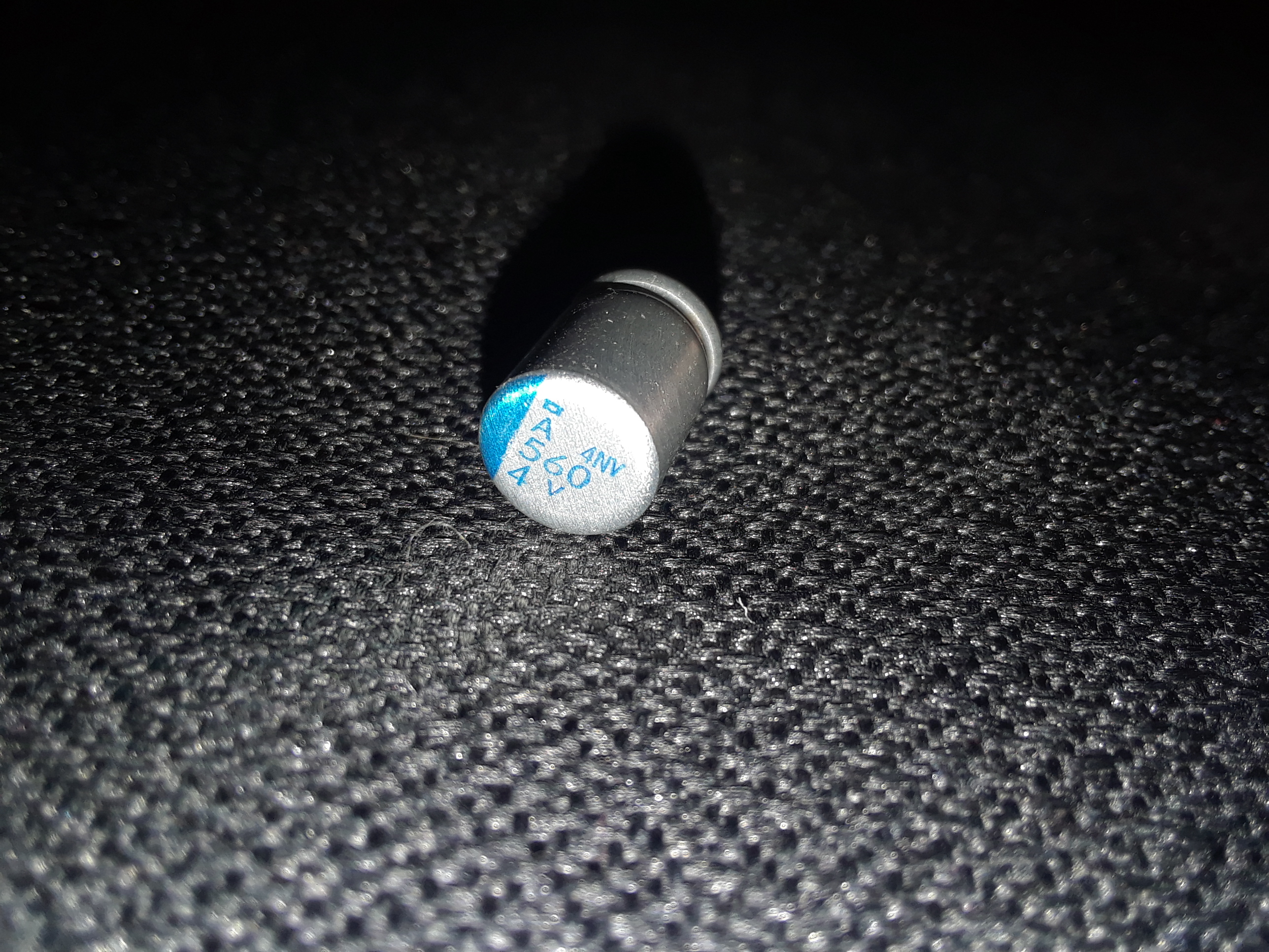

                              though i do have some salvaged 560uf 4v polycaps and i wonder if i could get away with using them to replace the NCC TMV caps.
                              Here is a photo of one of the 560uf polycaps i was talking about.

                                Would likely be fine. How many TMV caps are there on the board? If 6 or more, I would say it's definitely safe to replace them with the PSA poly's.
                                  Re: Asus PTGD-LA with 3 dead NCC KZG capacitors
                                  about 10 of them, 5 of them appear to have failed based off the way they look (the rubber bung on the 5 of them appear to be pushed out).
                                  Note: I just spotted another KZG cap on the motherboard that appears to have not failed yet, it's a 1500uf 6.3v cap.
