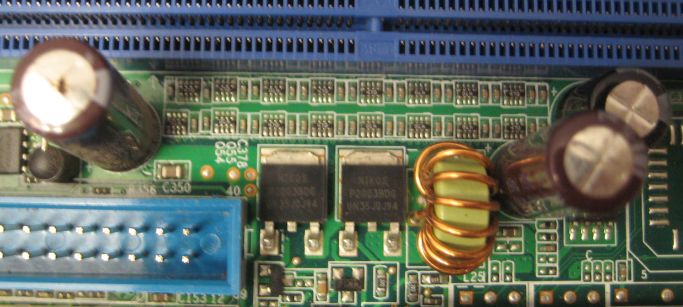

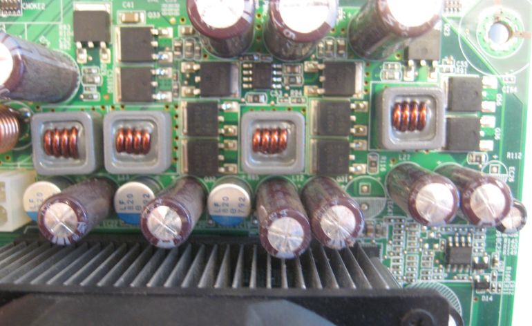

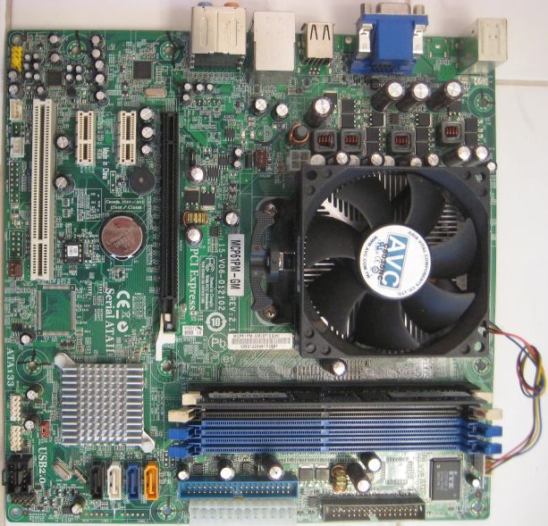

    The unit is a Gateway GT5670 with AMD Phenom triple cores 8400 in AM2 socket with 4GB RAM, 500GB SATA drive and nVidia GeForce 6150SE GPU.

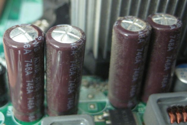

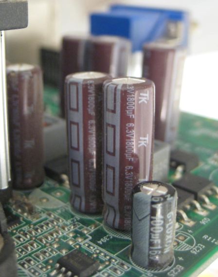

    Unit is not booting any more. On the MCP 61PM-GM MoBo (Pic 'MoBo'), caps are bulging or oozing in 4 clusters: along the CPU (see pics 1 & 3), the memory (pic 4) or the PCIe slot. Caps are TK brand, see pic 2.

    But if you want to try, replace the ones for the Memory VRM first. Remember to look up the Datasheet of the original one and replace it with something equal or slightly better...
    If size fits, Panasonic FM is best for smaller capacity, for larger ones FR and FS are also a good option. But look at Datasheet first...

      Well, that's your problem right there! - Bulging caps. Need to replace all of those TK caps.
      For the ones around the CPU, use any of these:
      Rubycon MBZ and MCZ
      Nichicon HM, HN, and HZ
      or polymers (Nichicon LF and Chemicon PSC are pretty solid choices... pun intended )
      I have a Gateway GT5656... same motherboard as yours, though only a REV 1.0. Came with Sanyo and OST RLP caps instead of TK (except for the VRM high side, which is all TK).
      Anyways, there's a really good chance your board will work fine after a recap.
      No, don't gamble like that. Replace all of the bad TKs at once. This motherboard has three buck regulators: one for the CPU (obviously), one for the chipset (middle of the board, right where the model is written), and one for the RAM. Continuing to run the board with bad caps on any of these spots risks destroying your RAM and/or chipset. I see some solid caps around the CPU, so at least that won't get damaged.
