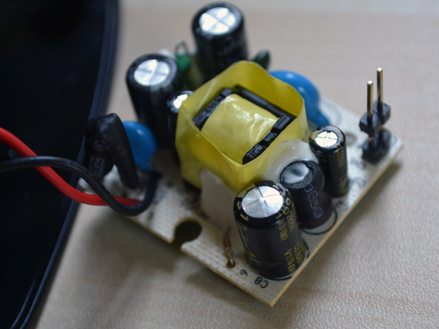

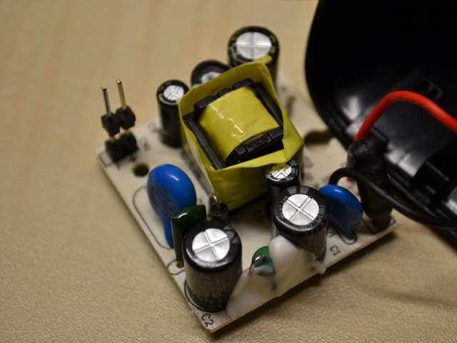

    They just bought another repeater there and after returning from Spain brought the Maxxter to me to have a look at it. Just one look on the small PSU board showed the culprit: a bulging 680uF/10V cap in the 5V powerline, making this Voltage drop (under load) to well less than 4V.
    I replaced the bulging cap with a 1000uF/10V (didn't have a 680uF in stock), but left the other 3 caps on the PSU board for the time being. I may replace them later on. Reassembled and plugged the repeater in the mains. It immediately came back to life and worked again, with user config still intact.

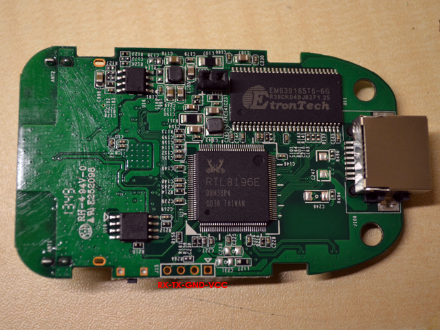

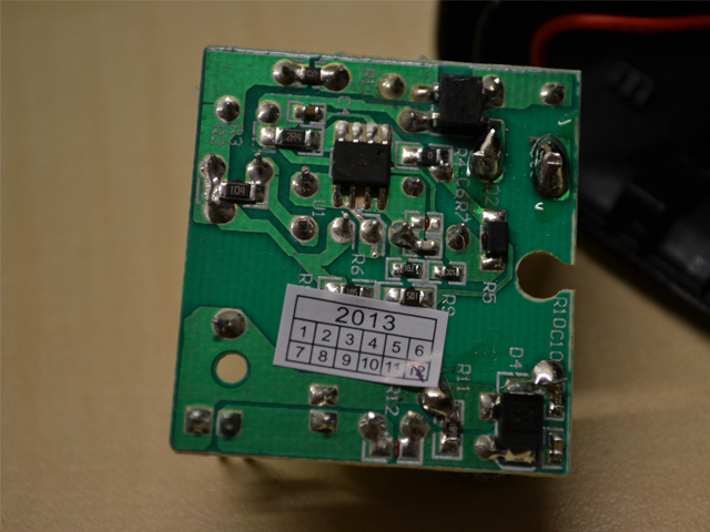

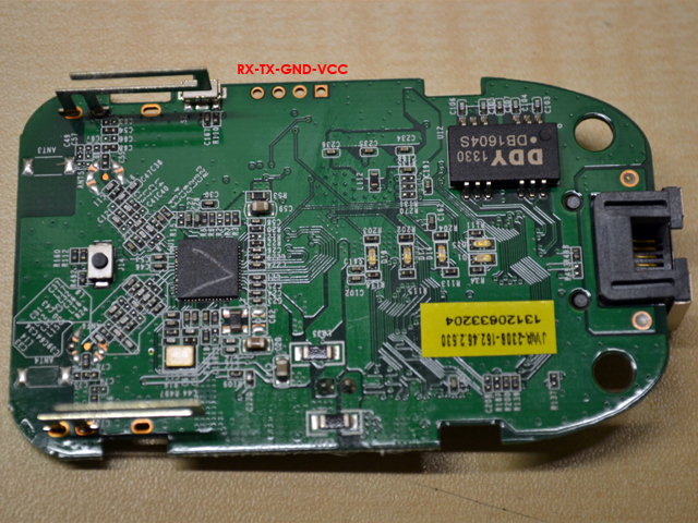

      I have a suspicion the bulged cap failed because it was fitted very close to a ferrite core coil and a small transformer, which both get quite hot when the repeater is running. Even more remarkable: the manufacturer had more than enough space on the PCB to put this cap further away from both components Talk about planned obsolence.
      Here are a few photo's of the device. They are not mine, though, as the repeater is already reassembled and test running. Both shelve halves are not screwed but glued together by design, and I don't feel like breaking it open again. Another indication hinting at planned obsolence. The last photo clearly shows the bulged cap.
