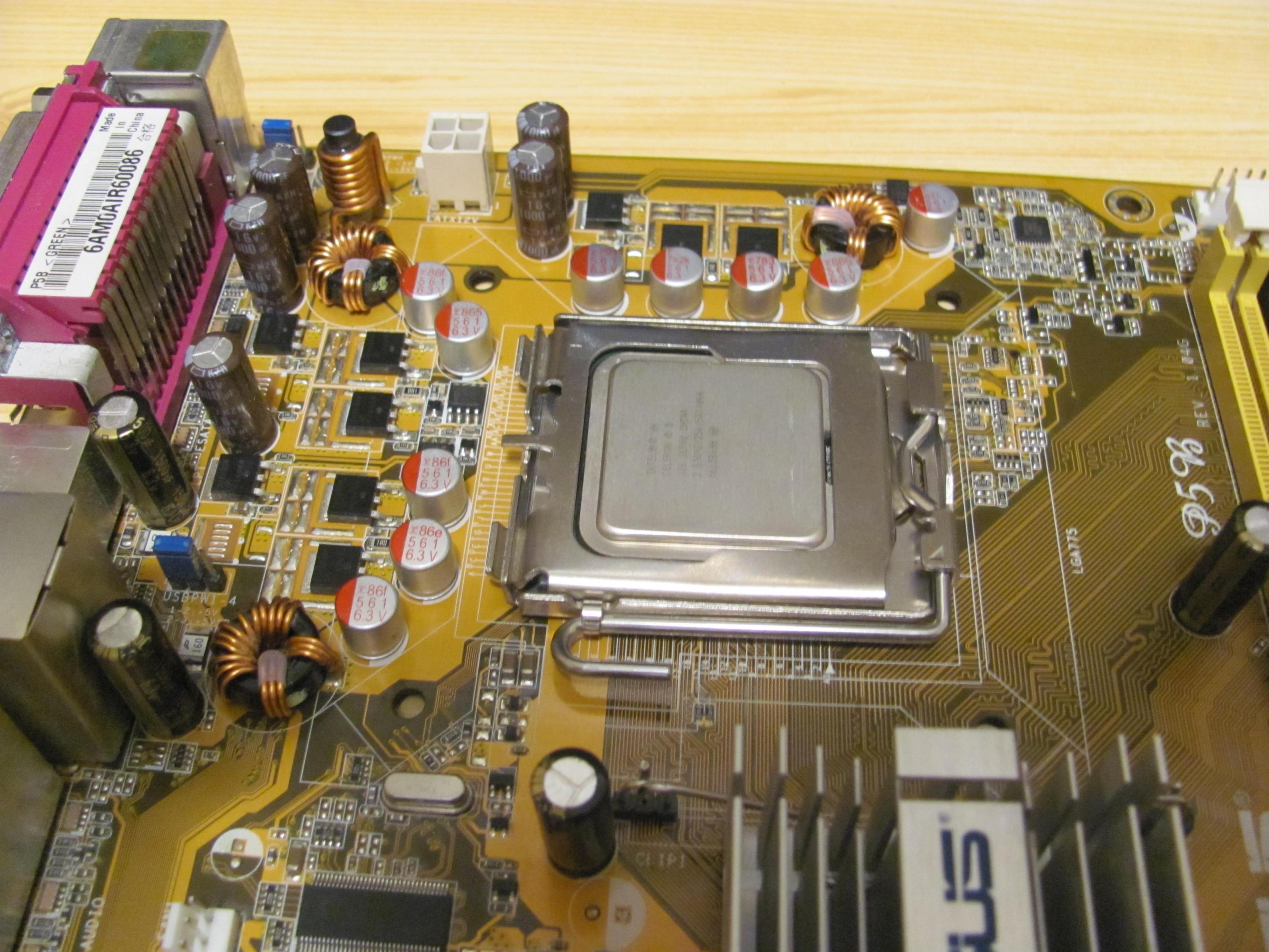

    If you have some higher-capacity polymers like 470+/16 than those, otherwise the low-ESR 1000/16.
    Toshin Kogyo I guess. Though japanese brand, not that good one. Yeah if the bridge runs hot may be a good idea to replace it as well. Guess you can use those Nichicon FP caps there.
    The blue Chemi-Cons are only safe to use for CPU Vcore as there is low voltage. Maybe RAM. But you'd have to measure which ones are the VRM output and which are the input (for RAM usually 3.3 V and for the bridges 5 V).

      I don't have any higher-capacity polymers. So I will probably buy 560uF polymers from you for the vrm output, filling the one unpopulated spot. Then I'll use yours KZH 1000uF 16V for vrm input, also filling the one unpopulated spot. And about the TK caps, I will replace the one near the southbridge with my FP cap and leave the rest. Do you think it would be OK like this?
      If so, how much would you want for the 10 560uF polymers and 5 KZH 1000/16?

            This thread confirms the positions for the missing caps, very similar board:
            https://www.badcaps.net/forum/showthread.php?t=57707

              I'm probably overlooking something, but I don't see how it confirms the positions. When looking at the pictures, that board is indeed similar, but the cap positions are different, there are less positions on that board.
              • Per Hansson
                • Jul 2005
                • 5895
                • Sweden
                Re: Asus P5B
                I meant this pic, but yea you are right, it's not as perfect match.
                But it does imply the high vs low side of the VRM as was mentioned earlier.
                Easy enough to confirm with a multimeter too of course

                  Yep you can usually beep it to ATX 12 V or on the other hand to some SMD ceramics under (or inside) the CPU socket. Than its pretty much obvious which is which.

                    I've replaced the caps and put a Xeon E5430 in. But I couldn't get it boot even on stock frequency, but could boot with FSB 266. After some experiments, I found out that the problem is with RAM.
                    But first I will give you some background about this PC. I got this PC from a friend for a very cheap price about 2 years ago. It was with Core 2 Duo E6400 and 1GB RAM. After I got it I bought 3 pieces of cheapest modules of 2GB 800MHz RAM (costing me more than the PC itself) on aukro (Czech equivalent of ebay), put it in and it was running fine until now when I decided to give it a little upgrade.
                    I tried to put some better RAM modules from another PC in and managed to boot on stock frequency, but only with ram clocked to 667MHz (they are 800MHz modules). Then I noticed that the RAM timings are set wrong. So I went to BIOS and tried to set them manually, but I couldn't. I have a problem with tRFC option, the highest value the BIOS allows me to set is 42, but I need to set it to 52.
                    So my thought was, maybe it would be possible to modify the BIOS to allow a higher tRFC setting. But I know nothing about BIOS modding. Or somehow make it to set the right timings automatically.
                    What I don't understand is, how it is possible that the PC was running fine with these RAMs for about 2 years and after replacing the CPU, it just doesn't want to work with them anymore.
