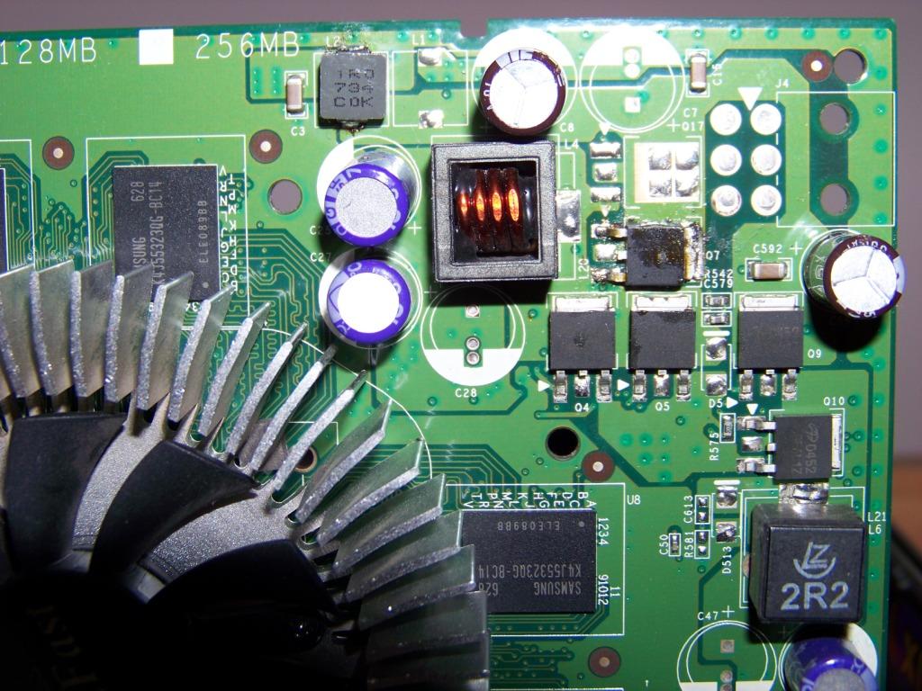

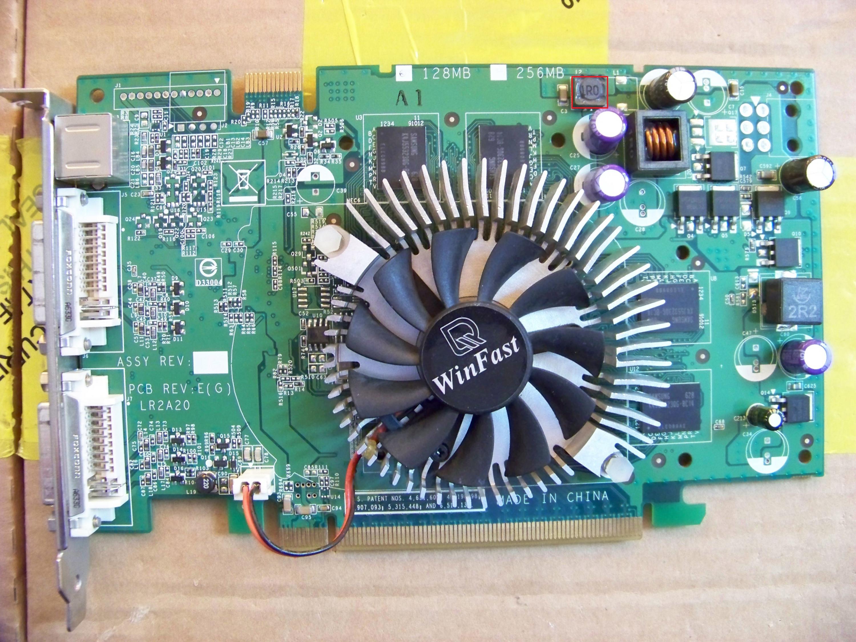

    In my absence, a computer at work succumbed and does not start because of a power failure (very often, in fact).
    To locate the problems I used a good PSU (beQuiet 400W), to eliminate from the start the power problems.
    All components have functioned less video card (!). At start, immediately heard a slight crack and got a thin thread of white smoke from the component framed in pictures.
    Now I'd like to know exactly what component is, if I can replace, where I could find an equivalent piece, etc, in order to recover the video card.
    Thank you.

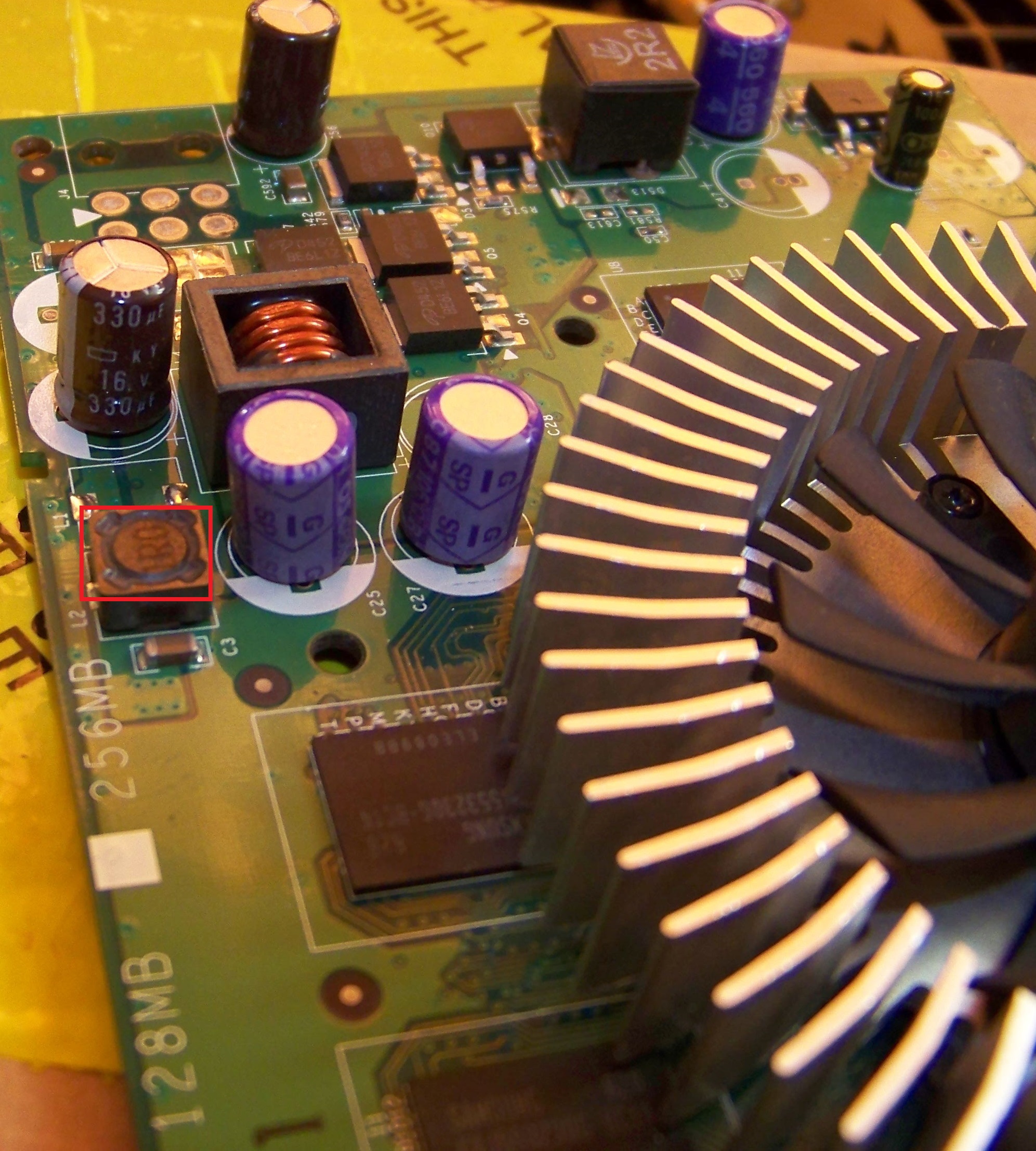

        Re: Leadtek PX 7300 GT coil blow?
        Originally posted by alindumitru46
        Ok, any chance to repair?
        Yes.
        The 1R0 on the inductor suggests 1 uH inductance. Also, it appears this inductor is connected to the 12V rail, which feeds the high side of the GPU and RAM VRMs. Given that GeForce 7300 and 7600 use very similar GPUs, they both have similar same maximum power requirements (most likely, the 7300 pulls a bit less). I know that a 7600 GT pulls around 50W max, so that means that this inductor on your card is probably rated for somewhere around 5-10 Amps.
        By far the easiest way to get a replacement inductor is to get one from another broken motherboard or video card. It just has to say "1R0" on top and appear to be the same or bigger in size. SMD or through-hole is unimportant if you don't care how the repaired card looks .
        And finally, if you can't find a replacement inductor, ONLY IN THIS SINGLE CASE, you can replace it with a solder bridge. Why? Because this inductor is connected to the 12V rail and is only used for reducing EMI and noise going back into the motherboard. (The other inductors on your video card are not, however, so do NOT ever try to replace those with a solder bridge - you will fry the GPU). If you do replace that inductor with a solder bridge, then I also highly recommend you install a cap in that empty cap spot marked "C7" (it's right next to that brown 16V 330uF KY cap). Use either a 16V or 25V cap. Capacitance can be anything between 220 uF and 1500 uF. The idea here is that if you remove the inductor and replace it with a solder bridge, then at least you'll have more capacitance to reduce some of that EMI noise from the GPU and RAM VRMs.
        Let us know how it goes or if you have more questions.
        **edit**
        I forgot to mention - that white smoke you saw was likely from the label behind the inductor on the other side or the inductor itself. Either way, no need to worry. Now, if you saw smoke coming from a chip, that's a different story. But I have a feeling this video card will work just fine again .
              I must test the mobo with another video card, because I think I damaged the PCI express port...
              Should be okay if the PSU detected the short-circuit and shut down. Otherwise, you will see either melted pins in the PCI-E connector or melted traces around it.
              Bad news... I replace the inductor with another with same value. But the vent start for 1 sec and stop only first boot.
              More than likely a shorted MOSFET. I had an AGP 7600 GS do that. Works fine after MOSFET replacement.
              The short MOSFET is what probably blew/killed the original inductor on your board.
              Check MOSFETS Q7, Q9, and Q14 for short-circuit (i.e. good continuity) between Source (S) and Drain (D), as well as Gate (G) and Drain. If they are okay, then check Q4, Q5, and Q10 for short-circuit between Gate and Drain only.
              Q4, Q5, and Q10 are all "low-side"-type MOSFETs (i.e. they are connected between GPU/RAM power rail and ground. Therefore, they may appear to be shorted between Source and Drain while on the board, but actually be okay when removed. This will vary for different GPUs. If they show a short-circuit or less than 20 Ohms resistance, then the only way to know for sure is to remove them from the board.
              To remove MOSFETs, you will need either two 60W (or greater) soldering irons OR hot air. I prefer the two irons method. It's very easy to remove the MOSFETs without damaging anything. Just apply a good amount of leaded (Pb) solder to all of their pins and tabs before trying to remove them. Also a good idea to write down the part number on the MOSFETs before removing them (in case they break). That way, you will know what replacement MOSFETs you need to get. The new MOSFETs need not be the exact same part number and specs... just compatible (I an help you find proper replacements if you choose to fix the video card.)
              Or let me know if you have given up on it.

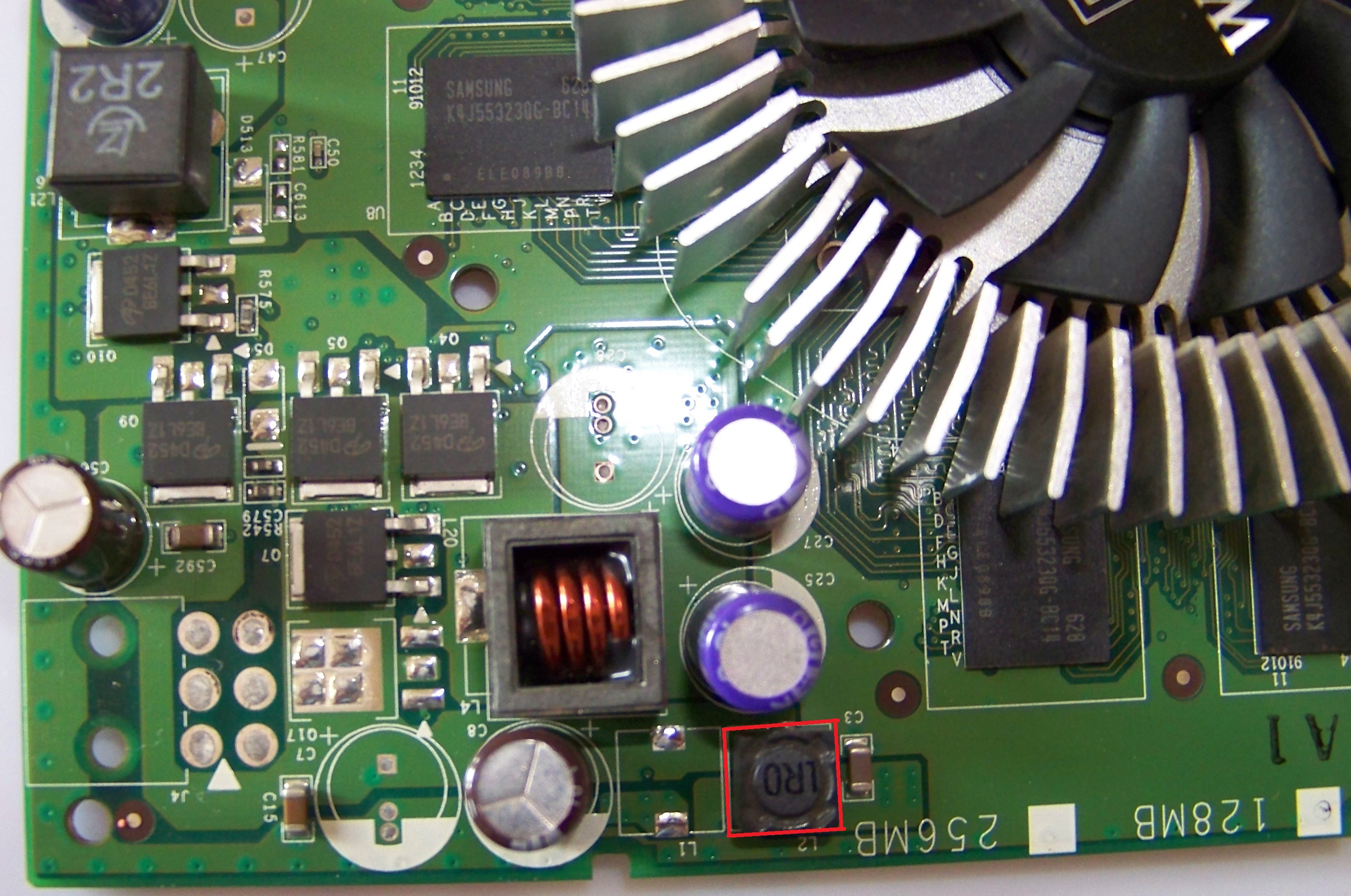

                  Q4, Q5 Q7 are shorted, Q10 looks good. I found https://www.badcaps.net/forum/showth...t=12260&page=2 , probably I must do step by step replacements/verifications.
                  I found 3 replacement MOSFETs for Alpha and Omega Semiconductor D452 BE6L1Z (looks in photos) : http://www.digikey.com/short/t9tqj0 or a chinese kit of "genuine" from aliexpress.com
                  The best option, please?
                  PS: Do not give up , contrary: either the show or the hospital!
                    master hoarder
                    • May 2008
                    • 12175
                    • Bulgaria
                    Q7 is bad!
                    It is an upper MOSFET, so if it shows short-circuit, it is very likely gone.
                    Q4 and Q5 must be tested again, but this time out of the video card.
                    Any of the three MOSFETs you posted should be okay, I think. The 497-13425-1-ND appears to have very close specs to the ones on your board. The IRLR8721TRPBFCT-ND seems to have better overall specs, though.
                                The single mosfet replaced is Q7, even if Q4 and Q5 had the same reaction to measurement like Q7. Is there a risk?
                                I dont have a good skill and my iron has only 60W, so this is my dirty job. Already has 4 days and 4-5 hours of daily running. I found a little high temp on the mosfets and the other side (slightly hot sensation when touch, so under 60 Celsius degrees).
