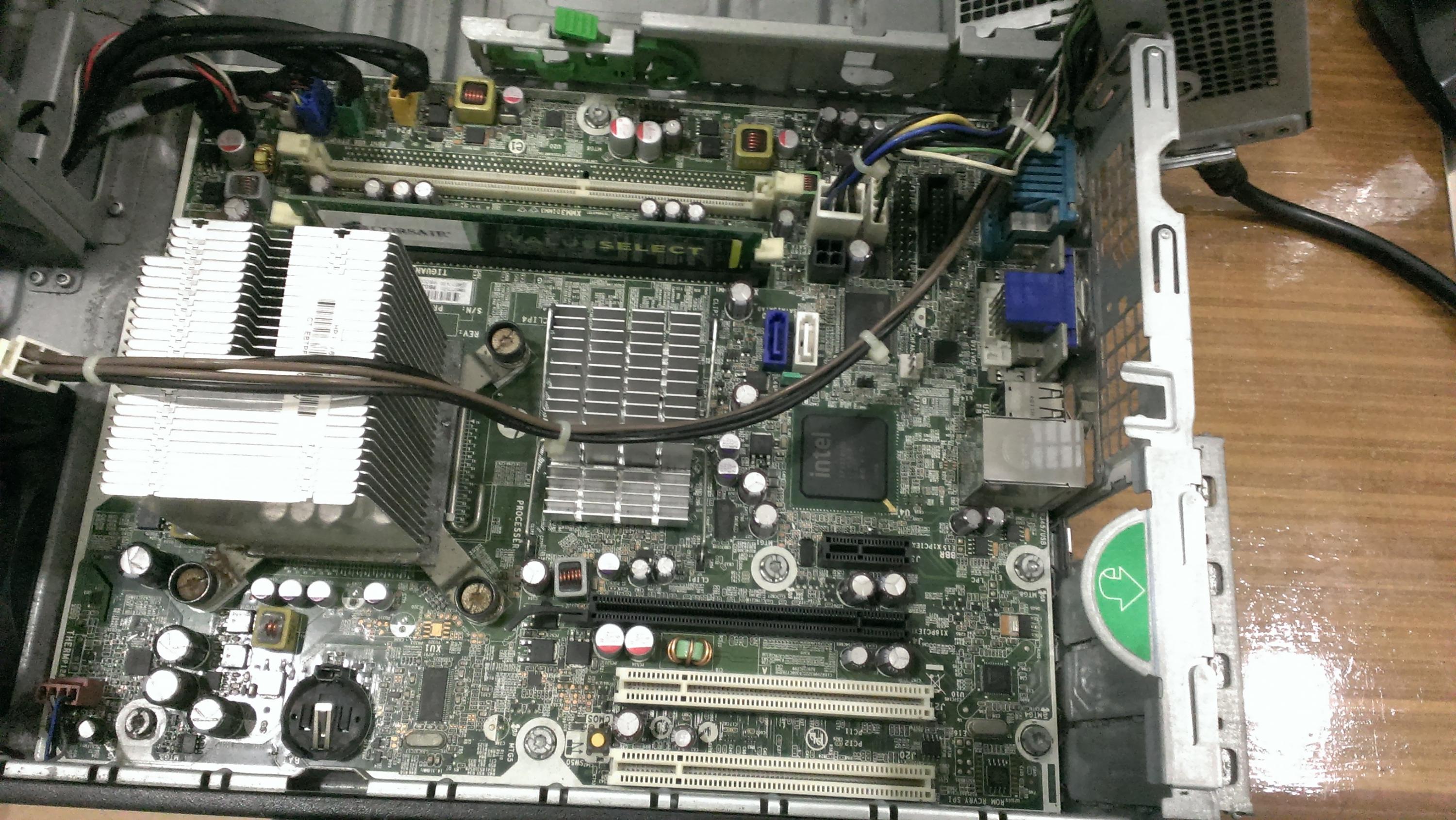

    Greetings people
    I got a HP Compaq 4000 Pro SFF desktop that won't power up (not to say it totally won't), bought it from a junker though. With or without RAM, diagnostic LED indication will blinked red for 2 times (1 blink for every second followed by 2 second pause), same as the beep code. It power up as soon as I switch on the mains, both CPU and PSU fan spins for just 1 or 2 seconds and stop spinning after that, and the beep and blink codes continues.
    I tested the CPU, RAM and HDD on other PC and it all works.
    Here a video to my blink code:
    https://www.youtube.com/watch?v=1pZD...ature=youtu.be

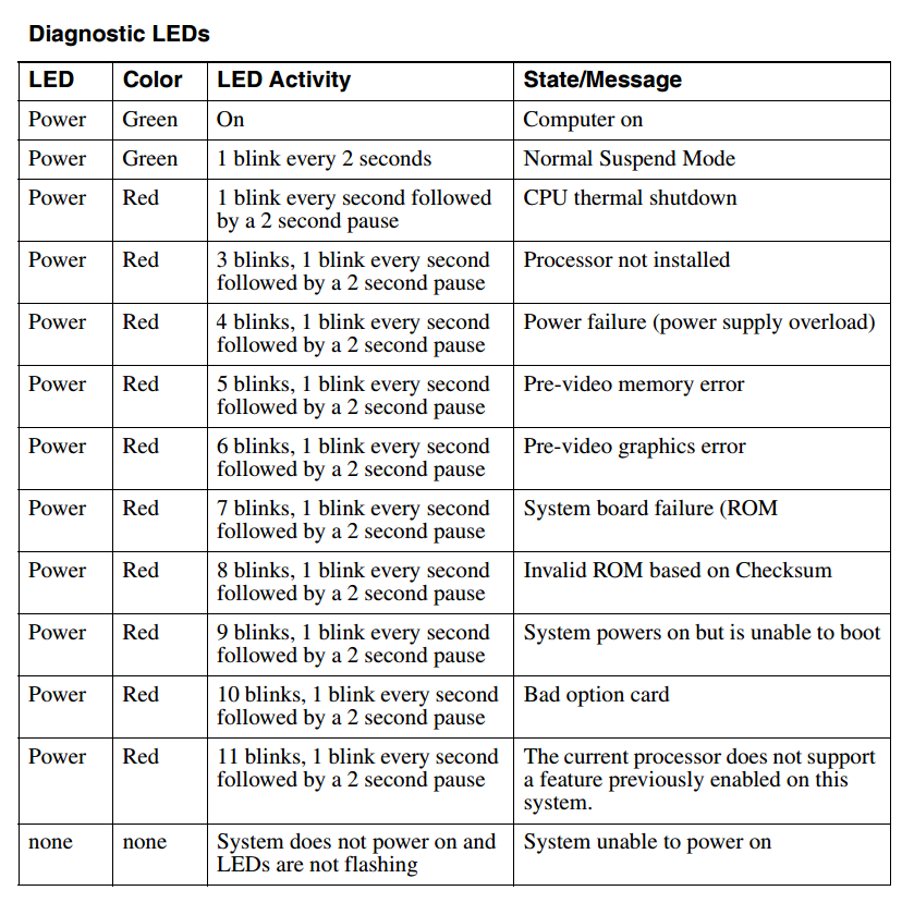

    I refer my blink code to HP's service manual and I don't find a match.
    But if I disconnect 4 pin CPU power connector, I get a different blink code, 4 blinks, 1 blink every second followed by a 2 second pause. And there a match, according to the service manual it is power failure, power supply overload.
    This was a proprietary HP PSU, with 6 pin, another smaller 6 pin and 4 pin CPU power connector. I jumped started the PSU by shorting green to black wire, the PSU does power up and the fan is running at full speed. Wasn't sure if this is how it behaves though, I have non of a experience dealing with HP SFF system.
    In this board have some KZGs though, wasn't sure they are bad, they all looks good, no bungs, leaks or bloat.
    Can anyone please share with me with any experience with HP SSF system? And help identify the unknown blink code that is not listed in the documentation. Any help is appreciated

    maybe there is a short on one of the power lines.

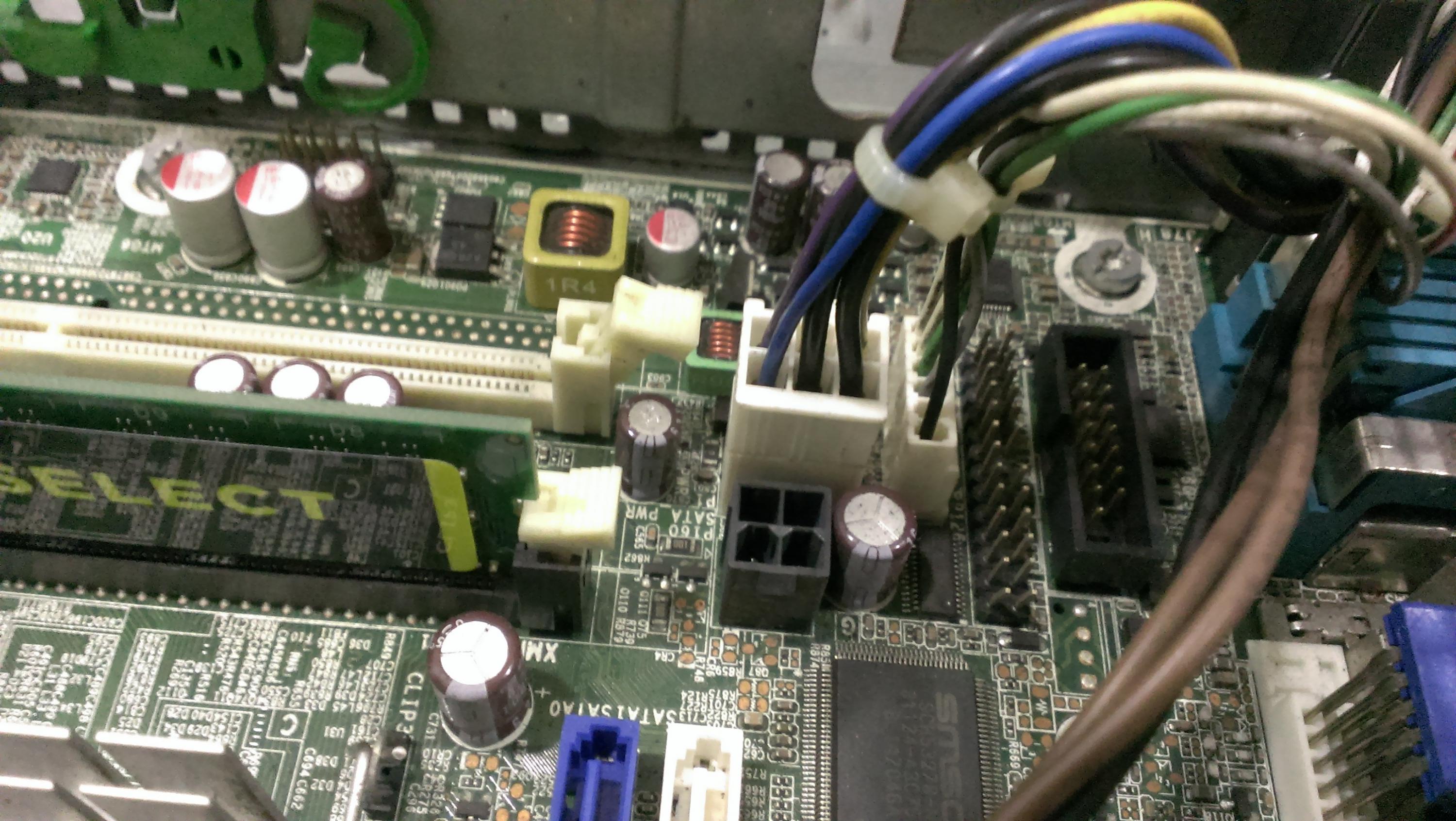

      Was there a fan for the processor heatsink? you might need to connect a fan to one of the headers on the motherboard before it will power on.
      Also you need to connect the P4 connector, googling image search shows for the 4000 that it is connected, and went away on 6xxx and 8xxx series.

        Yup, there is, it has a air duct, I removed it to snap some pics, similar to dell BTX design.

          If I had to guess based on other information, like this
          http://h20564.www2.hp.com/hpsc/doc/p...ts.oid=3658084
          and this
          http://h20564.www2.hp.com/hpsc/doc/p...r_na-c00274415
          and here
          http://h20564.www2.hp.com/hpsc/doc/p...mmr_kc-0100459
          It's a recurring theme.
          I would say either the cpu fan is not sending a PWM signal to the board and the board is going into protection mode to prevent damage or someone has flash the wrong bios on to that board.
          It's unusual especially on a business class workstation to have undocumented diagnostic code, unless hp compaq add it to a bios update after release.

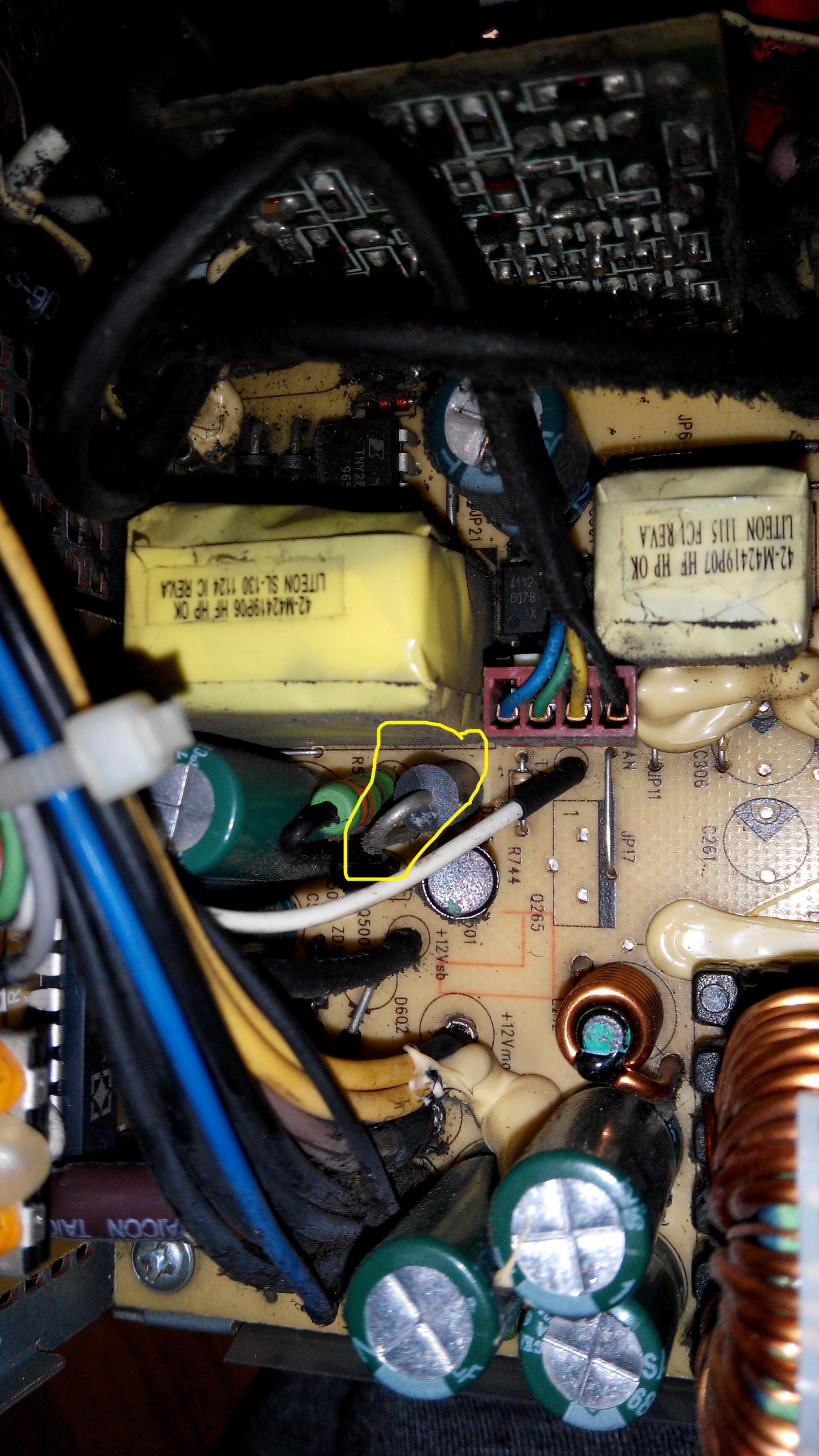

                          I open the PSU and do some simple test using DMM today, and I found a diode seems to be bad, tested using diode mode on my DMM, on forward voltage i got 0.318V, but when tested in reverse, I got a reading that rise from 0v until it says OL. It was tested in circuit though.
                            • 30919
                            Re: HP Compaq 4000 Pro &lt;HELP&gt;
                            that reading is probably o.k., your seeing a capacitor discharge.

                              U were right, I removed the diode off circuit for testing and it is working as it should.

                                Recap the power supply. It's full of crapxons, teapos, and ltecs.
                                Those systems acted real strange once the caps started going- you then had the MB caps attempting what the ones in the PS should've been doing.
                                You may have to recap the MB anyway, if it's got KZGs/KZJs...

                                  Okay, I will desolder a couple caps off the PSU and do capacitance measurement and see how it goes
