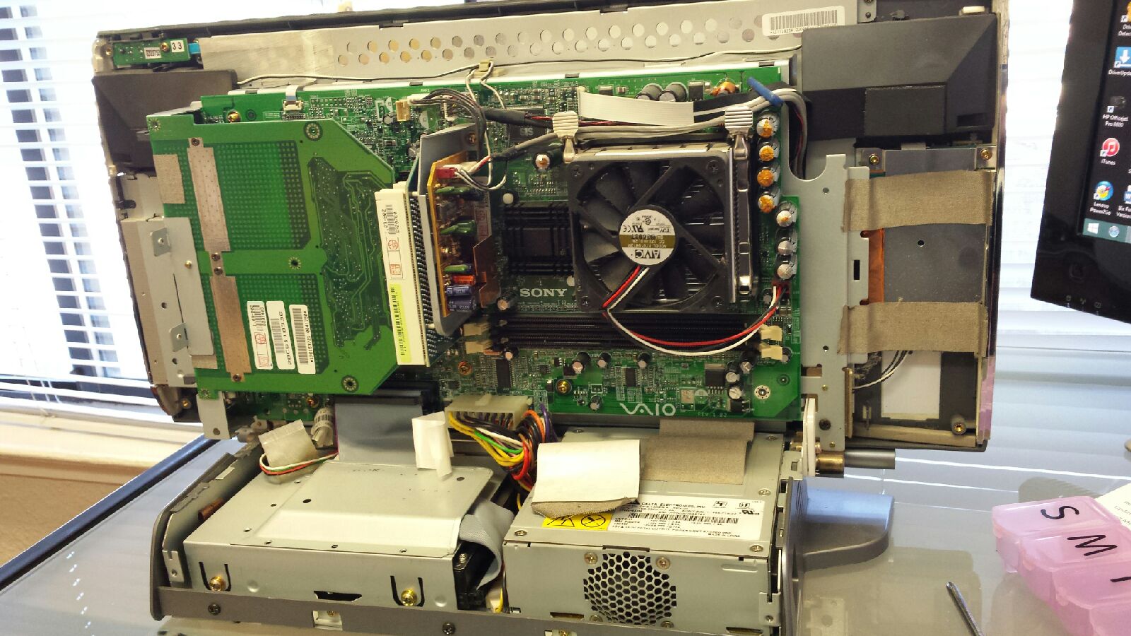

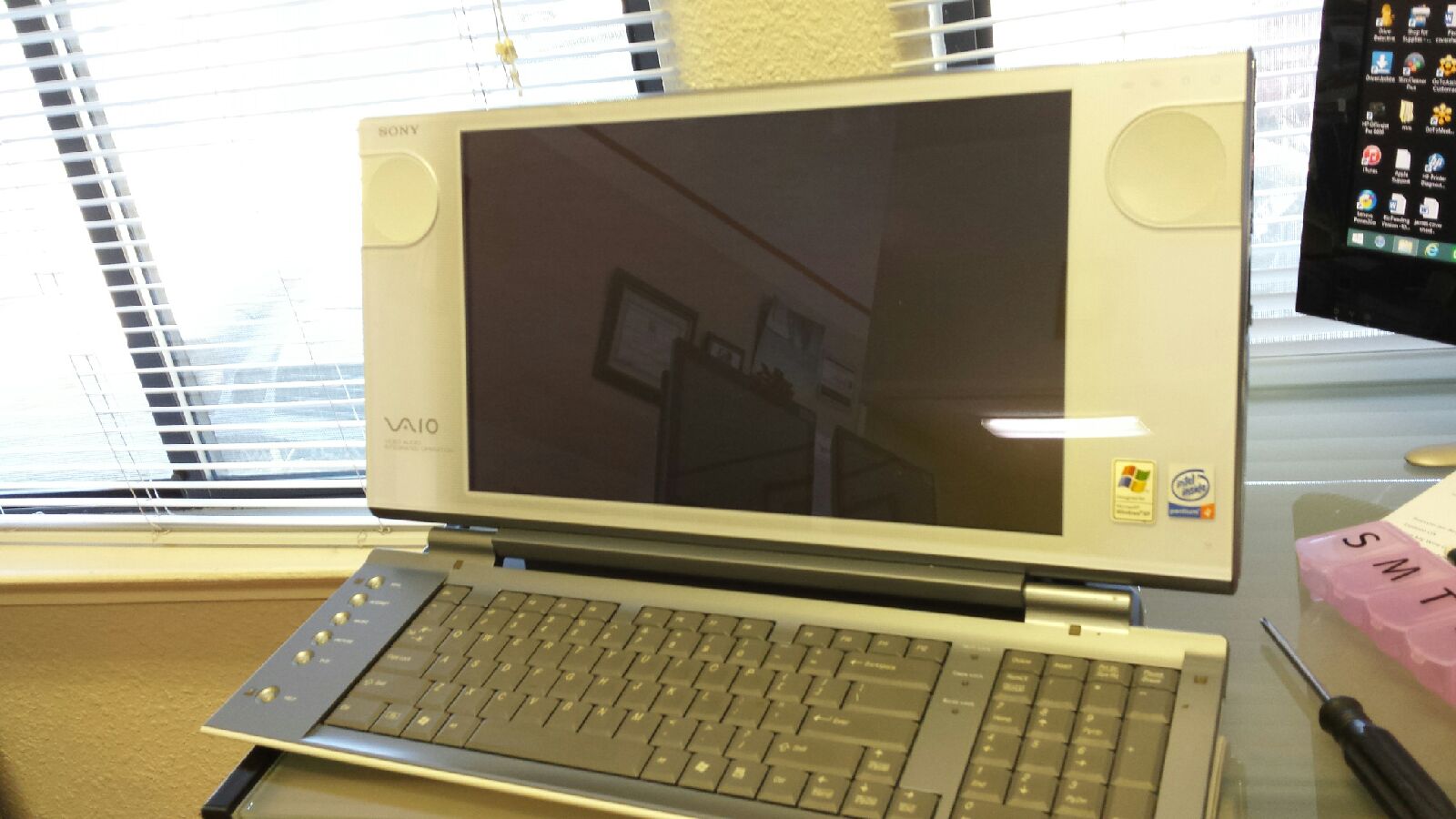

    Sony VAIO PCV-W20
    This system actually boots, but has problems crashing for obvious reasons. I'm going to do a poly mod on this thing, and refresh the PSU, even if it looks fine.
    Something I'm curious about is the possibility of upgrades. There is no info on upgrading the CPU, which is a 1.8 Northwood, I guess. The RAM has been maxed at 1GB. And that is a point of contention for me--I really need to see if it will boot long enough to run CPU-Z because I can't find any SiS chipset (which this has AFAIK) that would limit it to 1GB as well as PC2100.

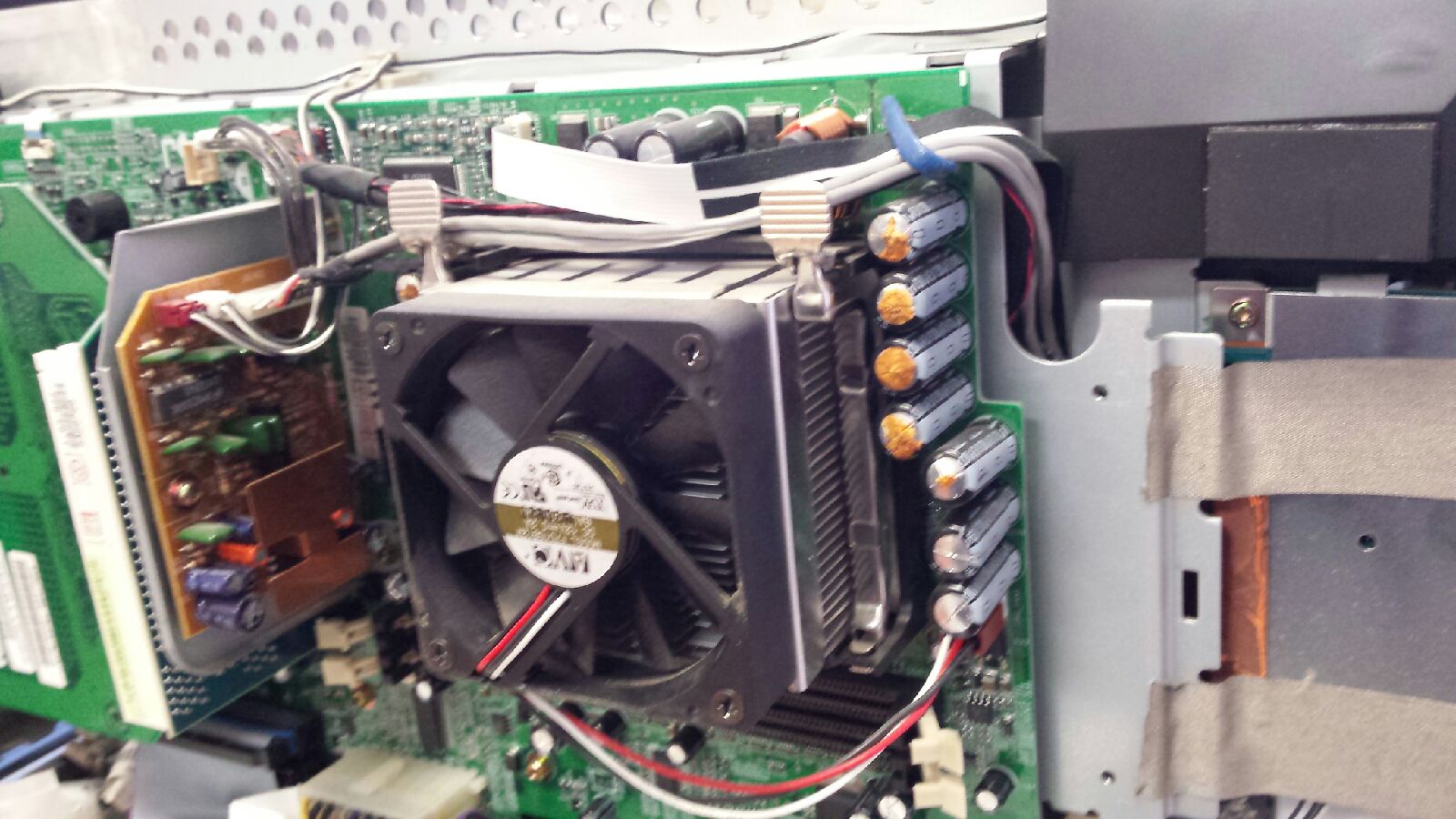

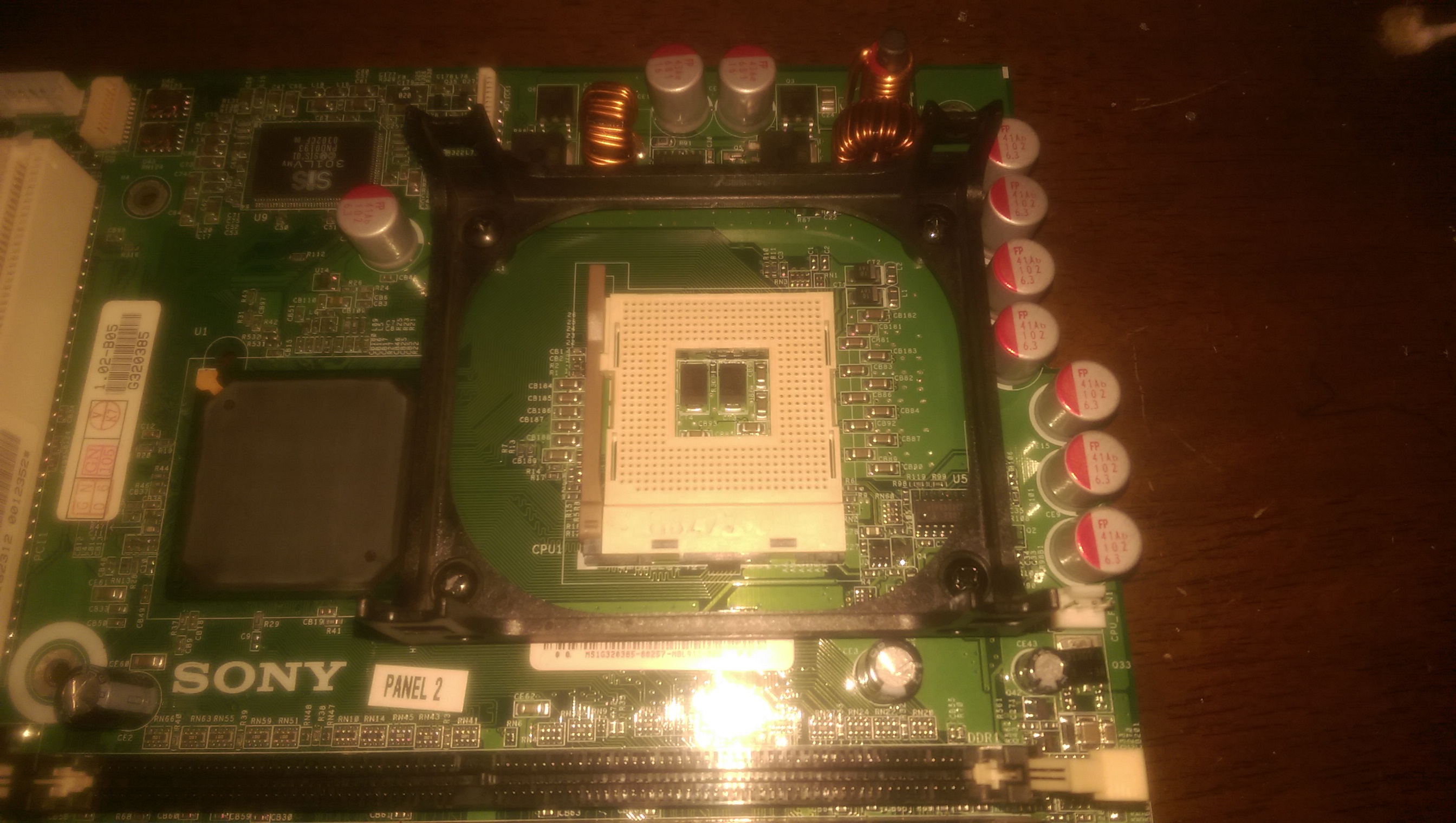

          Well, here's the board with polys in the VRM stage, and a couple up north that are on the 12V rail, I assume because they were 16V. I decided not to poly the entire board because I wasn't sure how the PSU would react.
          Only thing about the PSU that worried me was on the secondary side where all the outputs are, there was a 470uF 25V cap, and I ordered a 16V. I think I did this once, in the past, and everyone said not to worry, just one of those situations where the bean-couenters realized they could get this particular 25V cap for less OR it met a spec they couldn't accomplish with the 16V.

            Well everything is up and running. I left out the modem and pcmcia board as I'll never use either, and I bypassed the 470uF output capacitors on the internal amp with small films since it was right there.
            My cousin put XP SP2 on it, but I'm considering throwing SP3 or even 7 on it. Perhapps a light Linux distro would be ideal.
