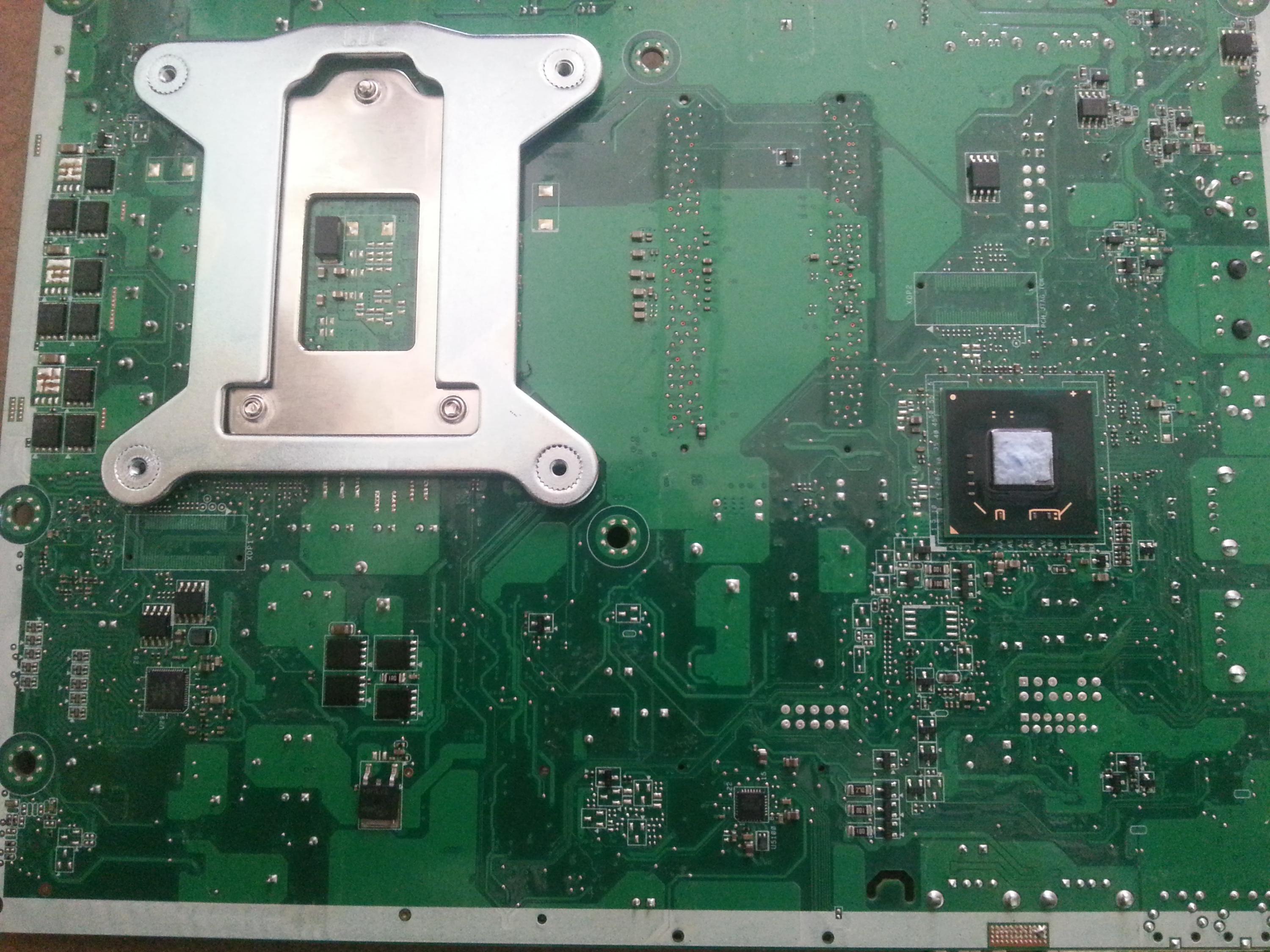

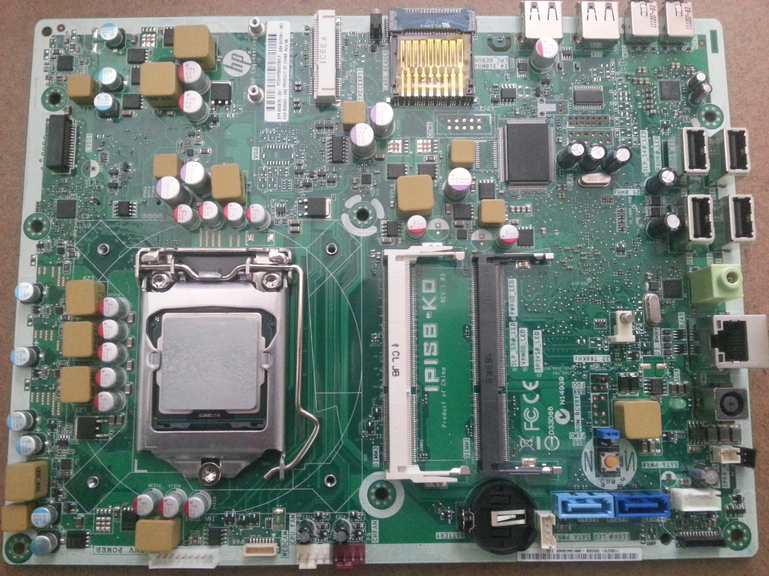

    Hello folks I greet you all I need help and I know it's only here i can get it from kindly help me.
    I have this Hp compaq 8200 All in One desktop computer which if I plug in the AC adapter it will beeps and the machine won't turn on. Please help me fixed this i really need your help. Thankx once again

      never mind open the screen and take the board out!
      we need board model high res pictures and go on HP and see what is those beeps means.

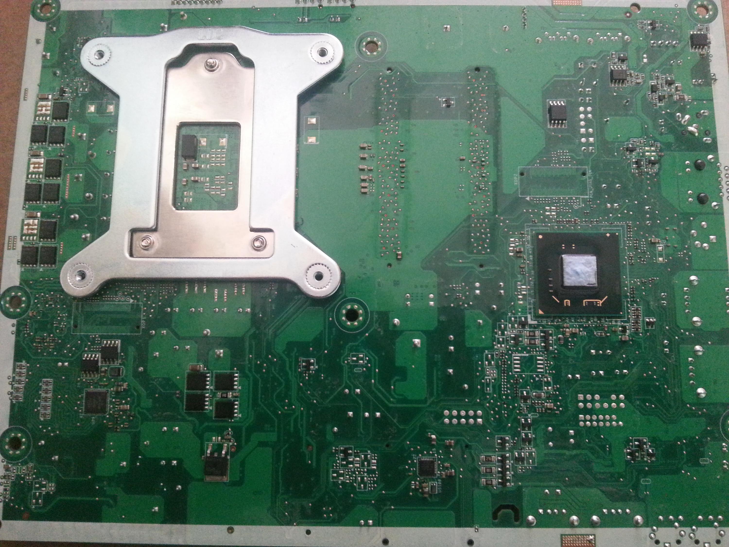

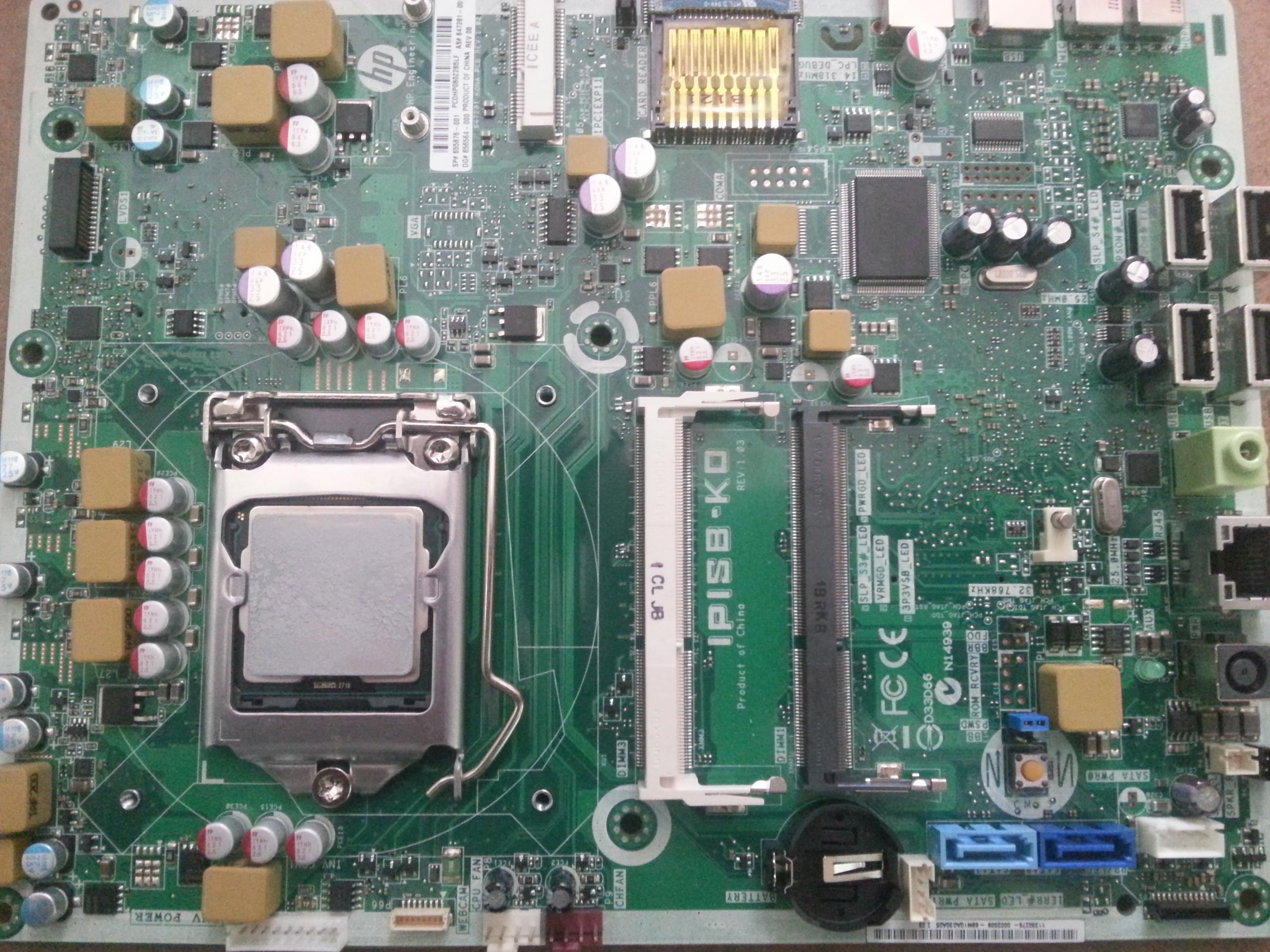

        dj_ricoh I hear you this are the picture of it.........

            how many beeps you hear?
            long and short - gategory

              Re: Hp compaq 8200 All in one Desktop beeps
              When I plug the power Adapter then it will start, then the power light change to orange and it will be blinking. then it will start the beeping for so long until i off it........
                listen closely !
                there is a pattern short long or with a pause
                  Yes with a pause.....
                    ok!
                    how many beeps before next pause.
                    like beep beep beep ...beep beep beep ...beep beep beep
                      Yes same same......

                        ok now
                        long or short?
                        3 beeps long or short?
                          3 long beeps.....
                            ok!
                            3 beeps Blinks red 3 times - Processor not installed. Install or reseat CPU.
                            if the pins are ok then you need to change the CPU!
