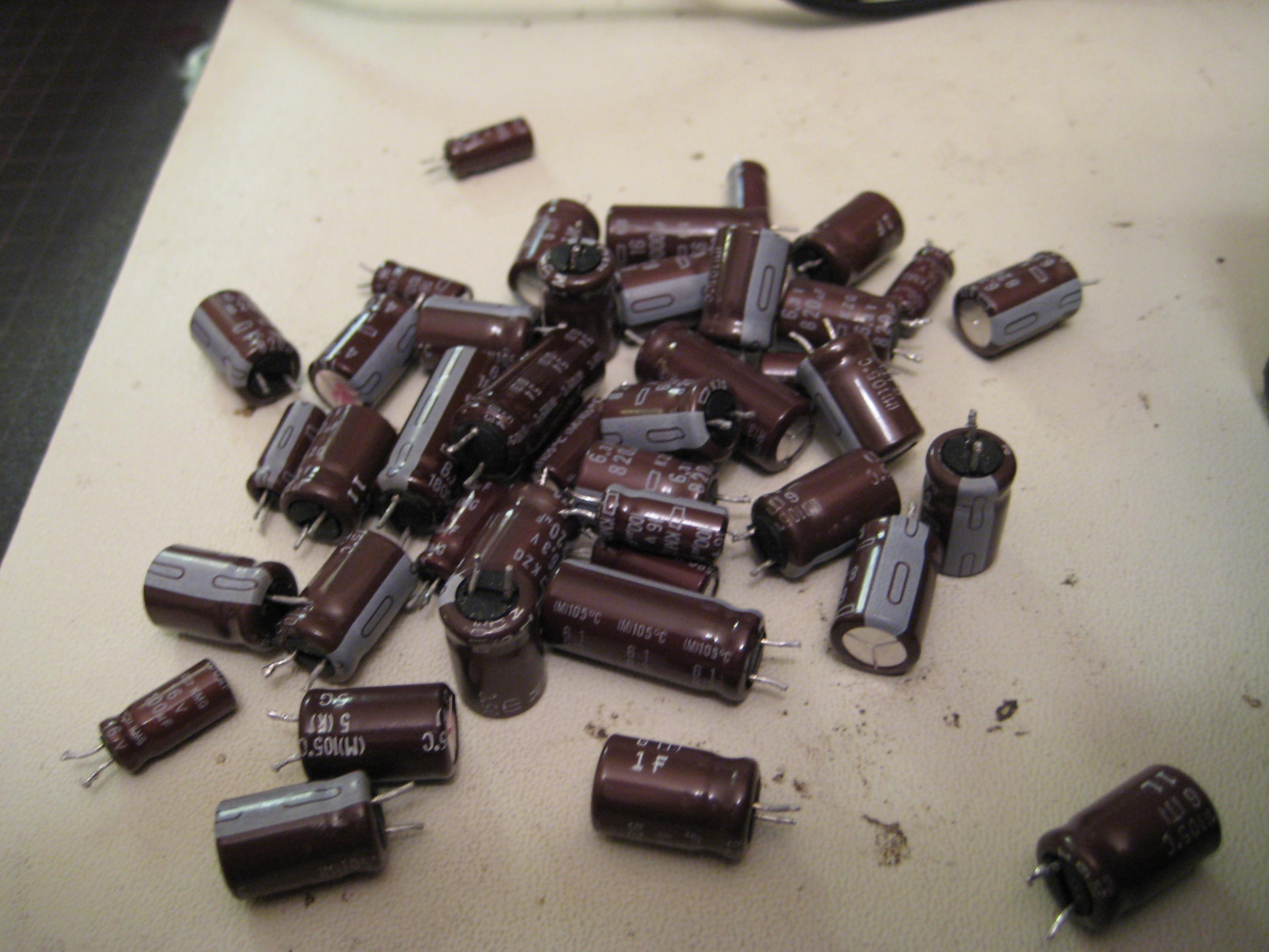

                Well I'm currently replacing the caps on the ASUS A8N32-SLI Deluxe board, I've got all replacements and taking my time.
                While looking at this Biostar Tforce 6100-939 board I noticed it has KZG caps on it as well. This board works fine but wondering if anyone thinks it's a good candidate for a recap too? Again this is not an important mobo, so may not be that neccessary?
                I noticed where the Asus board used a lot of 820uf/6.3V, the Biostar 6100-939 used 1000uf/6.3V. Would that size difference make a difference in the KZG lifespan?

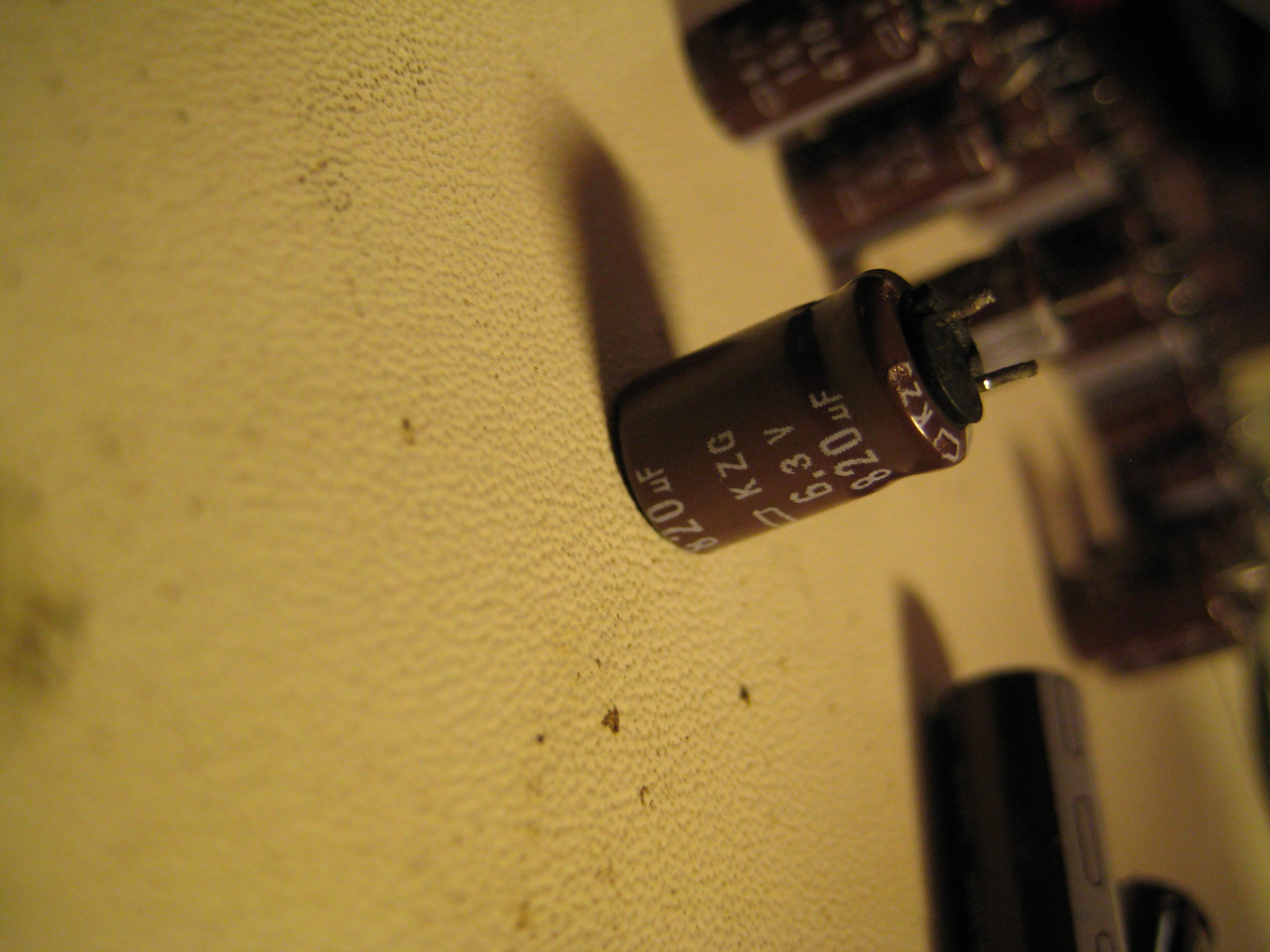

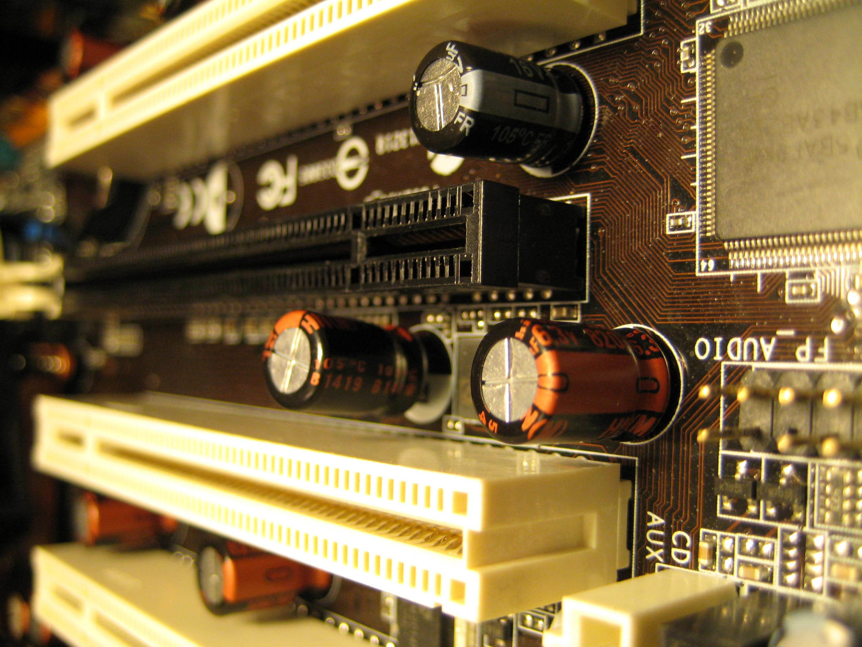

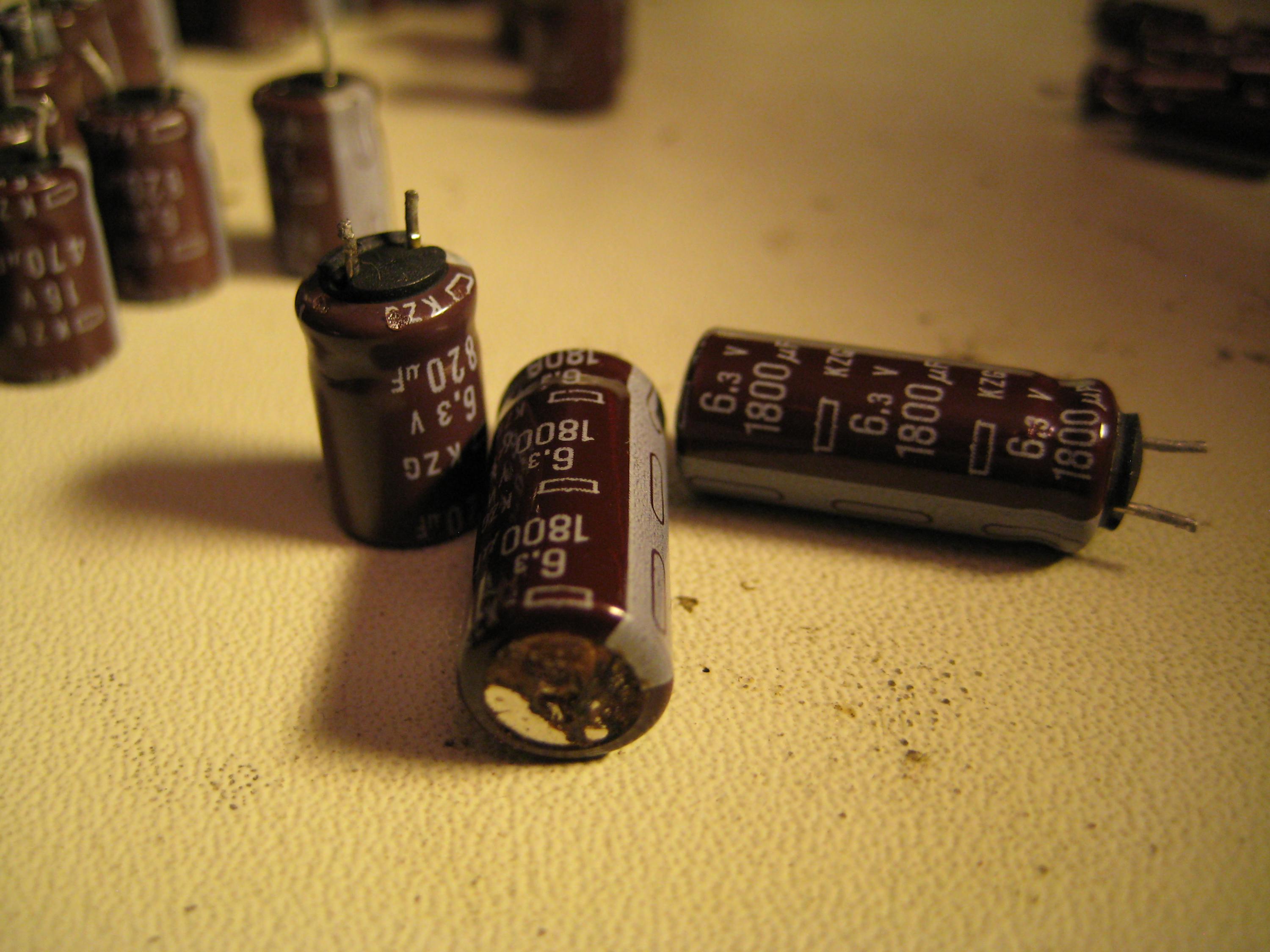

                    I finished the recap on my Asus board and it wen't very well....only one injury to my finger...I was holding something and slipped and my fingertip touched the iron!....ouch
                    One odd quirky thing that I came across and I have no idea what was going on there...???
                    One 820uf/6.3V cap located between the PCIEX16_2 (black) card slot and the PCI_2 (white) card slot was installed with the "negative" side of the cap going to the white silkscreen locater. The white half silkscreen indicates the "positive" side of all the caps on this board!
                    When I removed it I noticed it was reversed and the rubber base seal was bulged and pooched out!
                    No way anyone would have noticed that!
                    It was the only cap on the entire board reversed that way!!!!!!
                    Every other cap on that board had "positive" going to the white silkscreen pad.
                    So I was really weirded out by that and couldn't figure out for sure if that was installed at the factory that way incorrectly or it was some bodge revision or what!!?!? I even tried to figure out the trace path to confirm it was wrong but to no avail I just couldn't really decide. I did manage to get continuity from the negative side of an adjacent cap, but was really unsure.
                    I decided to install the new cap the right way like all the others (positive to the white silkscreen). I left it a little high on the board temporarily so if it did blow I could easily get it back out (just in case)....so far all seems fine and the board booted up and has been running perfectly....
                    My only conclusion so far is it must have been installed incorrectly at the factory and that would explain the blown base seal. The funny thing is I had never used that second PCIEX16_2 slot because I had never installed a dual SLI graphic card setup. Always used one card in the PCIEX16_1 slot.
                    So that reversed cap if it was part of that card slot circuit may have never shown any indication or glitch and it just went undiscovered all these years...who knows???
                    Anyway maybe I'll try that slot now as a test and move my graphic card (7600GT) there and see if it all works right...
                    Attached are some photos of the removed KZG's and the location of the new "perched" replacement installed with the positive to the white silkscreen like everyone else!.
                    If anyone knows anything about that little quirk or some explanation please let me know so I can go ahead and push it back down onto the board securely and call that cap good to go........
                    So far so good with it working....not sure if there is something I can do to really confidence test this thing out fully....maybe someone has some tests they could recommend....

                      Re: Replace caps on ASUS A8N32-SLI Deluxe?
                      Asus has the habit of having the capacitor silkscreen backwards from every other manufacturer. Normally the white half marks the negative terminal, on Asus boards it is positive, and they have a tiny + symbol next to it (which if you're used to other boards you're definitely going to miss and solder the caps in reverse). It's happened to every tech at least once.
                      Looks like they got bit by their own backwards choice there. Yes it is very well possible that it was like that from the factory, mistakes happen.

                        Yes, I was careful to check that white half was positive on Asus boards (unconventional).
                        Each time I removed a cap I double checked....that's why this one stood out!
                        I did install my graphic card in that second PCIEx16 slot.....and no go on boot up!....repetitive beeps, no video? long beep 3 short beeps which is a video issue.
                        I don't think I had ever tried that slot before either so now I don't know what to think.
                        The Asus manual says either slot can be used either or both but I will check the BIOS to see if there might be a setting amiss for that slot?? (PS..checked for a setting and nothing there)
                        The cap even though the base had popped out still read ~780uf on my meter....but then the 1800uf that obviously leaked out the top and had the base seal fail and they still read ~1380uf on the meter!?!?....so who knows?!
                        I don't even know if that cap has anything to do with the PCIEx16 slot #2 problem or not?....or it was just coincidence and this is a completely separate problem..
                        Any suggestions?.....should I try putting that cap back in the reversed direction like I found it and try the graphic card again?
                        I could just leave it as is?
                        I don't need that second PCIe slot but after testing and getting everything on this board working 100% this is the only snag/failure...

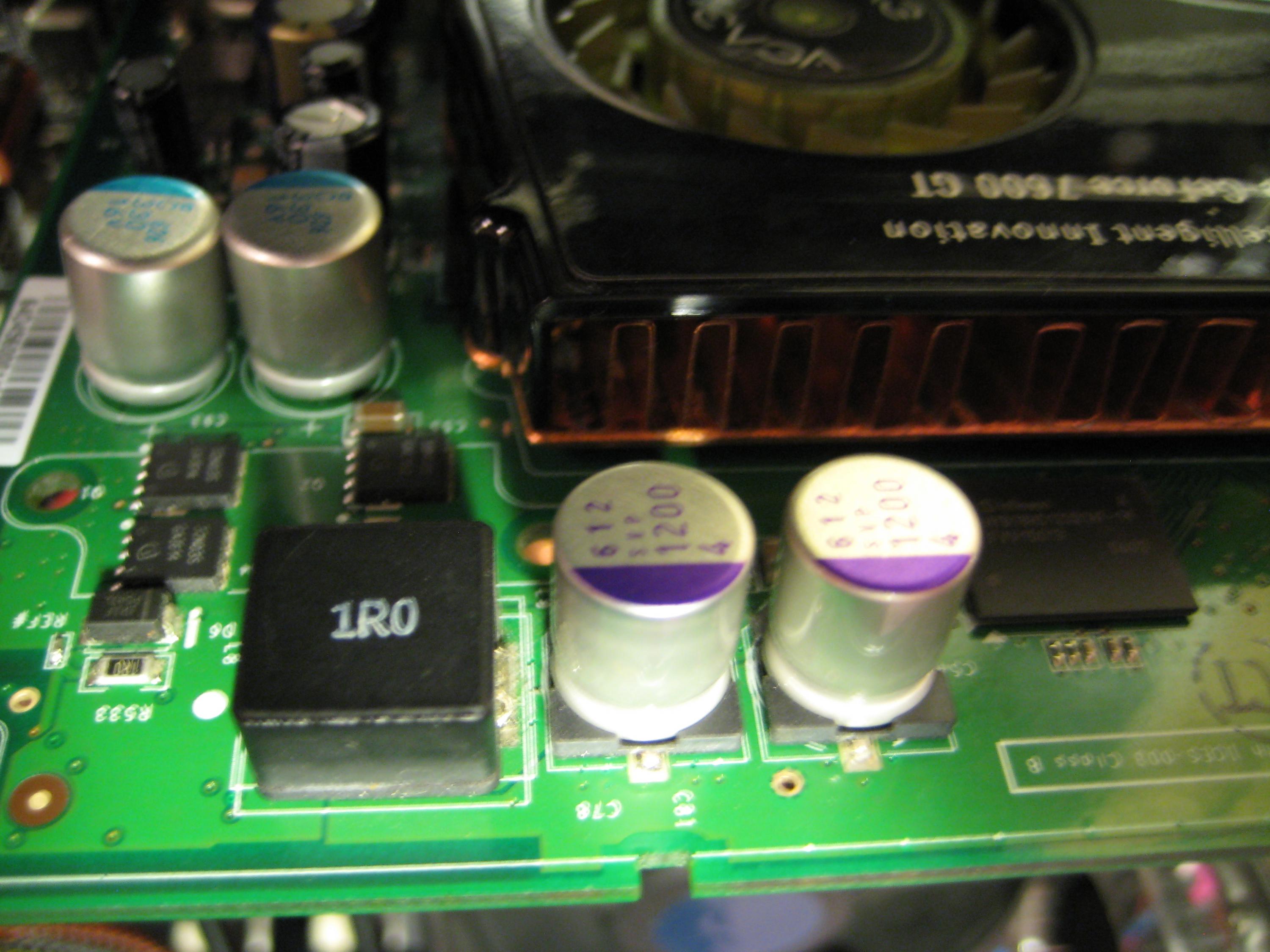

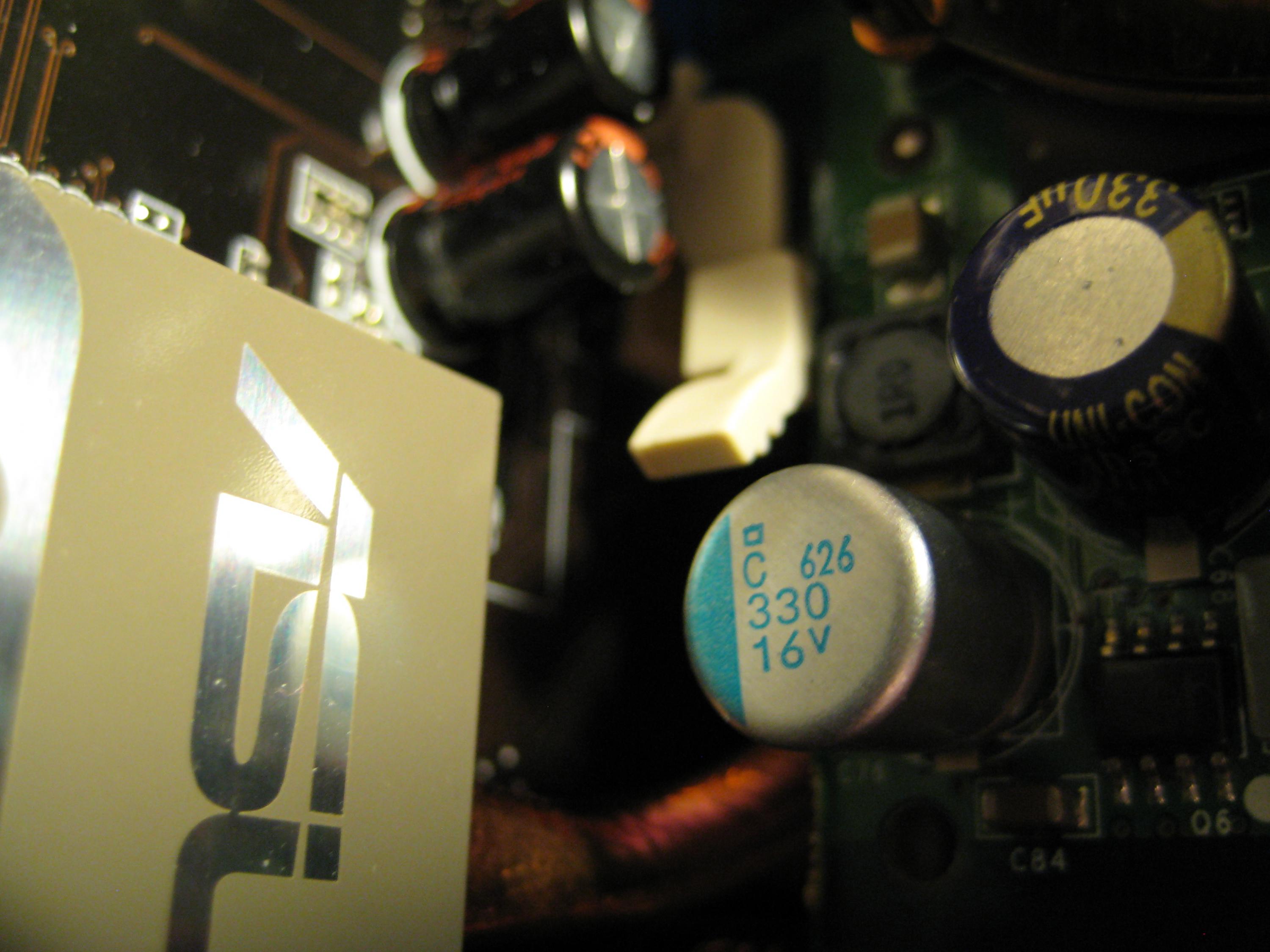

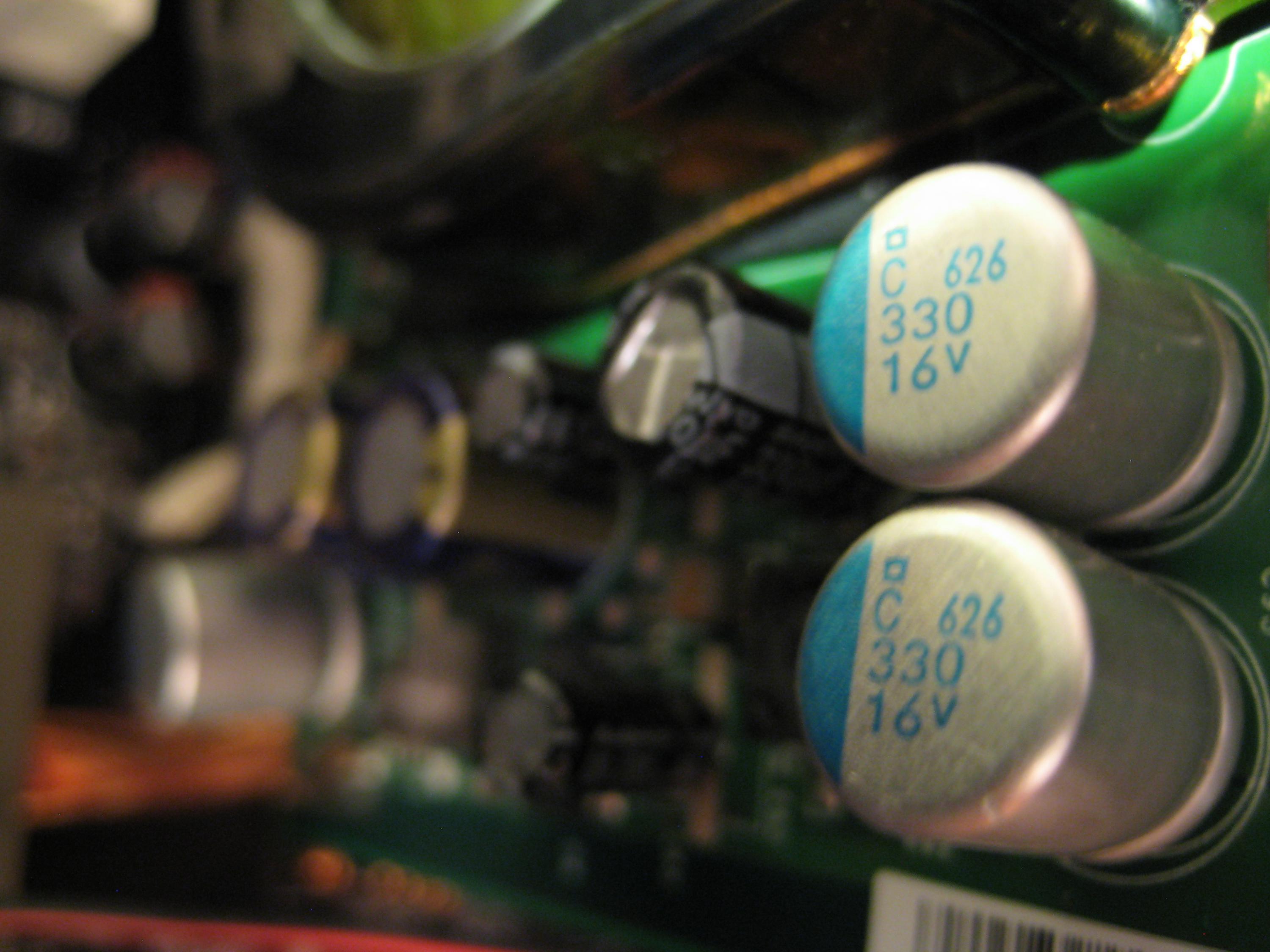

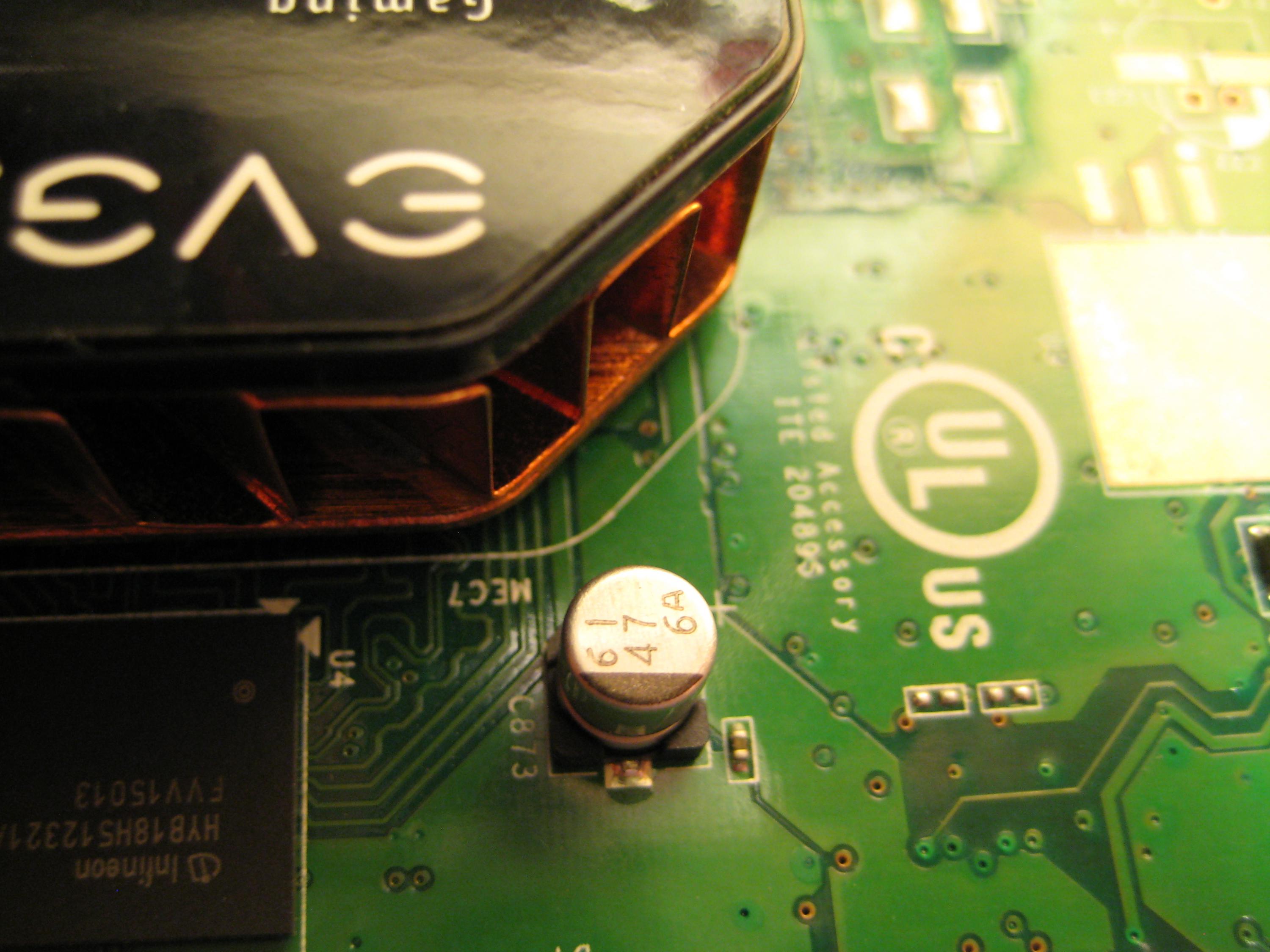

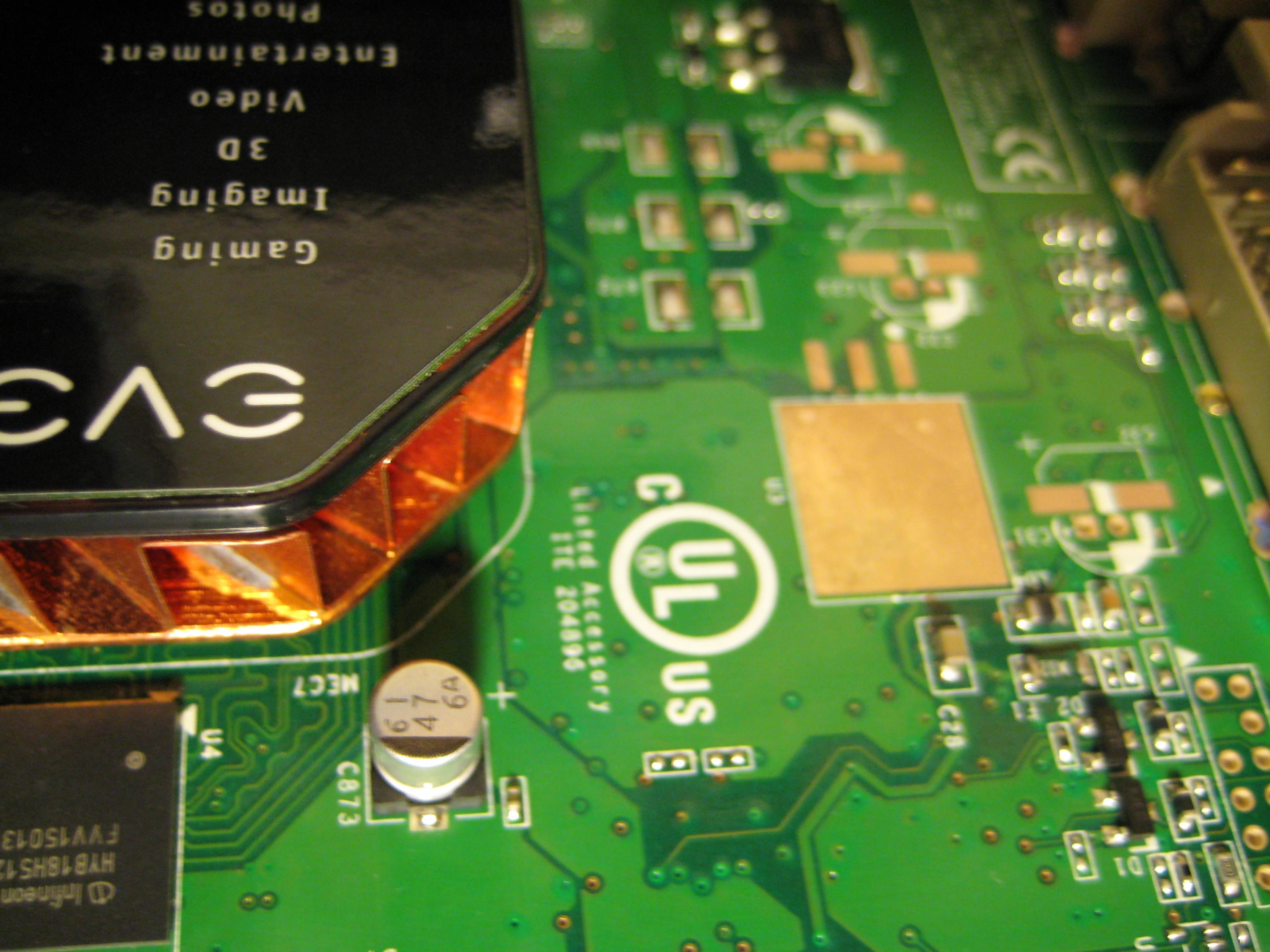

                              Well this is an original EVGA GeForce 7600GT card that I used with this Asus A8N32-SLI board and it has been working fine (both DVI outputs work).
                              Maybe you can identify the caps from my photos. I saw Sanyo on one of the electrolytics and Uni-Con but no "FZ's" that I can see. There is a mix of silver metallic cap (polymers??) and some typical aluminum electrolytic's.
                              Electrolytics:
                              (2) blue/gold Uni-Con's 330uf 16V
                              (1) black/silver Sanyo's 330uf 16V
                              (2) Rubycon 100uf 10V
                              Polymers?
                              (3) silver/blue top C 626 330 16V I'm assuming that is 330uf 16V
                              (2) silver/purple top 612 SVP 1200 4 Not sure what these are??
                              (1) silver/black little one 61 47 6a not sure what this is??
                              • Th3_uN1Qu3
                                Believe in
                                • Jul 2010
                                • 6031
                                • Romania
                                #35
                                The caps on your GPU are good. Those "Uni-Con" caps look a bit dodgy but everything else is good quality.

                                  Could I replace all of them with the same series like Panasonic FR or Nichicon HZ, HN etc.
                                  Also can you tell me how to read these polymer cap codes?
                                  The ones with C 626 330 16V I'm guessing these are 330uf 16V, but what does the C and 626 indicate?
                                  The silver/purple ones 612 SVP 1200 4.....is that 1200uf 4V?
                                  What does the 612 and SVP mean?
                                  And the little lone one 61 47 6a....is that 47uf 6V or 6.3V?
                                  What does the 61 and the 6a mean?
                                  Thanks for the help and all the info!
                                    Originally posted by djmukilteo
                                    Any idea why they used 3 different manufacturers in those locations?
                                    Cheapness.
                                    The Uni-Cons are the same value as the one Sanyo and then the Rubyicons?
                                    The location where the inferior caps (Uni-Con) are placed, is likely less critical than the others. So they decided they can cheap out on the caps there and still ensure a reasonably long life of the card. It seems like they did it right (this time).
                                    Most likely yes.
                                    Yes, 1200 4 stands for 1200uF 4v, and the other one is likely 47uF 6.3v. Either way, from 6v to 6.3v there is a very small difference, it doesn't matter which is which. Either are going to be used for 5v or under anyway.
                                    The other numbers and letters represent manufacturing datecode or lot #s. These are specific to each manufacturer.
                                    There is also another type of code like on SMD caps where you would have for example 821 2.5, that would stand for 820uF 2.5v. Quite common on LGA775 motherboards.
                                        There really isn't much in the way of a "standard convention" the way polymers are labeled. *Usually* it is:
                                        line1: date code or series (or both)
                                        line2: capacitance
                                        line3: voltage or voltage code (sometimes the voltage code can be weird with numbers and letters
                                        That's correct, they are 330 uF 16V indeed. The C in this case means these are made by United Chemicon, and they are their PSC series. You can tell it is United Chemicon by that little tiny square above the C (and while we are on that topic, I should mention that Nichicon uses a small elipse with arrows for their sleevless caps). Some other popular series they have is PSA, PSE, and probably a whole lot more that I can't remember right now.
                                        612 is probably some date code (made in 2006, week or month 12 possibly?)
                                        SVP is the series. I think those belong to Sanyo capacitors.
                                        Probably 6.3V and 47 uF. I don't think 6V caps even exist. Not sure what the 61 means. Could be a date code or something else. On motherboard and graphics cards, when I get to caps below 100 uF, I usually don't bother paying too much attention to them (except for the audio output, where I sometimes up them to 220 uF).
