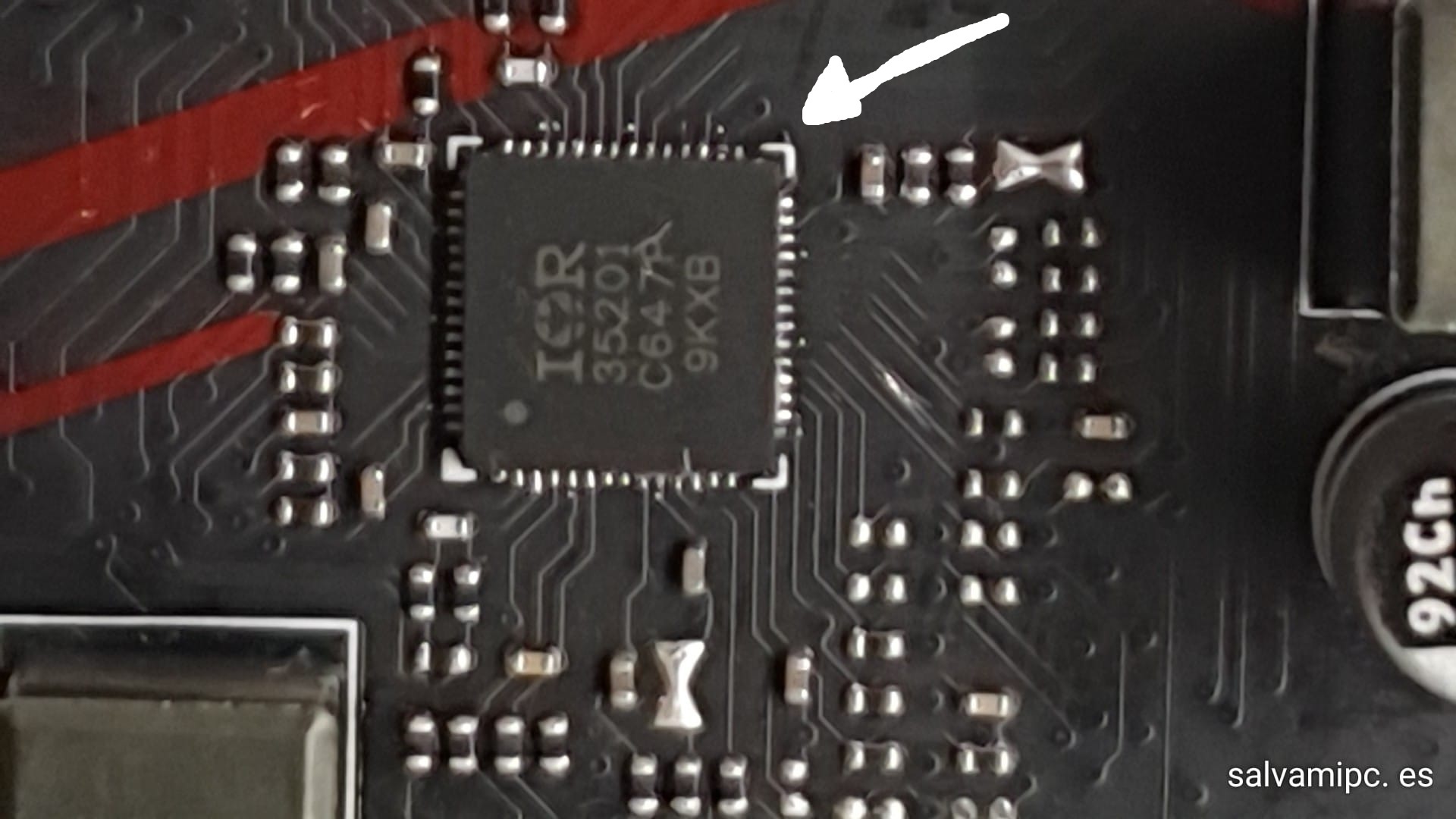

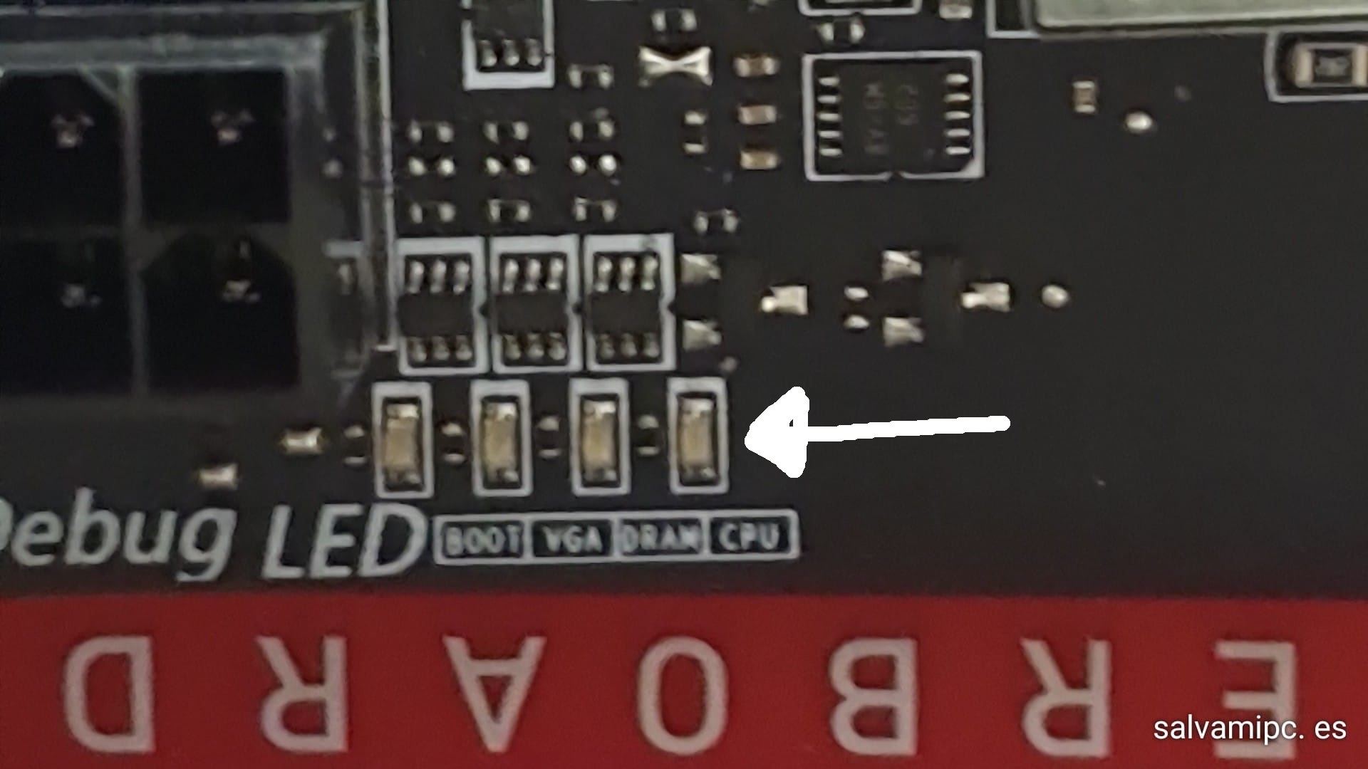

    Hi guys,

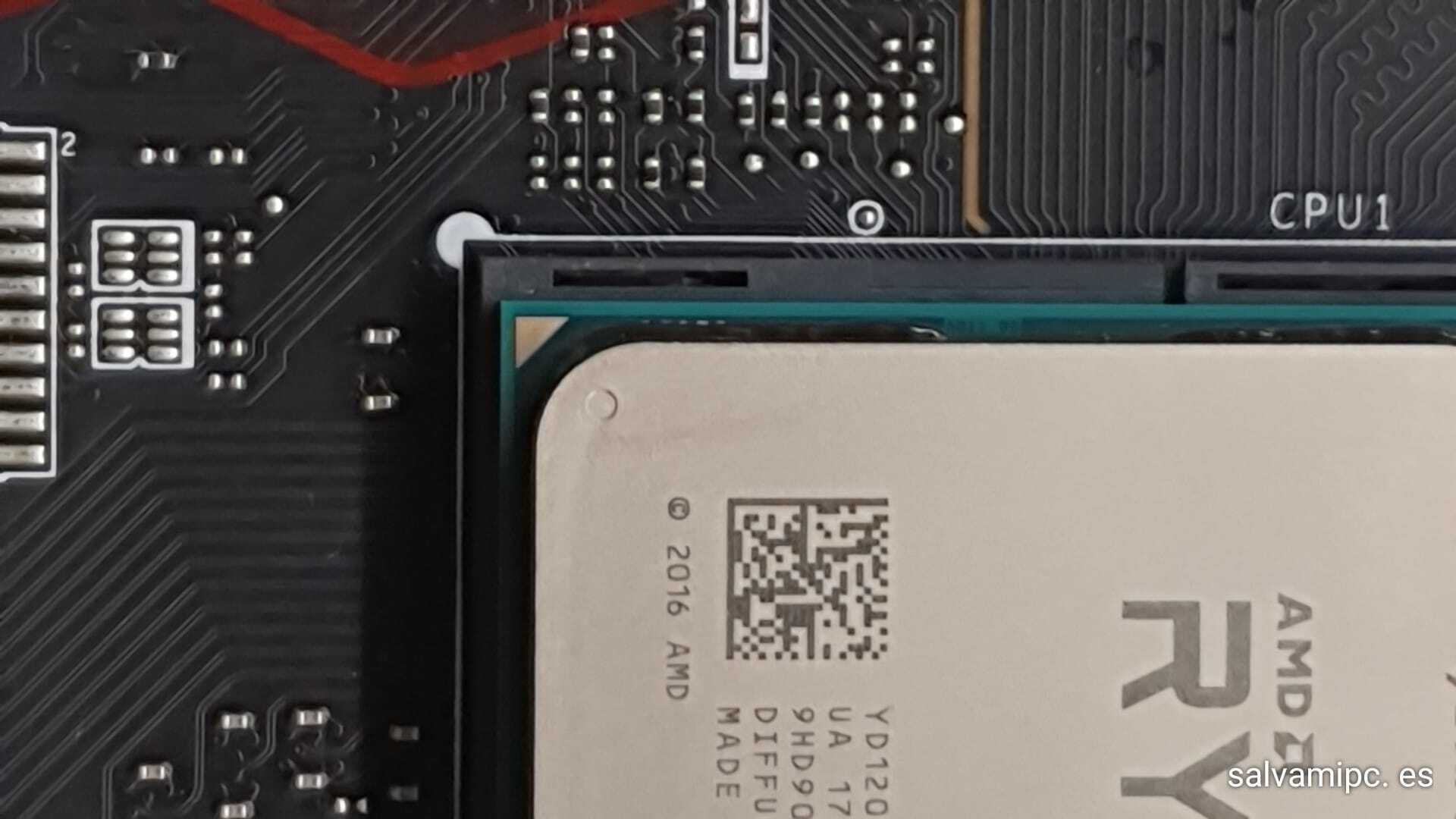

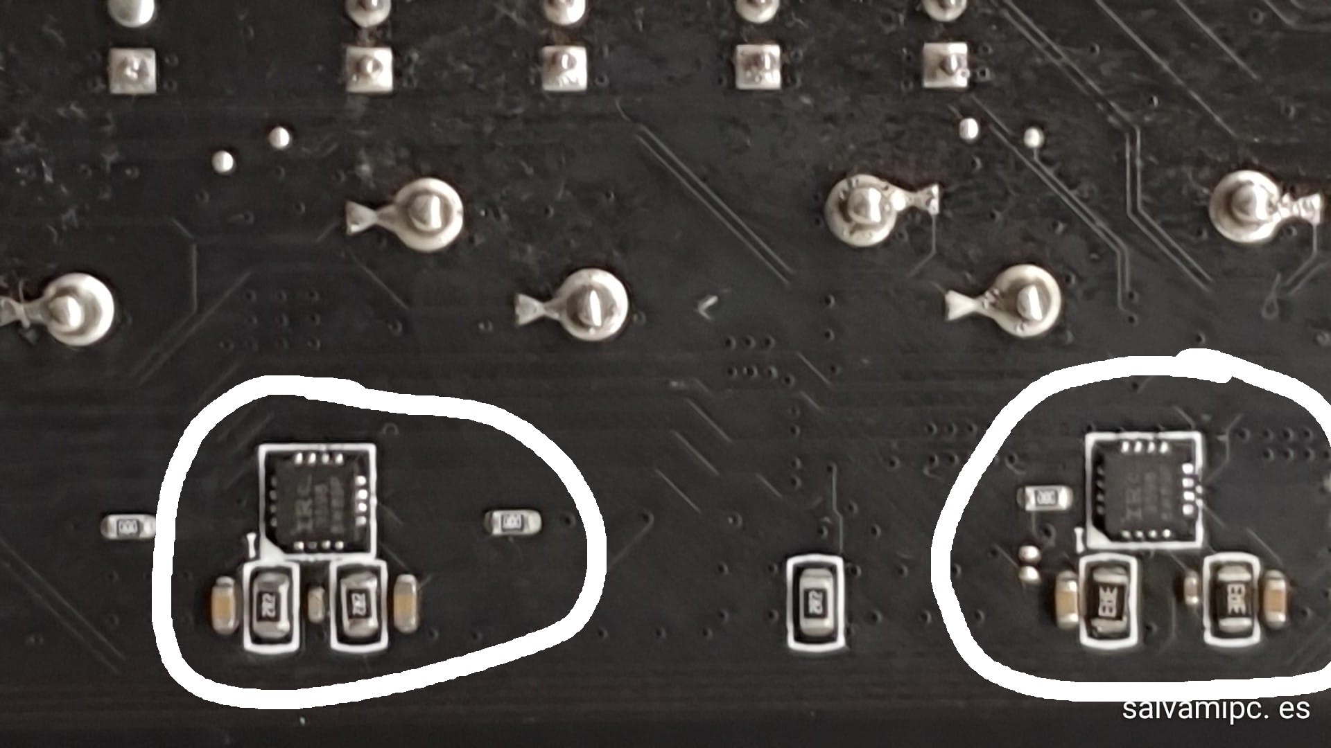

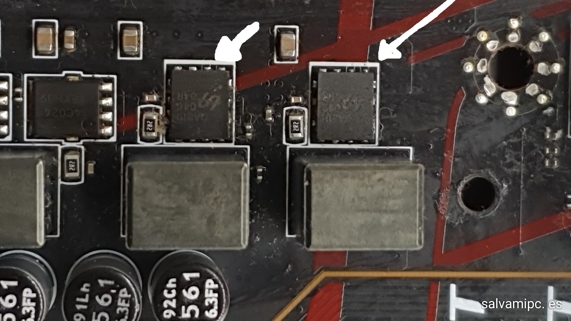

    I bought a motherboard with a Chipset IR35201 burned. Also, I found one of the dual mosfets shorted. So I changed the IR35201 and the 2 dual mosfets, and the short is gone, the board is starting, rgb led are on, but the NB fan runs at full speed, and the debug led for CPU lights up. I tried to flashed the bios using the flashback, it flashes fine, the board restarts, but still the same. If I measure the resistance on the 2 dual mosfets coil, I get with the CPU in 1ohm, and without the CPU I can't remember but megaohms. So, I thought the CPU is bad, I tried the CPU on another board and its fine, also I tried another CPU on this board and it's still the same.

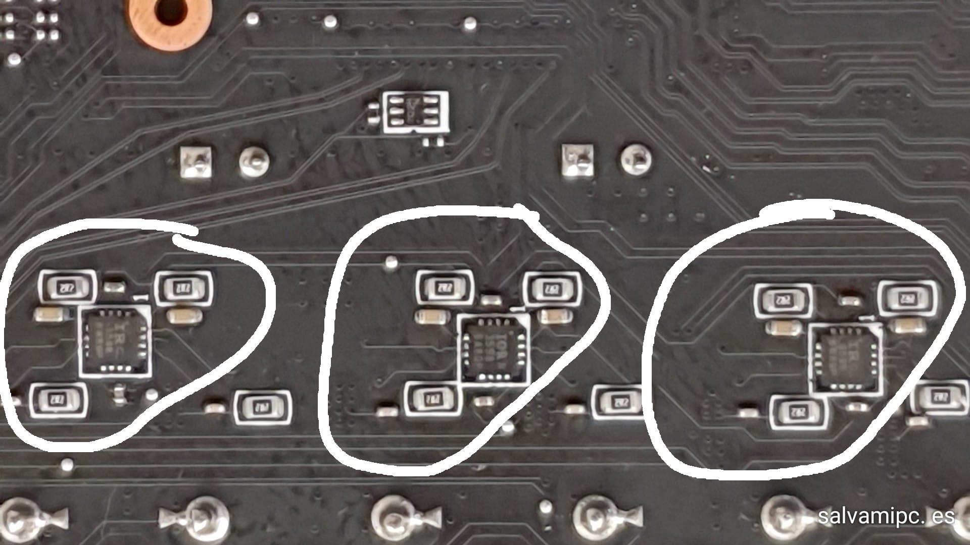

    Without the CPU in the output on this coil are like 0.4V and with the CPU in, nothing. I also changed the 5 drivers on the back IR3598, and still the same.
    Could it be a bad IR3598? I tried injecting 0.9V on the coil and with the CPU in there is no voltage drop but it takes about 2A, without the CPU is 30mA, but its not the CPU. I tested the CPU and its fine. Can someone help.

    Ic pwm IR3521 have program

        IR3521 need to be programmed? How do I program this ic?

          Ok, I see I need a programmer USB005, that costs on aliexpress €70-- the board is probably less.

            I´m going to get the C8051F340 Development Board and the C8051F Emulator Downloader and try to flash it. Just so That I understand, the file you sent (thank you) do I click on load config file in IR PowIRCenter and upload the IR35201_MSI_MS-7C37_AMD_X570_8n2_RevA_AC_2019-01-15 and then write all config?​

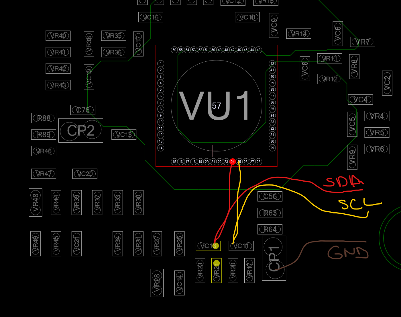

              Hi, my USB005 is few days away, just to confirm I know what I´m doing.
              On the Motherboard VU1(ir35201)
              Connect SDA to the VC13 (pin 24 of the ir35201)
              Connect SCL to the VC11 (pin 25 of the ir35201)
              GND to any ground pin
              Connect the PSU 24pin and the cpu power pins
              Turn on the board
              OpenPower Gui or IR PowIRCenter
              Auto populate
              Scan Full Address Range
              Click on the card on the left
              Click on the multi device programmer button (flame)
              Click on select configuration and select the file given here
              Then check the trim and user boxes
              Click on Program and Verify
              With a little luck everything passes​

                Hi, I got the board running, thank you for the firmware. I´m now installing windows, how Do I test if all the cpu phases work fine? Should i run OCCT?
