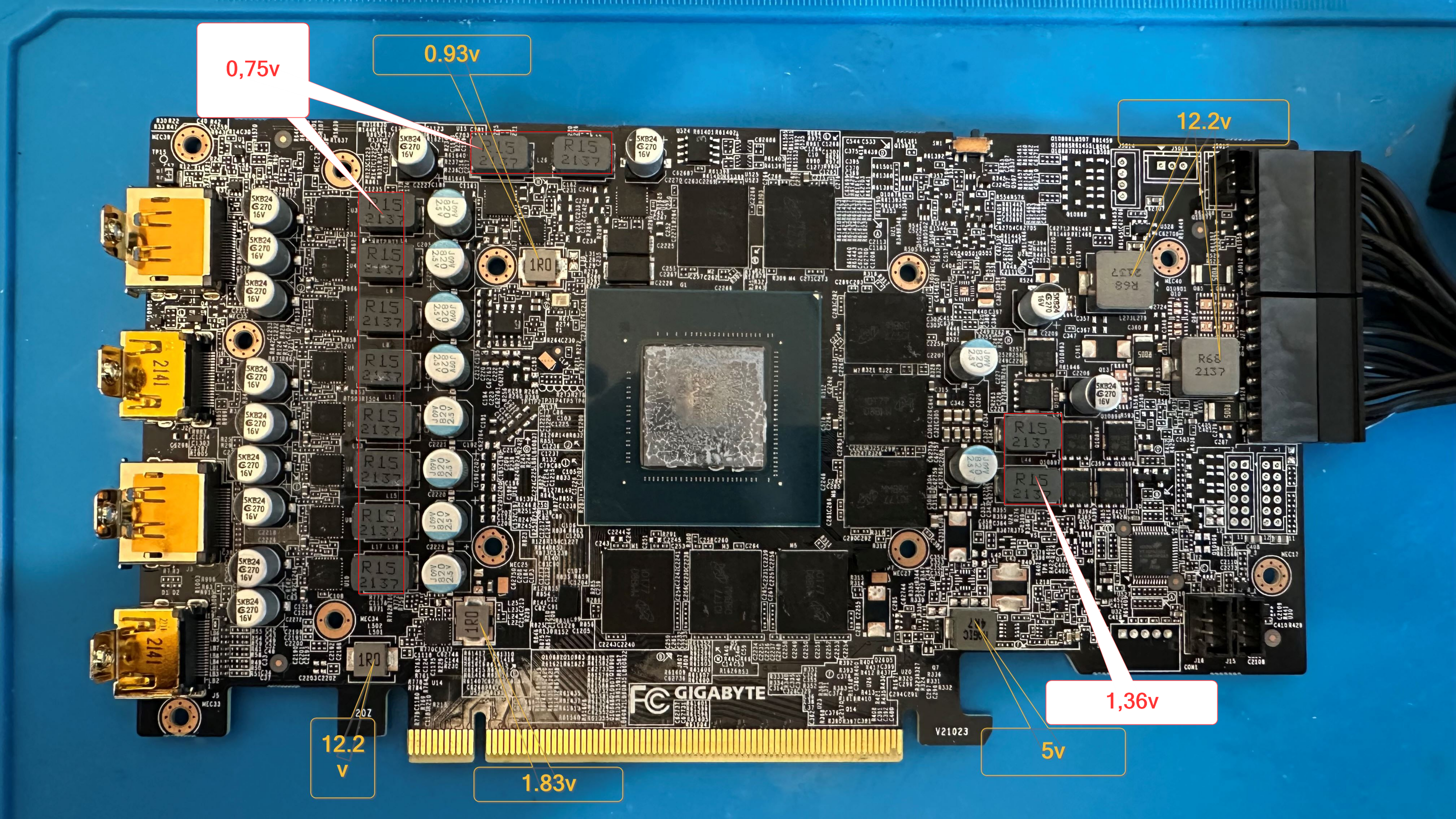

    Hi everyone,

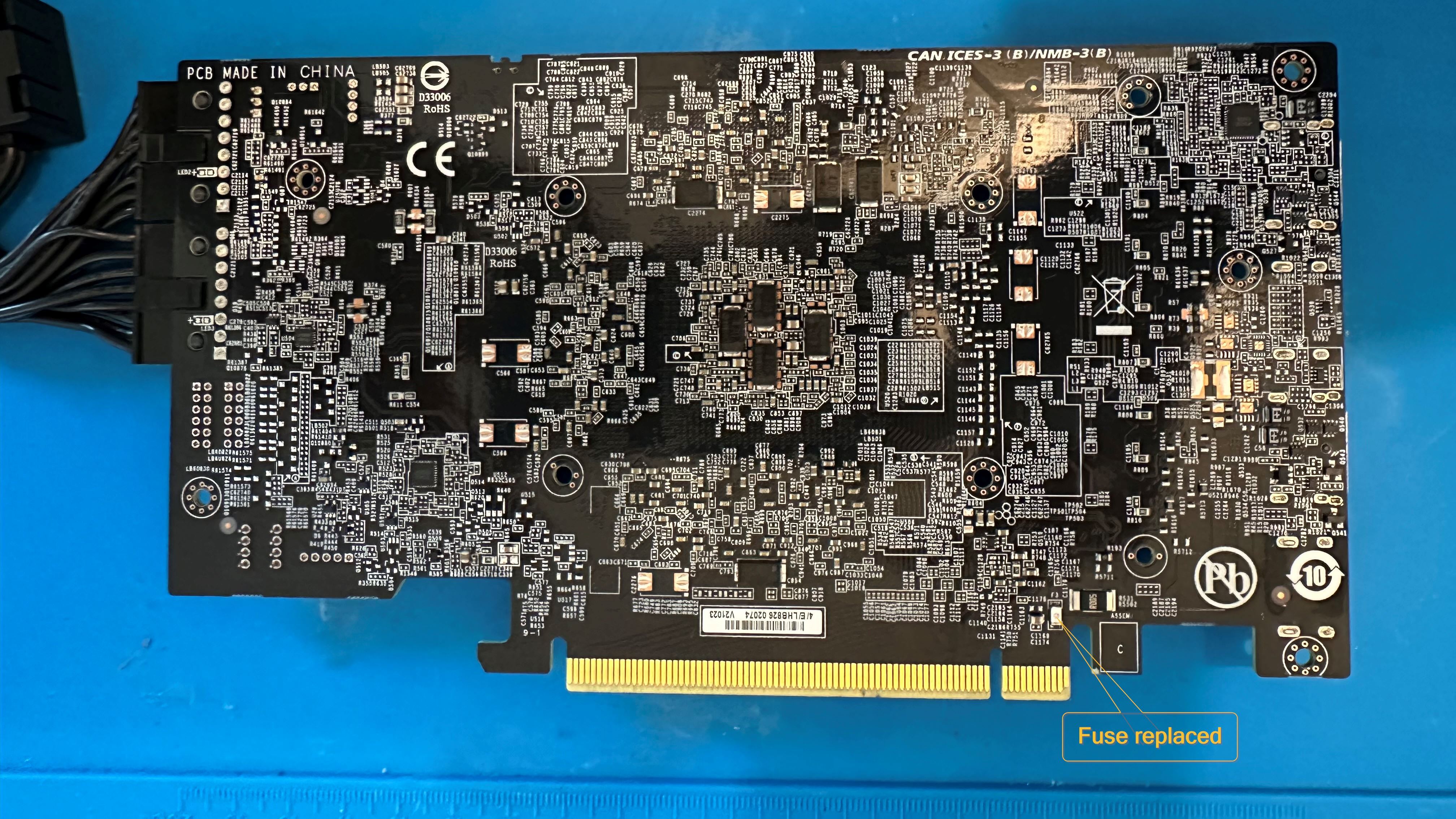

    I picked up this non-working graphics card with the intent of repairing it. I don't know the details of its failure, but the card is in near-perfect cosmetic condition. It had never been opened before I started working on it.
    During my inspection, I didn't spot any obvious physical damage. However, when testing, I discovered the PCIe 12V line was open. I replaced the blown fuse and rechecked the measurements—no short circuits on the main lines.
    When I tested the card in a system, it prevented the PC from booting. I checked the main voltages, and they seem fine.
    What would you suggest I check next to move forward with troubleshooting?

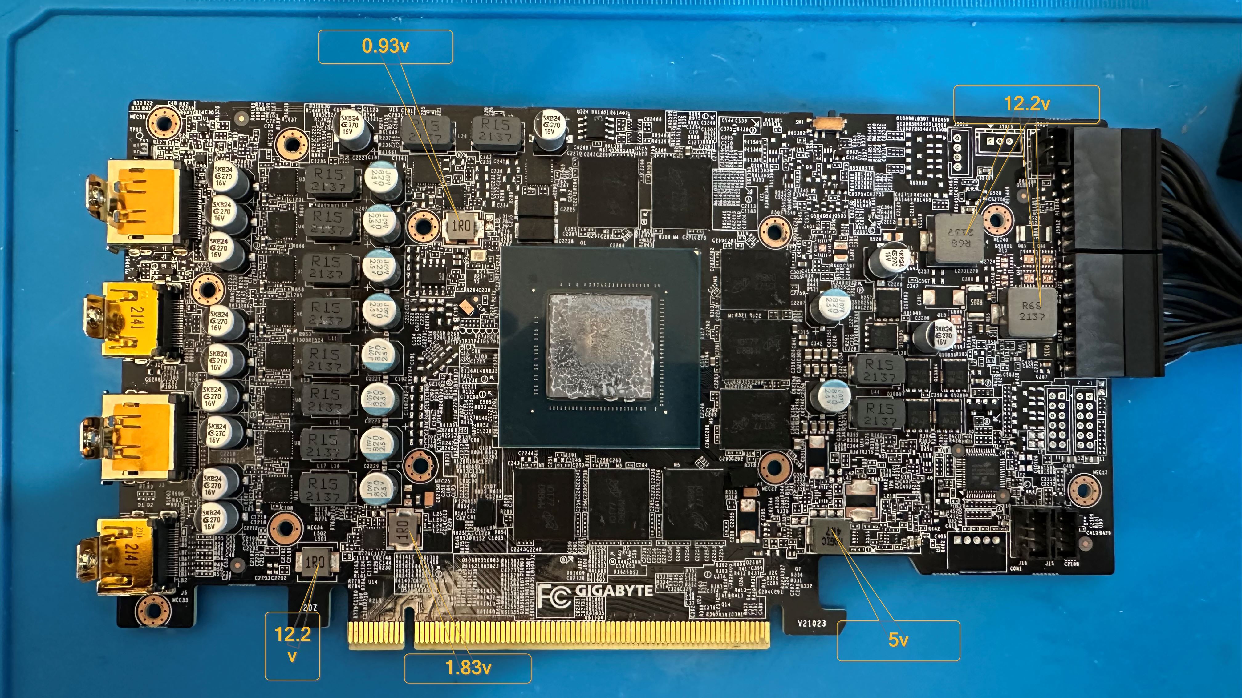

    EDIT:
    Photo with more voltage values

      Do you think it can be an issue with PEX like in this post https://www.badcaps.net/forum/troubl...reset-question ?
      I'don't have a riser for testing in good condition so i will buy one and see if there is an issue with the pex_reset

        So wrong way, PEX is present I got 1.8v on pin 4&5 u501 then 3.3v on pins 1&2​
        any idea ?

            Thank you but i have watched many videos. 😉
            I can boot using my test motherboard with this GPU as a secondary one. MATS indicates an issue with memory banks A0 and B1. I will reball the chips as a first step.​

              pray u dont have ripped pads under core
