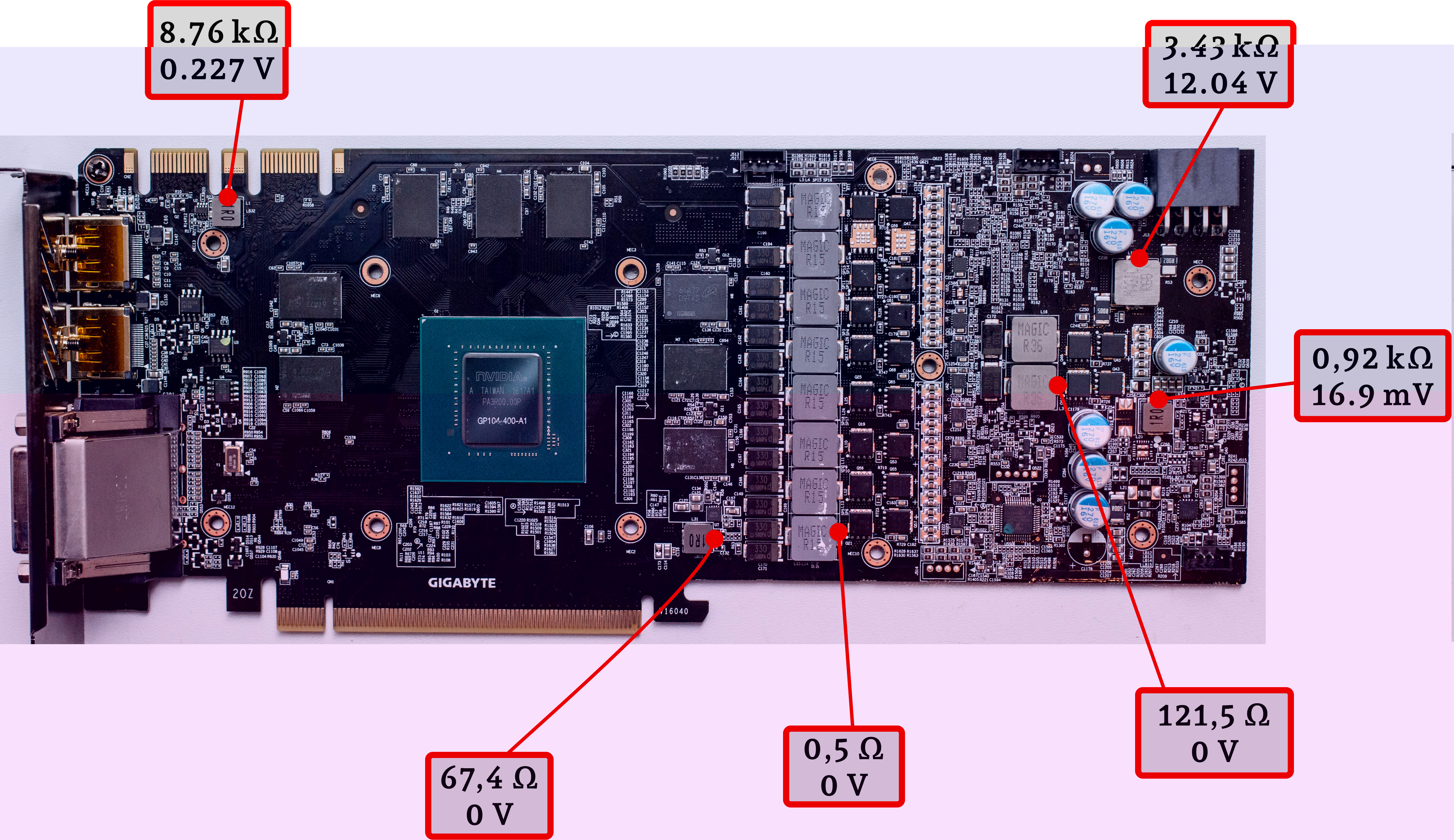

    Good morning,
    This is the first time I've tried to save a motherboard, hoping to find the cause of this graphics card's failure and perhaps save it.
    Mounted in PCI-E x1 with an x8 pin power supply: No fans, no LEDs, no video signal.
    Apart from an x8 pin power supply, here is what I get as a measurement:
Name:	Gigabyte GTX 1080 G1 Gaming - Measure.jpg
    I don't think I have a short circuit. I checked the continuity of the resistors, it seems good.
    Do you have an idea or avenue to explore? Please note, my skill level is relatively low but I am fully equipped except oscilloscope and bga reballing.
    Yours truly.​

    You can check if the 5V IC has the enable pin activated.

      5v was too low. Try to check enable voltage on 5v ic regulator.
