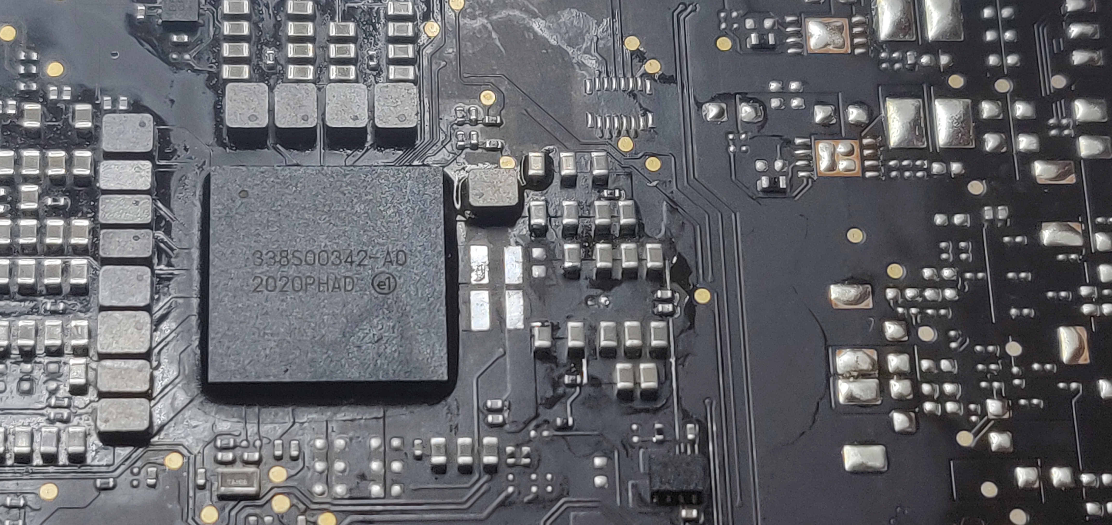

                          Hi guys.
                          I have a customer's Late 2018 Mac Mini in for a ripped fan connector after the customer tried upgrading his RAM.
                          Some pretty hefty damage occurred because the connector was ripped off entirely including all 6 pads for the fan connector. The connector on the end of the fan itself was also completely ripped off exposing all 6 wires. There is also an exploded component with what appears to be a resistor or filter. Not sure? (See pic). macOS also doesn't boot. Apple logo comes on screen and then moves to the question mark folder. Cannot boot from USB or Recovery...
