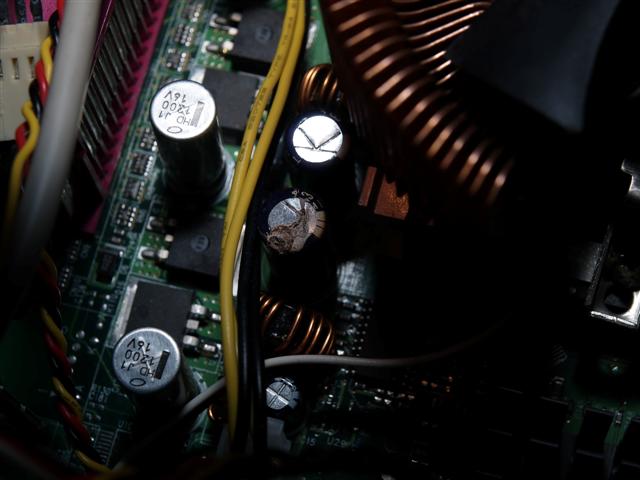

              • jo-jo
                • Dec 2006
                • 12
                Re: TH7II raid capacitor replacements
                OK here goes. I seem to have
                4x2200uF 10V (TEAPO)
                6x 1000uF 10V (TEAPO)
                6x3300uF 6.3V (MBZ)
                It is only the last ones that are leaking (see image). Where is the best place to buy good ones of these? Also, I am used to soldering, but I have never done it on a "multilayer" mobo before. What are my changes of screwing everything up?
                At the bottom of it there is a metalic cylinder, labelled HD J1, 1200, 16V. What is that? Does not look as a cap to me.
                  Here is a pretty good shot of the board.
                  It looks like they used Nichicon and Rubycon around the CPU (good), at least in that sample.
                  Around the RAM looks like Teapo (less good).
                  It doesn't look like finding replacements should be a problem size wise. Which caps failed?
                    The ones around the CPU - the ones you say are good
                      Wow, that exploded one in the pic is a Rubycon! I would look for some shorted FET's or PSU issues, that's definitely not a typical occurrence! It vented with a vengeance, so I'm willing to guarantee there's other trouble on your board or PSU.
                        Hmm... I wasn't expecting a post so soon. Should have refreshed....
                        The metallic object is a cap, a Nichicon I believe. It looks different because it lacks the jacket covering most other capacitors.
                        From that picture it looks like the Rubycon failed which I've honestly never heard of happening.
                        What PSU are you using with the system? I ask because a low quality PSU can cause capacitors to fail prematurely due to excess ripple and/or over-voltage.
                          OK. Here is the whole story: This mobo has been in various cases with various PSU's, for most of the time it was powered by one from PC Cooling if my memory serves me correct. This has been my main work machine and has been left on day in and day out, so it has been powered for about 5 years, constantly. About 2 mo ago I transferred it to its current case, an Ahanix D4 - it is a media server now, and still runs 24/7. It was fine then, I did inspect it carefully. I believe the Ahanix has a PSU either made by them or for them, at least the label just says "Ahanix".
                          The funny thing is that the mobo still runs fine, as a matter of fact I am writing this on that machine, but I am sure it will fail pretty soon.
                            Stop using it until that cap is replaced. It could cause more serious damage if continuing to use it. I would also replace that no-name PSU. The problem will not go away on its own.
