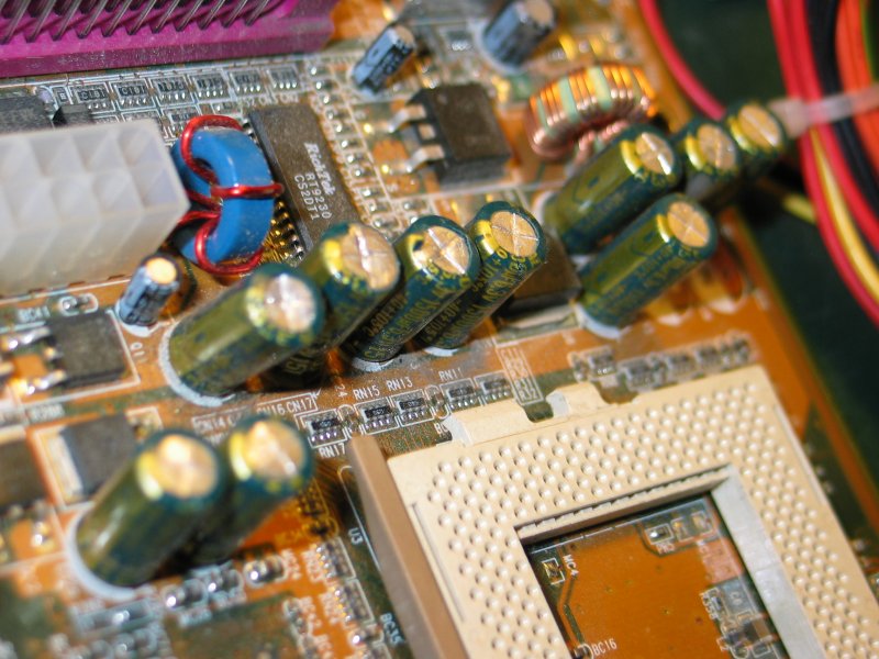

    Bad Jackcon caps... and what? PS/2 connectors missing?
    What bastard did this?

    Bad caps:

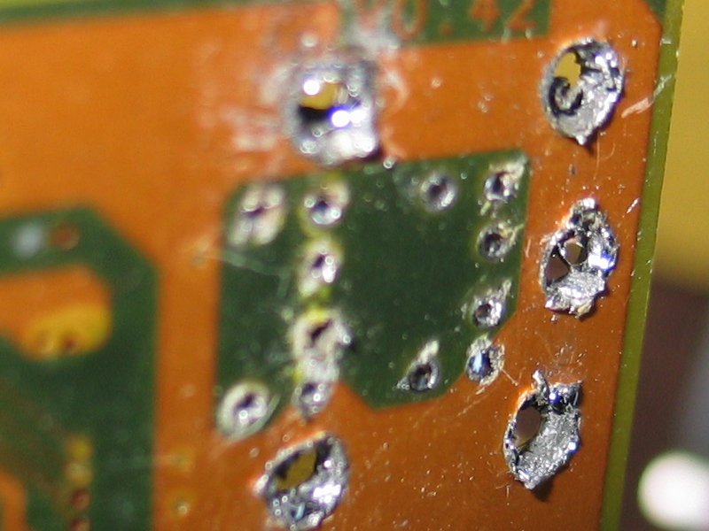

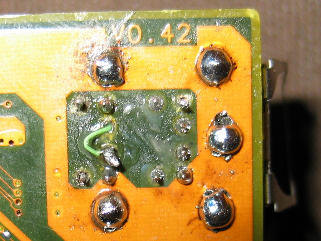

    PS/2 connector area - looks good from top (but bad from bottom):
    Doesn't look nice at all after repair but it works fine. Many of the holes were damaged but most of the pins could be still soldered. One important hole was completely damaged so I used a wire to fix it (cut one of the unused pins to make a place where the wire can go to the other side of the board).

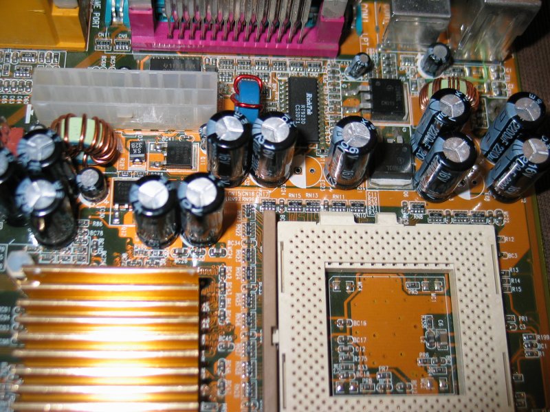

    New caps, chipset heatsink and wire near the PS/2 connectors:
