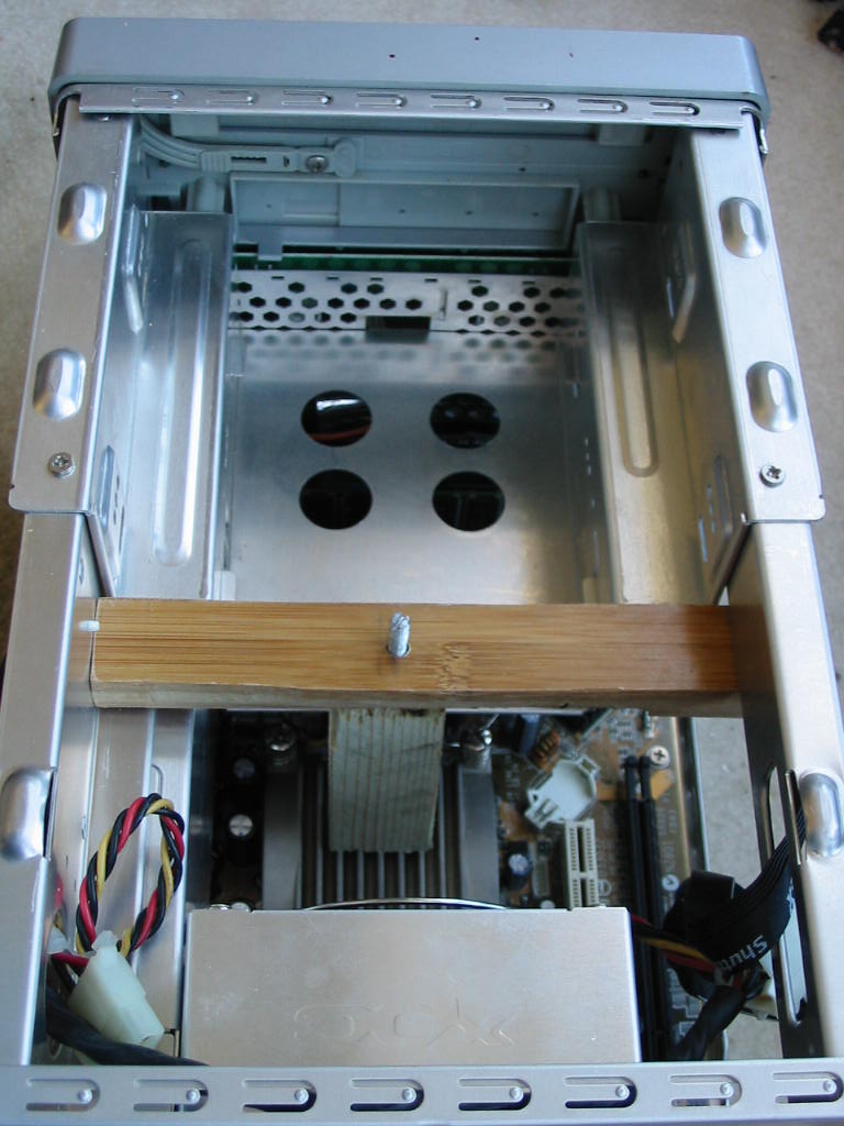

          Alright ladies and gentlemen. After this project sitting on the back burner for over a year and some contemplation going on in the back of my head about how to proceed, I finally came up with a “temporary” solution :roleyes: … that may actually end up being permanent… if it ends up works permanently, anyways. LOL! I guess, we will have to see.
          Basically, I did some risk evaluation, and thought the chances of messing up the board worse than it is are really high if I try to do a CPU socket reflow (let alone a socket reball.) So I went down in the garage and started tinkering with how to exert downward pressure on the CPU area to keep the board working. It took me no more than 10-15 minutes before I found some completely scrap materials that actually looked like a perfect fit for the contraption I had in mind. (Gosh! I’m such a hoarder. But at least I do eventually find a use for much of the scrap junk I keep around.) Namely, it was two pieces of wood and a threaded rod (1/4” ?) In fact, one of the wood pieces and the threaded rod were both already the length I needed. So all I needed to do was just cut the other piece of wood, drill two holes in it, and then widen an existing hole in the Shuttle case for one of the screws. The work took me maybe 20 or 30 minutes total. After that, all that was needed was a nut that fits the threaded rod and a washer - these were probably the only two “new” parts I used here (though I bought these packs of washers and nuts probably close to two decades ago.)

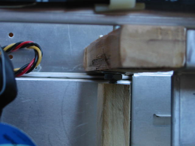

          Anyways, here is how the “fix” ended up looking like:
          Essentially, the horizontal wood piece is held by a screw on one side of the case, and the other is just wedged against the case frame. Meanwhile, the threaded rod has the nut and washer on the bottom of the horizontal wood piece. So as the threaded rod is tightened, it starts to push down on the vertical piece of wood, which then applies pressure over the CPU heatsink. This warps the board and enables whatever BGA is broken down there under the CPU socket to make contact again. Yes, it’s a complete jurry-rig setup, but it works. And if that’s not bad enough for you, notice that the threaded rod has a notch cut at the top. Why? Because I couldn’t find a matching bolt and nut with the length and thickness I needed. So when I decided to use the threaded rod, it had no head on either end. Thus, to make it “turn-able” I cut a notch at the top so it could be turned with a flat heat screwdriver. But you know what? Who cares, as long as it works… and it does.
          When I first tried this contraption, I started tightening the threaded rod to see how much pressure it can exert on the board. Needless to say, the relatively fine thread on the rod allowed me to warp the board easily. At first, I put a good amount of pressure on there and tested the motherboard - it booted no problems first try. But eventually, I decided to play it the other way around: loosen the threaded rod all the way and slowly start tightening until the board starts POSTing. Did that, and found the board barely needed any pressure with the threaded rod to start POSTing. So I plugged the HDD with the original OS that the owner gave me and gave it a spin.
          After over 8 years in storage, the Windows XP Pro SP2 on that HDD booted fine without a hitch. However, I found the GPU drivers were missing / never installed. Easy fix, of course. Next, I found a big library of music on the desktop and just started browsing it while also playing stuff. 2 hours later, and the PC was still running rock-solid - no crashes or anything like that.
          The next day, I decided to check out some more music from that library. So I pressed the power button and the PC booted again. But then after a minute into the desktop, the screen blanked and CPU fan spun at high speed again. :\
          Was my victory short-lived? Did I kill it?
          I turned off the PC, took out my trusty flat head screwdriver + wrench and advanced the threaded rod about ½ to ¾ of a turn forward. Then I pressed the power button again and… hey, no more problems, amigo! The motherboard booted fine once again. After a bit of use, I tried turning off power to the PC, let it cool down, and then powered it back up later to see if the issue would re-appear with a cold boot once more. However, this time it didn’t. So I think my fix (jurry-rigged setup) works pretty well.

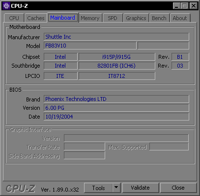

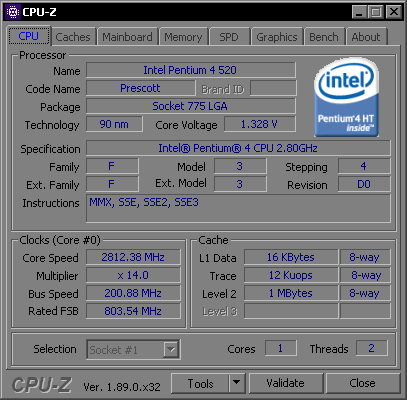

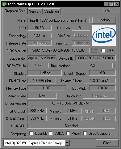

          With that said, here are some CPU-Z screenshots of the motherboard and CPU
          And the i915 onboard GPU:

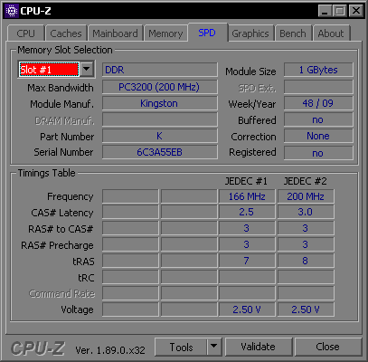

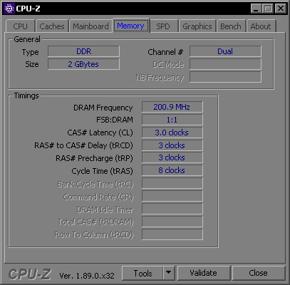

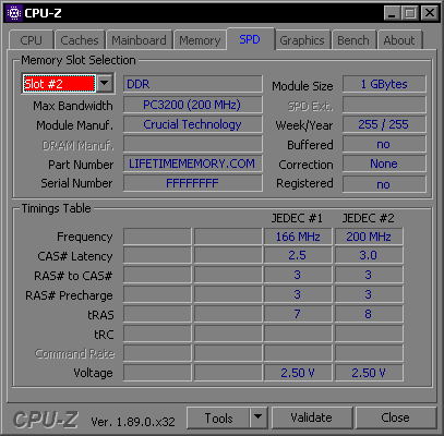

          While at it, I thought some of you might find it a bit funny what the two dubiously-branded memory modules (A-Tech PC3200 1GB) reported in CPU-Z:
          https://www.badcaps.net/forum/attach...1&d=1608957649
          In particular, the two memory modules above appear to have identical labels. However, one has Kingston memory chips, while the other one has… well, I forgot, but it was something different (though still name-brand chips, IIRC.)
