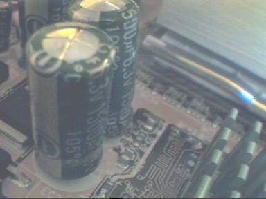

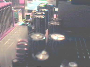

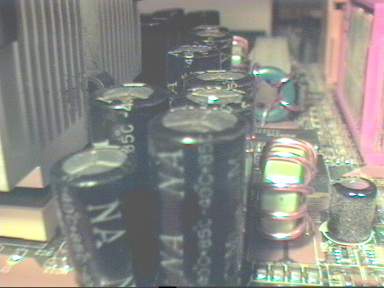

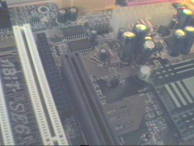

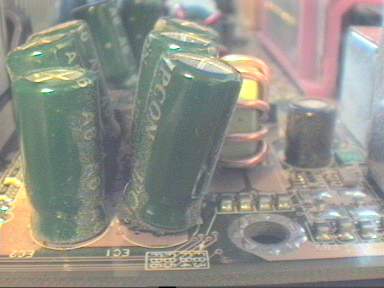

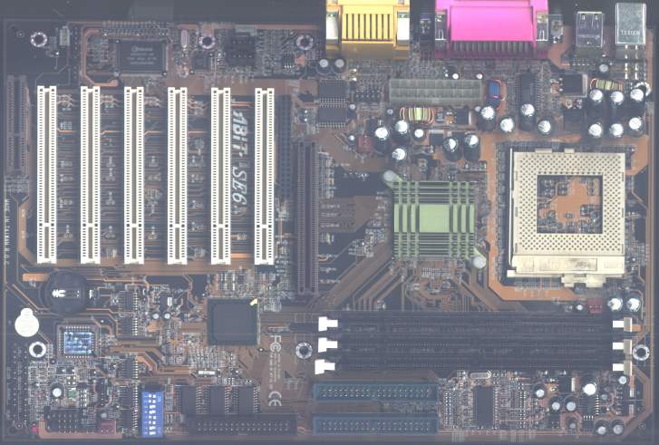

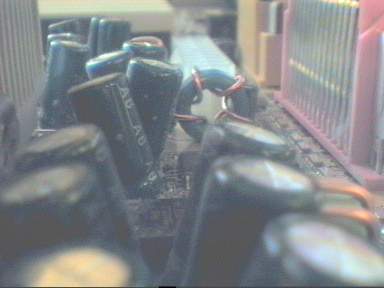

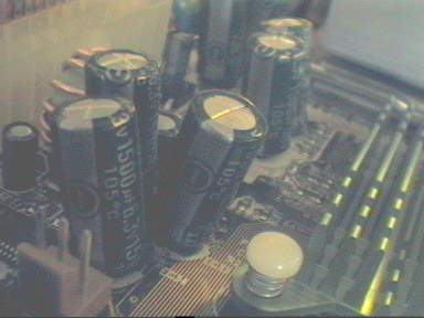

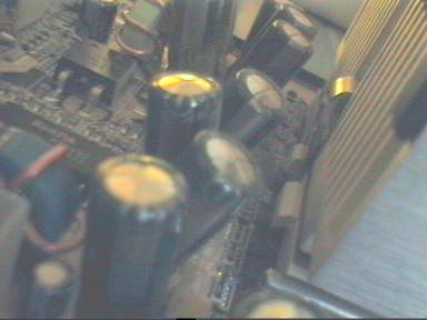

    Another Abit with cooked caps...
    I've seen this board with both Teyah and JPCON caps. It has 18 - 1500uF 6.3v caps that need to be replaced.
    Of course this board is full of those goofy 8mm caps. It's a snap to recap it using 10mm replacements. For some pics and pointers, take a look at this:
