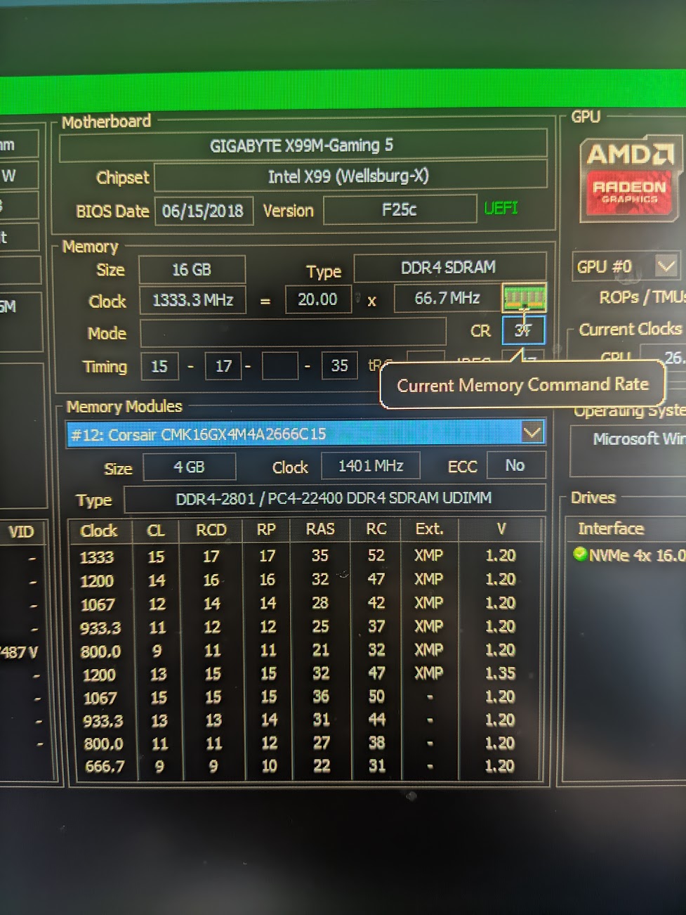

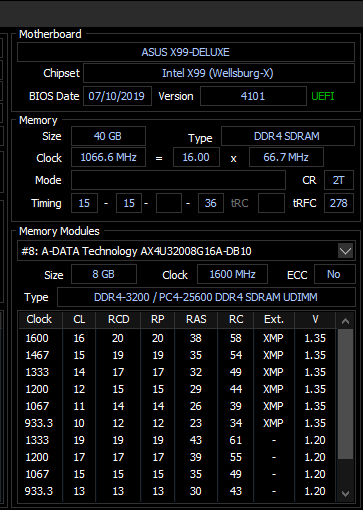

    So i have 3 bords and all were tested with 5820k (got 2 of them), 1 of the boards isnt working atm but it had the same issue.
    I got a set of 4*4gb corsair set @2666mhz which works in all 3 boards, quad channel, xmp.
    I bought 2 sets of adata 2*8gb @3200mhz but it isnt picked up by the board at all. On the Gigabyte it refuses to boot. On the asus boards it will but if i have at least one of the corsair sticks in the primary channel. I have tried all slots and all of them detect the corsair memory.

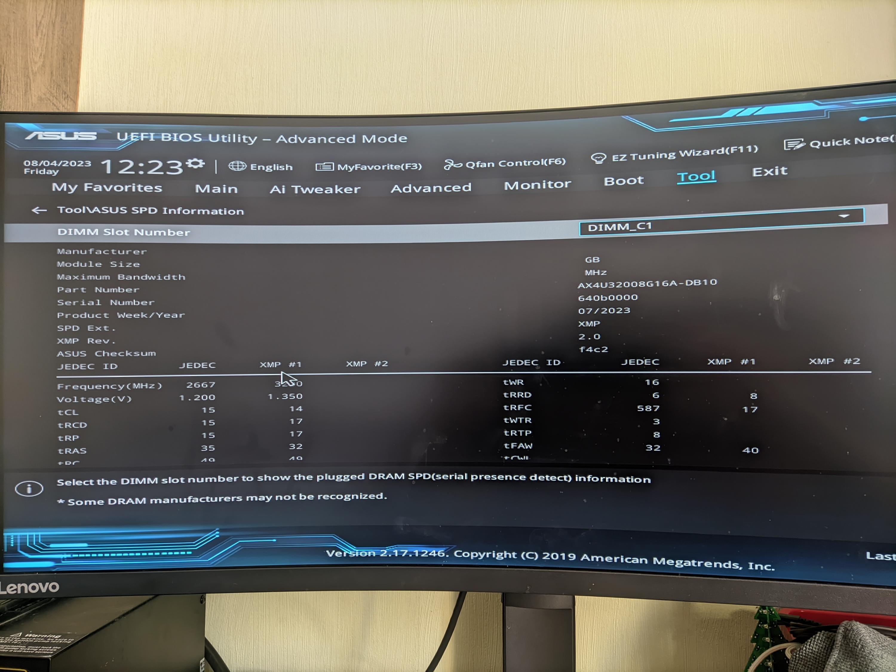

    Thing is the spd information in the bios works and gives me some info on the adata memory, it is also detected by hwinfo. I have tried system voltage of 1.2, core voltage 1.3 (normal oc at 1.2), also tried dram voltage of 1.5 and 1.35, 1.2 and in between. I have also tried different bios versions, and setting the latency and speed manually but it just dosent boot.
    Any ideeas?

      I know there isnt but it should at least be detected shouldnt it? also tried a hyperx 8gb 3200mhz stick and that wouldnt also be detected (tho was on a older bios)

        You seem to indicate that it is detected in your first post.
        I remember a time a few years ago when motherboards were picky about their memory and so the produced QVLs. I stuck to them when building PCs.
          • 31247
          Re: Asus X99Deluxe/S & X99m cant detect ram
          it should detect anything, the detection is simply reading an eeprom on the stick

            So for basically it just dosent like it so it wont be detected fully or by windows.

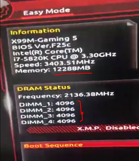

              Gigabyte X99m-gaming 5 dimm slot problem
              I have this X99m-gaming 5 from Gigabyte and a 5820k but the most left slot of ram(near usbs) isnt working. The memory i tried is working fine on a x99 deluxe and is a 4x4gb corsair kit.
              The problem slot is labeled DDR4_1_A but i cant find any schematics
              I have tried:
              - Different bios versions
              - Checked the caps for memory voltage and they are @1.2
              - Tried higher voltage for the memory
              - Reseated the cpu
              - All the socket pins are there and look fine
              Maybe someone can help
