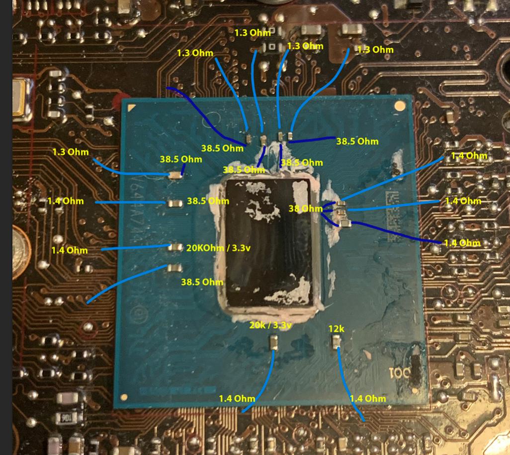

    Hi, I am trying to fix an msi motherboard B250i gaming (MS-7A67), I am a newbie but I want to learn. I have tested things and I think it is the 3VSB which is missing.
    The MB doesn't boot on power button press, there is 3v on the PSIN#_R and go to Ov when pressed.
    I have tested:
    no shorts on ATX pin ( continuity test between GND and atx pins)
    SuperIO PWRBTIN got to 3v to 0v when pressed
    RSMRST is always 0v, when I follow this I saw that RSMRST from SIO is connected to R328. R328 is RSMRST <> 3VSB (0v)
    Here is some measure:
    3VSB = 12Kohm
    5VDUAL = start @ 30Mohm but it decrease like less 20Mohm in 10 seconds (it is normal?)
    5VSB_5V = 0.888Kohm
    ATX_5VSB = 0.878Kohm
    SYS3VSB_OFF: 5v
    PCH_SBDRV: 5v
    PCH_VCCDRV: 0.005v
    Batlow#: 3.3v
    intruder#: 2.8v
    suswarn#_cp: 0.023v
    susack#_cp: 0.023v
    PCH_1VSB: Ov
    RTCRST#: 3v
    SRTCRST#: 3v
    slp_sus: 0v
    PCH_DPWROK: 3.42v
    SIO_3VA: 3.39v / 9Khoms
    PCH measure attached.
    I have check some components:
    U32: only pin 2 and 7 have 5v others 0v
    U33 (ACPI CONTROLLER): the enable pin is 0v so no 3vsb output
    Q51 (???): only 5v on pin 3 and 4
    I know that I miss lots of thing, hope this could help. Can it due to a dead PCH?
    Is the 5VDUAL the first voltage to fix?

        Hi, thanks for your time. I have uploaded boardview and schematic if it can help. I havent find any short, attached a picture of the PCH with some measure on the first post.
        Actually I think that is the SYS3VSB_OFF which are put 5vdual to ground, but I am not sur to understand where it the source of SYS3VSB_OFF.
        Is there some where a picture or document which indicates the step of a boot for intel motherboard?

            If I am not wrong "3vsb enable" is from 5VDUAL (throw R549) and it is missing too.
            The mobo is not turning on at all right? nothing happen
            It only turns on if you force jump the ps_on in the ATX connector but not when turning on via mobo Switch? => Never tried this.
            Can the PCH be dead? If yes how to be sure?
