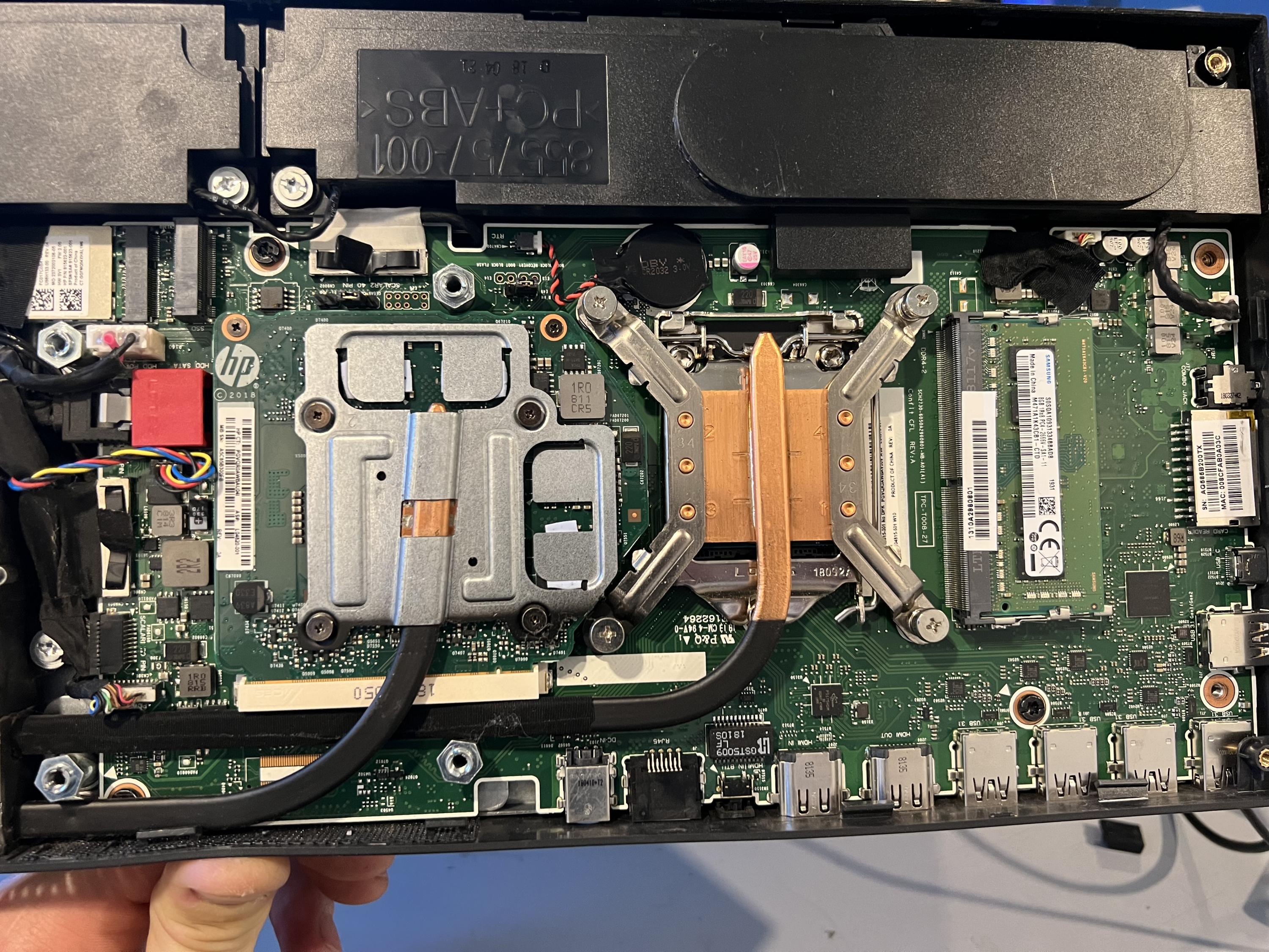

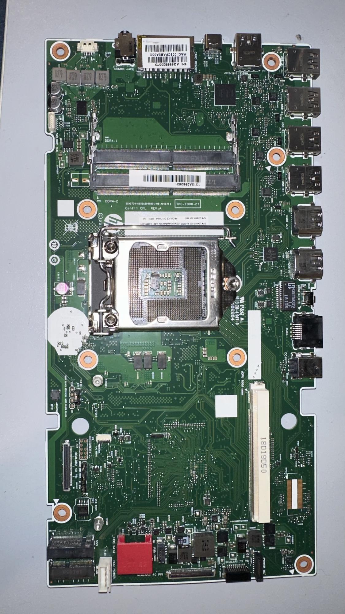

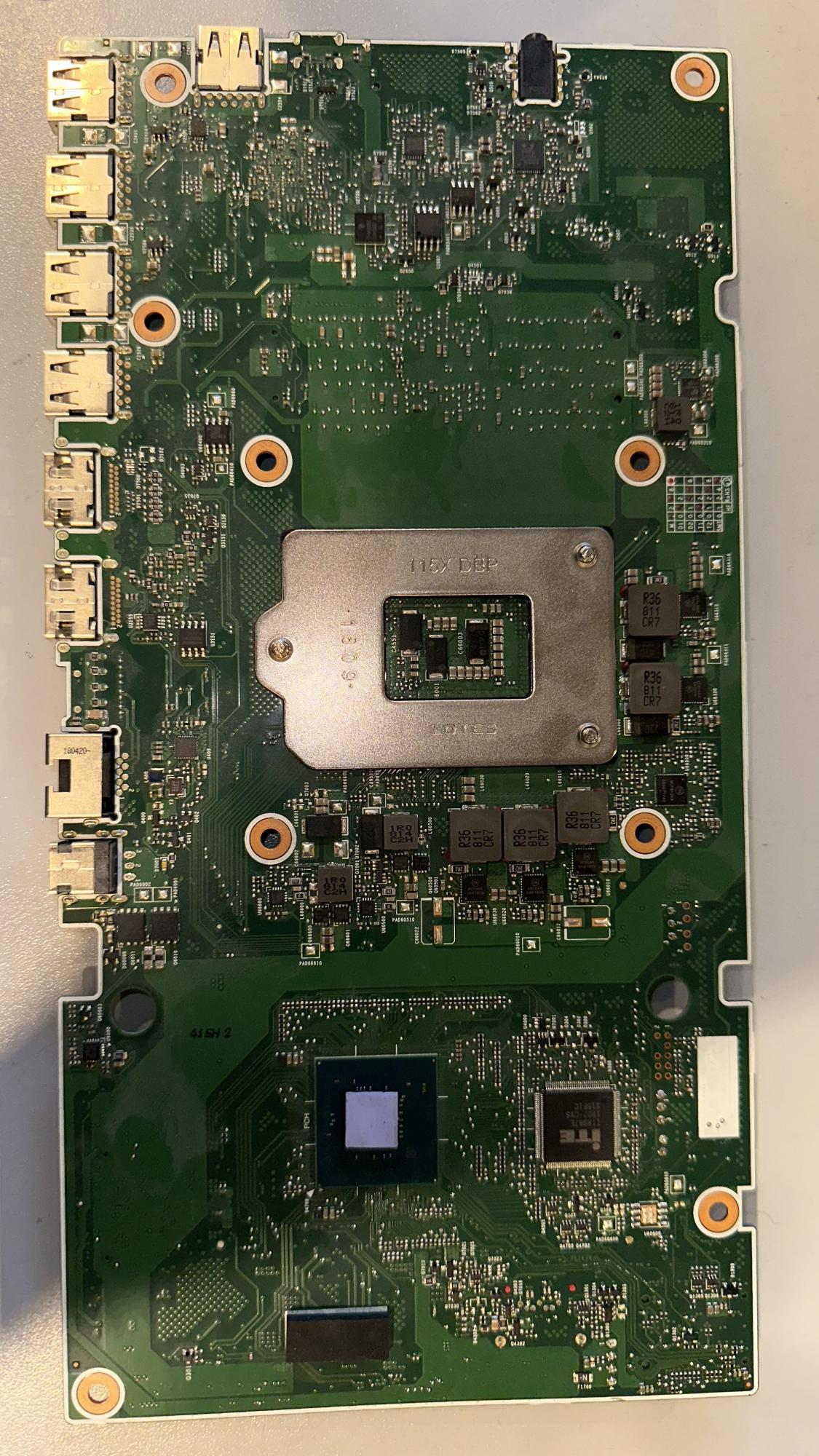

                  I looked around the board and couldnt find anything visually, or checking everything i could with the meter. Here are pictures of the board, maybe some could chime in.. Thanks

                      • 21637
                      Re: HP Envy 27 B210 AIO All-In-One Boot Problem
                      Originally posted by cheebster
                      Anyone ?
                      Post the exact resistance measurements to ground of all the large grey square coils, on both sides of the board.Mark them on your pictures

                        With a fluke 115 set in ohm mode auto, i get all readings in MegaOhms and fluctuating either up or down. is that normal ? On each coil.
