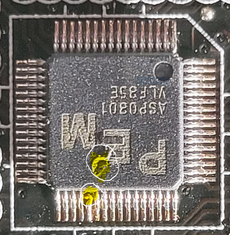

    ASUS P6T Motherboard, ASP0801 help?
    Hi, I am looking for help trying to source this part and understand why/how it failed? Motherboard was free and I visually identified this ASP0801 VLF85E chip has a leg that looks burnt off and I believe it vented the chip. I could only find one person selling a chip similar on ebay, but the "VLF85E" was different. I cannot locate a data sheet with pinouts anywhere?
    Looking for help or guidance if this is even worth it? The motherboard powers on, fans and led's on, but will not post, no beep codes either? thank you

    Re: ASUS P6T Motherboard, ASP0801 help?
    Pin 29 - P_VCORE_PHASE2_10
    Boardview: https://www.badcaps.net/forum/showth...&highlight=P6T
