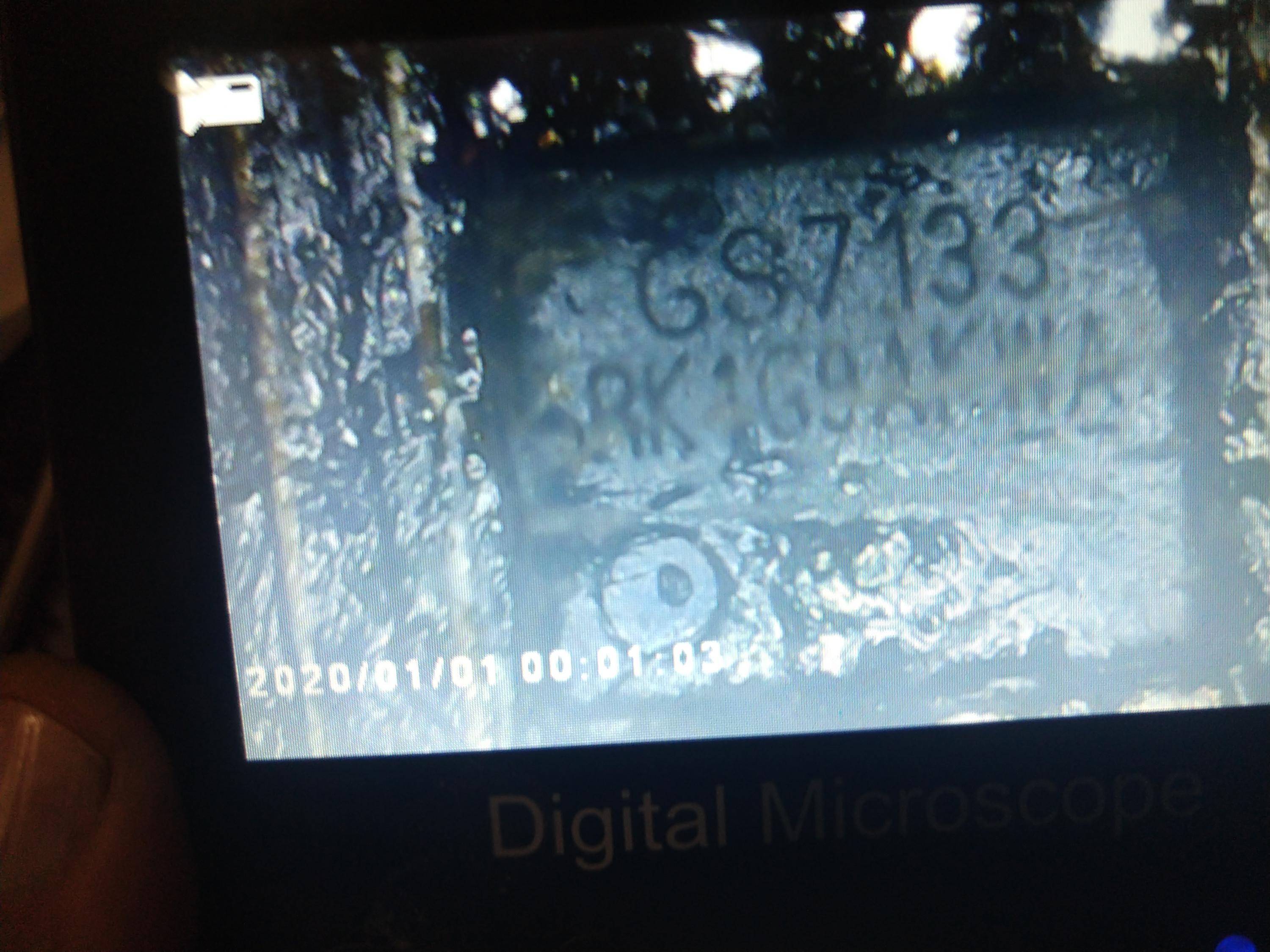

    My cousin gave me a free broken motherboard that would be an upgrade over my MSI B350 Tomahawk and I'm trying to fix it and I found the problem by burning my finger. It sits between the PCIE slots and reads "GS7133" and "RK1G9AKWA". Google shows me nothing about this or where to get a new one. As you can see I tried to get it out but my cheap Ebay hot air and solder iron just doesn't get it hot enough. I tried mixing the solder with my leaded solder it still won't come off. I'm afraid to use more hot air so I was thinking of using a dremel to grind the chip away and then using my soldering iron to remove the legs.
    Can someone point me to where to get another one of these and also any advice on how to get this out?

    Found the data sheet and the stupid thing has a pad underneath for ground. I also ordered 10 for $10 off Ebay which may take a couple of weeks. My plan is to use the Dremel to grid it down enough to reach that ground pad and then use my soldering iron to remove it.

        I watch NorthRidgeFix religiously. Does anyone have a diagram for this motherboard? I took out the GS7133 successfully painful and also found a capacitor shorting to ground that I removed. The capacitor was going to "VIN" and from the GS7133 spec sheet it shows that it has a 10uf capacitor before going to ground. I also have a short on "VOUT" and that also has a 10uf capacitor before ground according to the spec sheet. I don't know where that capacitor is.
        I don't have a thermal camera because they're expensive, but I can try spraying rubbing alcohol when I inject voltage. I'm also not sure how much of a ground is considering a short. The VOUT is a 100% shorting, but other sections of the board around the chipset are reading 20 Ohms on some capacitors. My multi-meter is beeping like there's a short. Maybe finding that other bad 10uf might remove the 20 Ohm shorts?

              I tried injection voltage to the VIN pin that was for the "GS7133" and nothing. No smoke, no heat, no nothing. I started to look for another "GS7133" and I did and that one also has a shorted VIN pin. I started looking around the board with my meter looking for shorts and I found a few SMD capacitors that were shorted, except that they weren't when I removed them. The short is someplace else. I'm thinking that the two "GS7133's" on the board have VIN's going to the same source that could be shorted. Can't be both just so happen to be shorted? This is where a diagram helps because I injector 3.8V and my tool started to burn.

                            Ok I'm an idiot. Took me a year to see this. The product number was staring at me in my face. It's a MS-7C91 VER:3.0 . I was looking at the GS7133 IC near the PCIE because it has a short to ground for VOUT and then I see this. The GS7133 up top of the motherboard has a short to VIN. Can you find the schematic for me?

                                I tried searching MS-7C91 and just this thread came up. LDO chip, you mean the GS7133? Those weren't bad. I was looking at the connector to see which if any is going to ground and +3.3V, a couple of +5V, PG, -5V, and +12 are going to ground. Plus there's a whole bunch of capacitors and stuff around the B550 chip itself that are shorted, so I'm thinking the B550 chip is bad. I've tried injecting in 1.8V and 3V on like the VIN and VOUT lines and I can't find anything getting hot. I don't know 100%, but if the B550 is gone then there's no point trying to fix this board.

                                      Thank you, this is a big help. I'm using OpenBoardView since I use Linux Mint and it seems to work. All the shorts I've found seem to be connected and it's called 3VSB. Both GS7133 IC's are connected to each other but one is VIN and other is VOUT. Doesn't look like this goes to the B550 chip itself, so that's good. I do have a tool to inject voltage but the tool itself starts to smell like burning electronics. I really wish thermal cameras weren't expensive. Maybe I can visually look where each of the 3VSB lines end up and hope I can see visible damage?

                                        Didn't find the cause of the short but I found this. I thought for certain this might have been the cause of the short because one of the 3VSB lines runs to this but the two that look shorted aren't the 3VSB. I thought that this might have just shorted out the entire component and thus taking the 3VSB down with it, but nope. Took a lot of force with an exacto knife to get that chunk of metal out. I then removed it and nothing on it is shorted plus the 3VSB short still exists. I wonder if that's was like that from factory or did my cousin who used to own this board drop some liquid metal and then the connection cooked it rock hard? If that's from the factory then I question MSI's quality.
