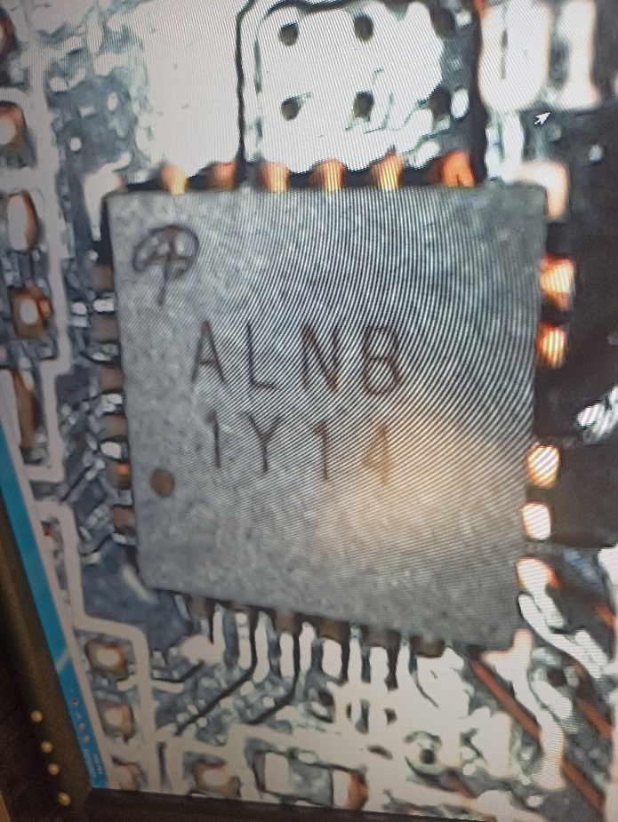

    Hello.
    Have this Gigabyte 1660 Super that have no EN signal for PEX. It supposted to go from PGOOD from 1.8V ic but i cannot identify this ic

    its so great to have marking codes here on page. found it. AOZ2261NQI-11
    I have 5V on PGOOD/pin 1/ and must find where it goes
