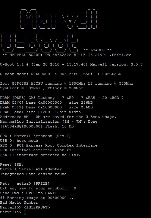

      I get nothing from serial console of Zyxel: i think there is a big hardware problem and its "brain" doesn't work.
      To test my serial connection and Putty, first i connected a probably unrecoverable (?) Qnap TS 219P+ (tried all Qnap suggested recovery procedures without luck: firmware seems to be loaded but at the end of the loading nothing happens: nas does not reboot, no beeps ...) and the result from console is in the attached picture.
      What do you think about this output? What does it mean "Bad Magic Number"?

        Re: NAS Zyxel NSA325v2 problem
        Well done on the progress, at least now you can see what's going on and it doesn't appear to be completely dead!
        That looks like a problem with the firmware, that is, it's trying to load and boot but the image is broken so it can't decompress the Linux Kernel. Here's the boot process http://zyxel.nas-central.org/wiki/Bo...ss_(300_series)

              [QUOTE=jondoe;721118]You don't have a Qnap, you have a Zyxel, so for a start I wouldn't be trying to use Qnap recovery methods, there is a 99.9% chance it won't work. If you've done it already, there is a good chance this is the reason it isn't booting.
              Sorry, there is a misunderstanding.
              I tried serial connection with Zyxel and nothing happened so i put it in the bin.
              It doesn't exist anymore.
              But, to be sure that my serial connection was working ok, yesterday i connected a bricked Qnap that was lying somewhere in my room.
              So all my thinking about flash chip and bla bla bla are Qnap nas related.
