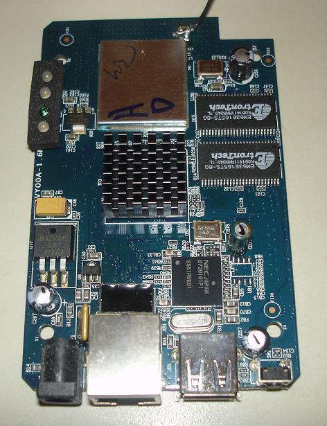

    So I recently picked up a used Linksys Wireless G Printserver off E-bay.
    The previous owner stated that it was used for near a year and worked well.
    I set it up and it worked well for me too but like ALL of my network equipment I crack it open to check up on the caps. Both to see if they are bulging or if they are a bad brand.
    I was telling myself while opening it up that I was wasting my time and everything would be fine.

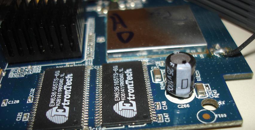

    But it was the exact opposite so I open it up and there right before me 2 bulging elite capacitors both 100uf at 25 volts.
    One was a power supply filter before the switching voltage regulator and the other was on the other side of the board.
    While the tops are only slightly domed they have pushed their bungs out.
    If you look very closely you can see it in the pic of the cap sorry my camera doesn't like the miniature caps and it wasn't easy to get a close up.
    If you have this model print server please be sure to open it up and if the caps are elites replace them. To open it just remove the 4 screws under the rubber feet.
    Luckily there aren't that many so it's a relatively easy recap.
    I guess that the Cisco name on Linksys products doesn't mean anything.
    Come on Cisco Elite caps?

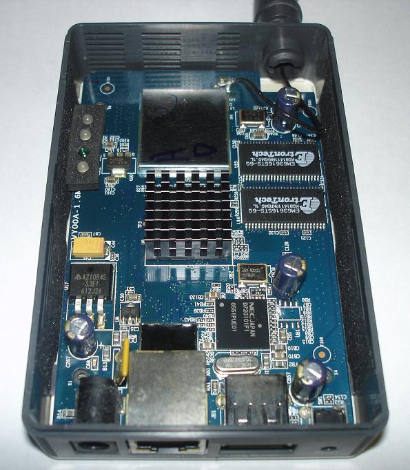

    Well I finshed a few hours ago here are some pics.
    I also took a pic of one of the bad caps.
    Oddly enough one of the caps with it's bung pushed out as pictured measured 8.6 ohms or so on the ESR meter but the other one measured 86 ohms .
    Very basic recap there are only 4 caps on the board all of them are 100uf one of them was 16 volts while the others were 25 volts. I replaced them all with 25 volt caps.
    Originally mini lytic caps were used but full size Panasonic FCs fit just fine with space to spare.
    I couldn't get the series of the original caps since there was no series printed on them.
