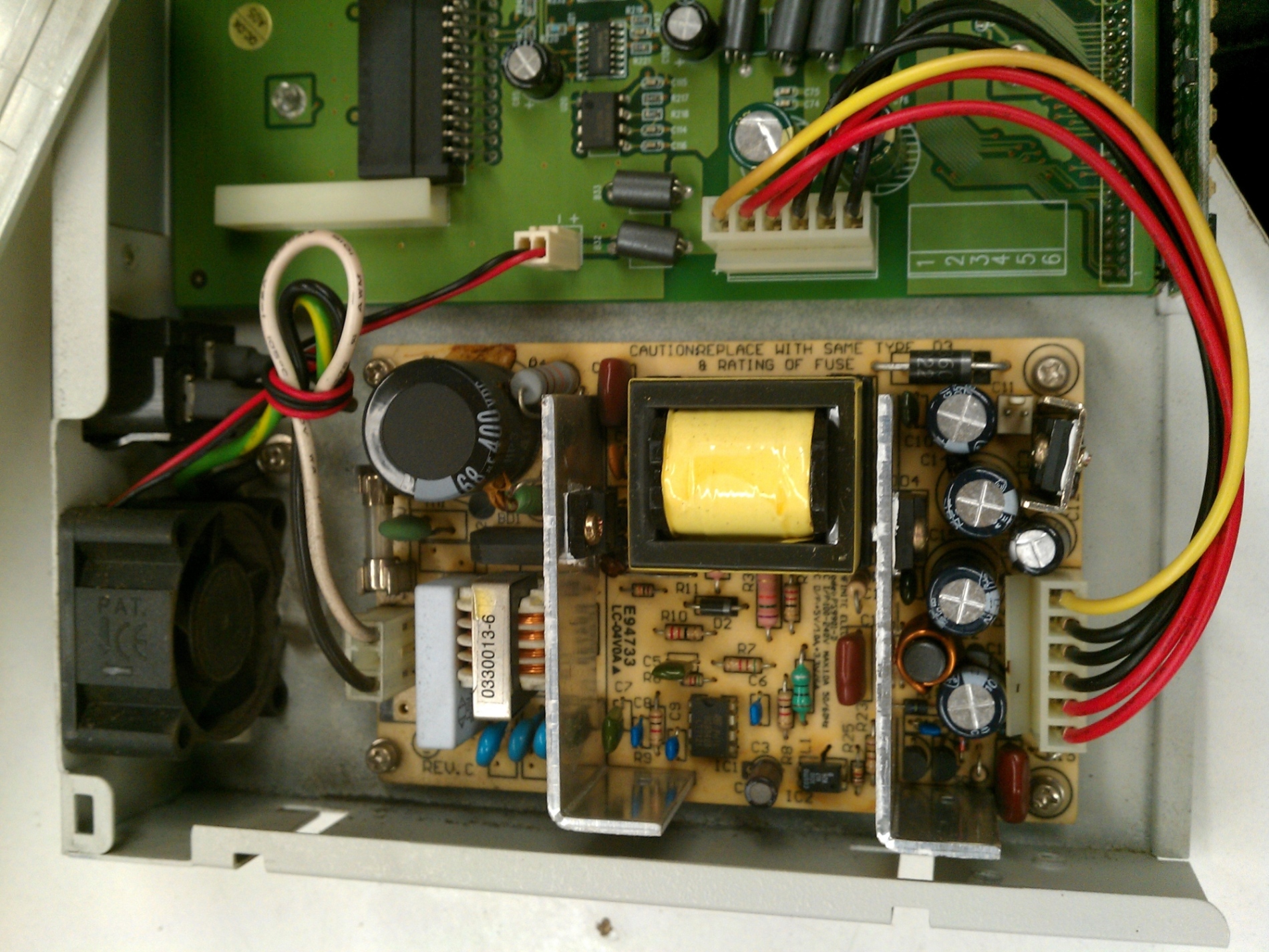

    once it is plugged in the power/LAN lights all go on, then off, then on, then off, then on, then off, very rapidly. You get the point.
    On the connector from the power board to the main PCB, (analog multimeter black probe on black connector, red probe on red connector), it bounces up and down at about 1 volt. No visible bad capacitors. Ideas?

    Re: Linksys EF2S24, V2 not working
    Pictures of the board would help.
      I've attached a picture of the power supply.
      The secondary caps are Ltec. 2x 2200uF 10V and 2x 1000uf 10V. Even though they look fine, is that the first thing I should do, replace them?
      Please look at picture and advise :-)
      Oh and there is a slight click, click, click coming from the PSU.
          That is the PSU trying to startup.
          I would suspect either
          1) bad SMPS chip (IC1)
          2) bad electrolytic startup cap (the one between IC1 and IC2)

          • retiredcaps
            • Apr 2010
            • 9271
            3) Measure the DC current across that startup cap. Is it steady or fluctuating?
            4) What is the part number of IC1?
              The little Taicon 47uF 25V? Should I try to replace that?
                                Important new discovery:
                                I put the power board sideways to get easier access to the measuring of the startup cap. Well, it did the clicking thing a few times then it fired up and STAYED ON...
                                I plugged in an ehternet cable and it seemed to work!!!
                                Why? What does this mean?
                                  Maybe bad soldering? Inspect the back side of the board especially near the TO220 chips (the ones with three leads) and the bridge rectifier the rectangular thing on the left of the large transformer.
                                  Also, as you mention clicking... that could be from a relay and it just so happens that white rectangular thing in the lower left corner looks like a relay and the two wires going into the socket near it seem to come from the mains.
                                  The relay may be bad or the soldering at the bottom may be bad (could be due to some short that fuse didn't protect it from)
                                  Inspect the back side and report.
                                    The soldering looks great. However, when I shake the thing, there is a rattling sound. I think it's coming from that corner. Might that have something to do with it?
                                    By the way, I screwed it back down and now it seems to work. But, it does do the clicking thing once or twice before starting up, about half of the time when I plug it in...
                                    That white rectangular thing is marked CX1. I think it's an X capacitor on the input filtering.
                                      Alright new progress: I bend the startup cap a little to the side so I could measure the legs.
                                      Bounces up and down while it flickers on and off. Voltage seems to bounce around near 12V
                                        To re-summarize:
                                        The "starup cap" that was mentioned previous does have the voltage bouncing up and down while the power cycles on and off rapidly. Would that suggest that it's something on the primary (before the startup cap?)
                                        I'm still interested in fixing this.
                                        Please help.
