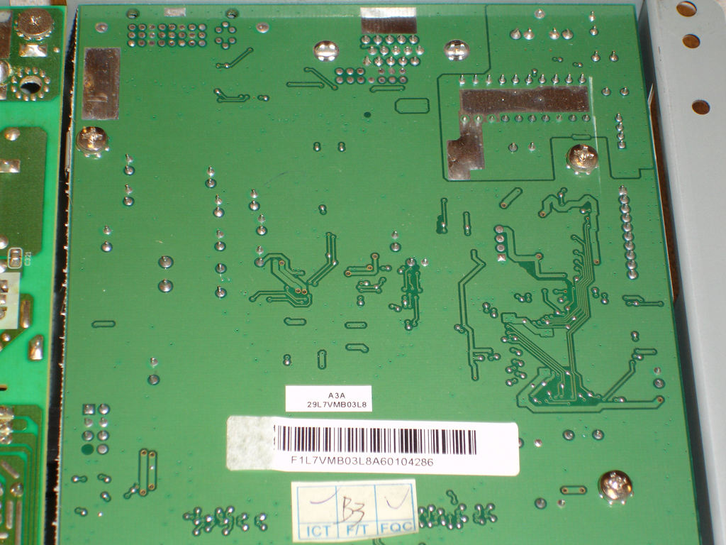

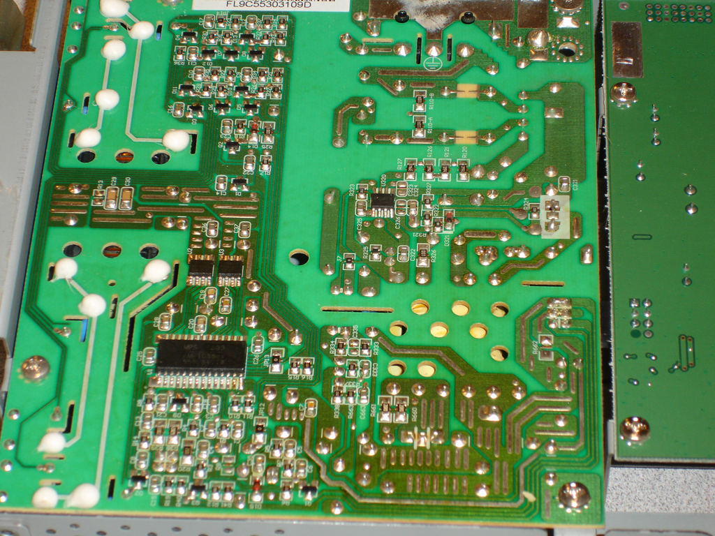

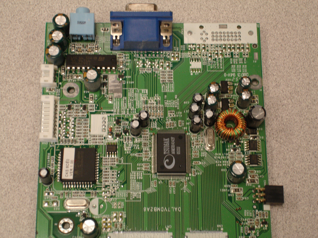

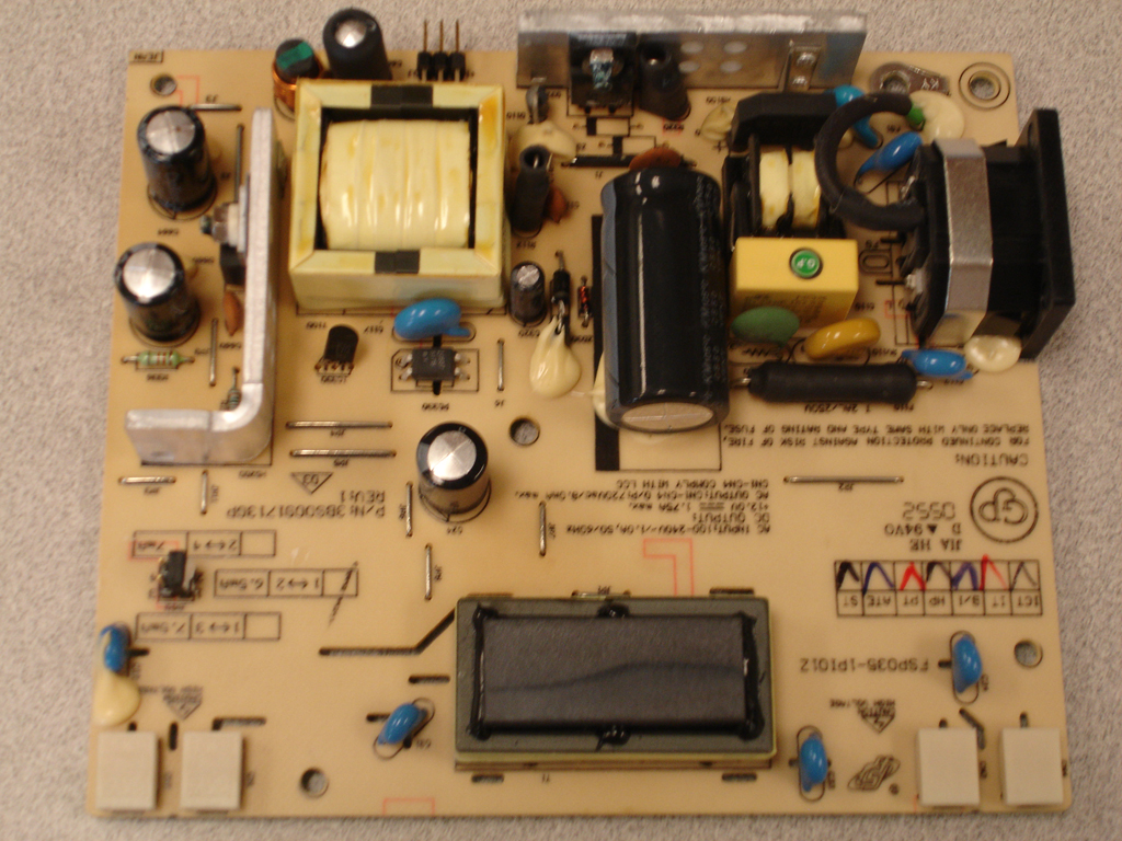

          Re: Acer AL1914
          here the pix

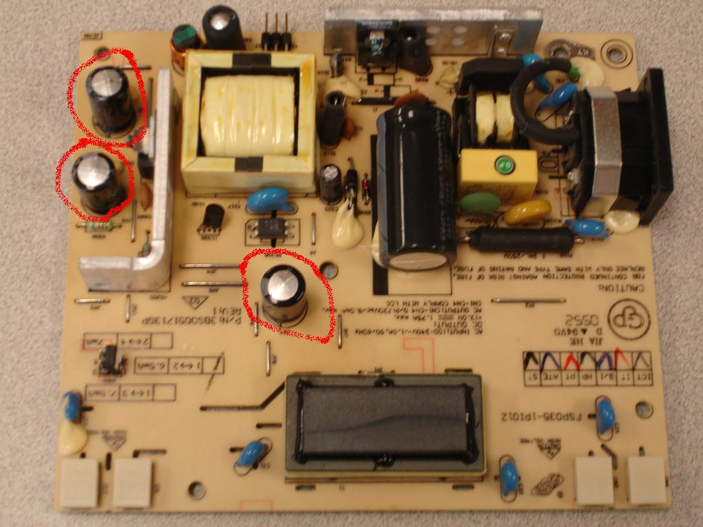

            Re: Acer AL1914
            Originally posted by adevgeek
            here the pix
            Well, for sure you have at least 5 bad/bloated caps. See my marked up pictures.
            Replace them with caps from this list.
            https://www.badcaps.net/forum/showthread.php?t=2280
            If you are in the USA, you can order from digikey.com and use Panasonic FM series if you follow instructions below.
            https://www.badcaps.net/forum/showpo...33&postcount=2
            edit: Most here will recommend that you replace ALL the caps since at least 5 of them went bad and the others may be bad as well even though there is no visible bloating. Caps can still be bad with bloating. They can have out of tolerance uF or high ESR (ohms).
            Recapping everything should cost less than $10 USD.

                Re: Acer AL1914
                I'm gonna order them and will try in my next days off (Monday and/or Tuesday), i will notify you guys if the problem got solved
                thanks
                The cap with the "K" vent just right of the inductor coil (green with copper windings) might be a Rubycon cap. You can leave that one installed if you want.
