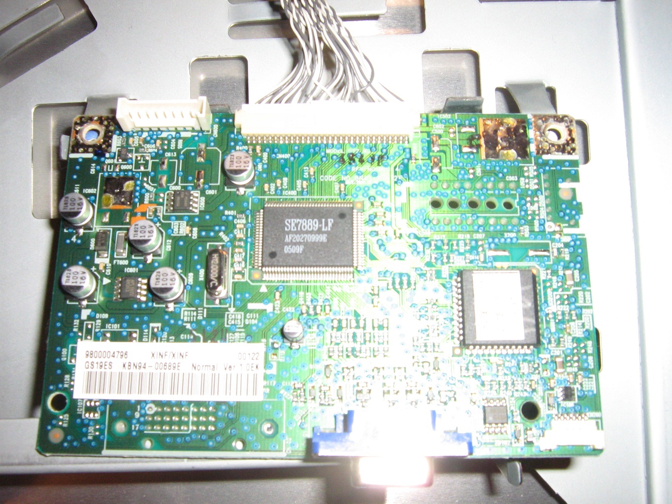

      The model is a SyncMaster 913V 19inch

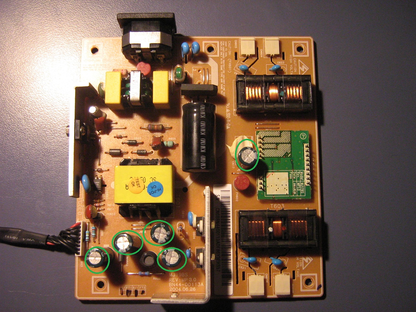

      Here are some photos, the capacitors circled with green are all Samxon brand and have been checked.
      There is nothing wrong with the PC that I plugged into the monitor either, it has been used with many other monitors just fine.

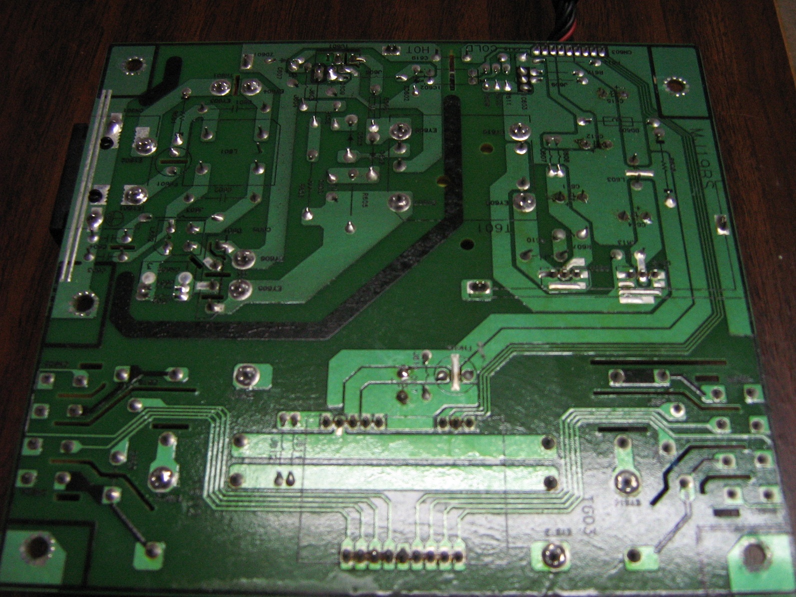

        Forgot to post pictures of the back, sorry about the quality, my cameras not great..
        Nothing much to see on the back of the logic board, no components and all solder joints are clean etc

          Re: 19 inch samsung powers off when VGA plugged in.
          Can you clear for my on second picture at righthand corner had burned mark?
          If so the VGA board is bad, had short to ground when you plug VGA cable & shut off monitor.
          • mockingbird
            • Dec 2008
            • 5484
            You see the chip that says SE7889-LF?
            It is defective. There is no way to fix this monitor. Even if you replace the caps.
              Thanks for the reply's, The top of the board does look like it is burnt in the photo however it is actually fine. Is it still likely that the chip is defective though?
              • seanc
                • Nov 2008
                • 1319
                You could replace the chip though.
                  Read this article. Same exact problem - solution is what mockingbird said.
                  http://ezinearticles.com/?Samsung-71...blem&id=458167
                  This will be hard for a novice to replace. There is one chip being sold on ebay (ebay item number: 250646876175). That is, if you dare to try. But then again, the chip is being sold for $20. Is it worth $20 to fix this monitor?? MAYBE - Then again, it is a samsung!
