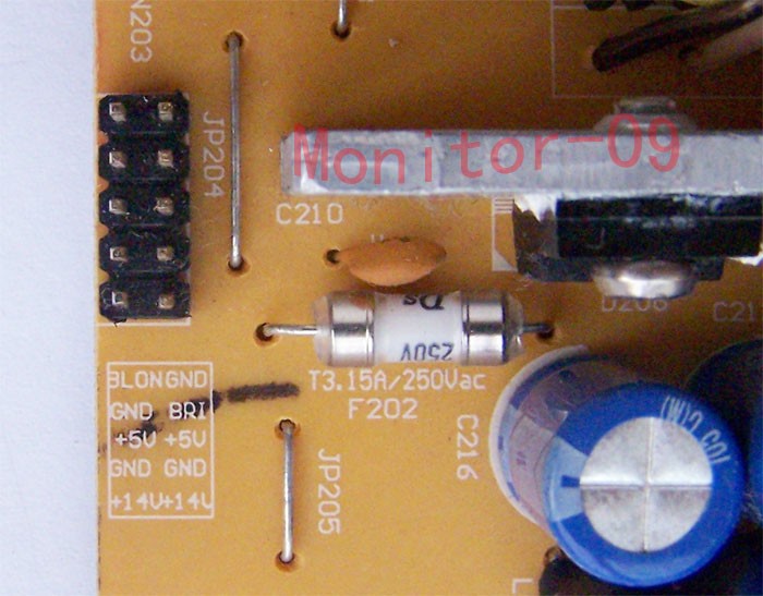

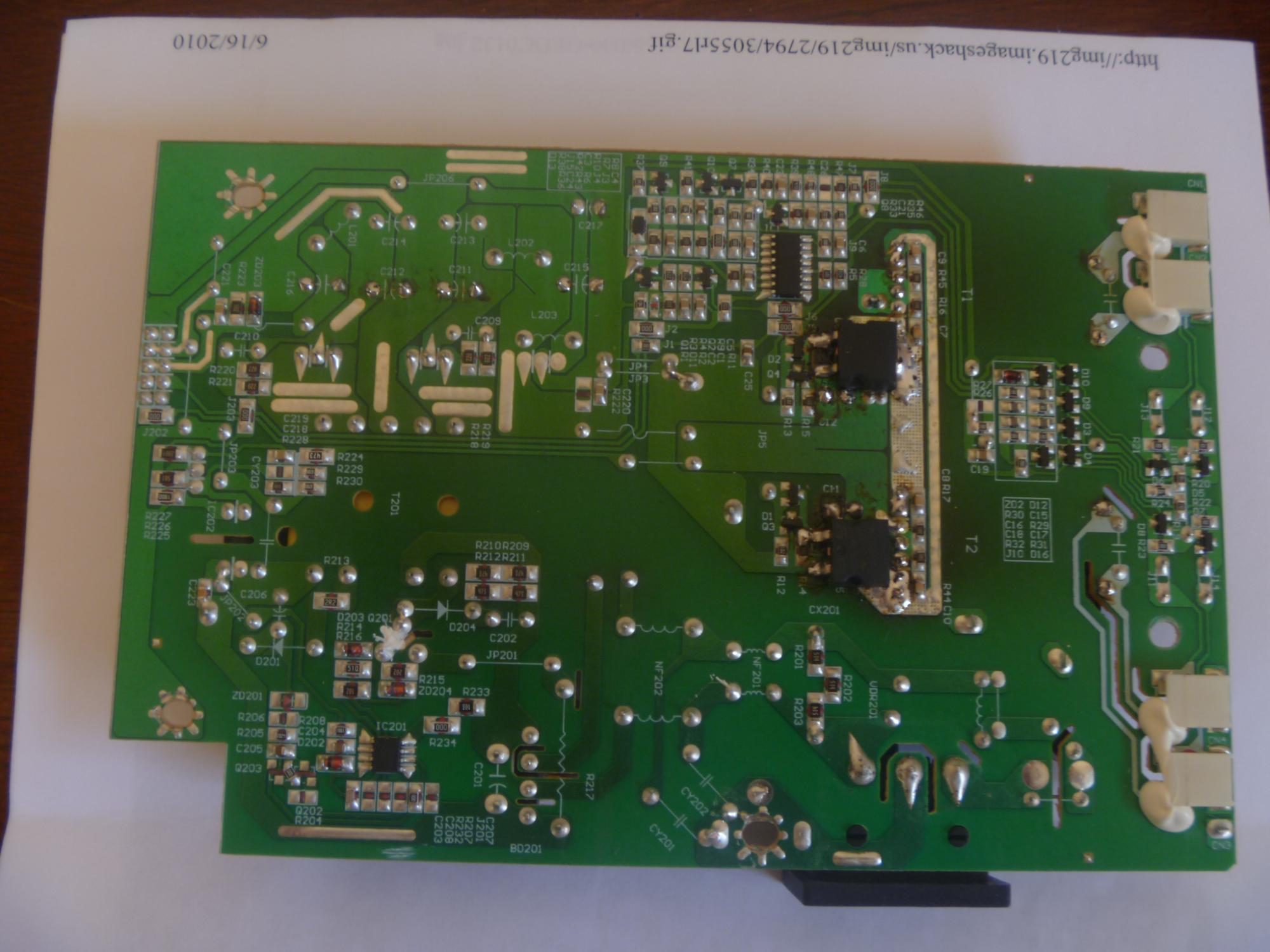

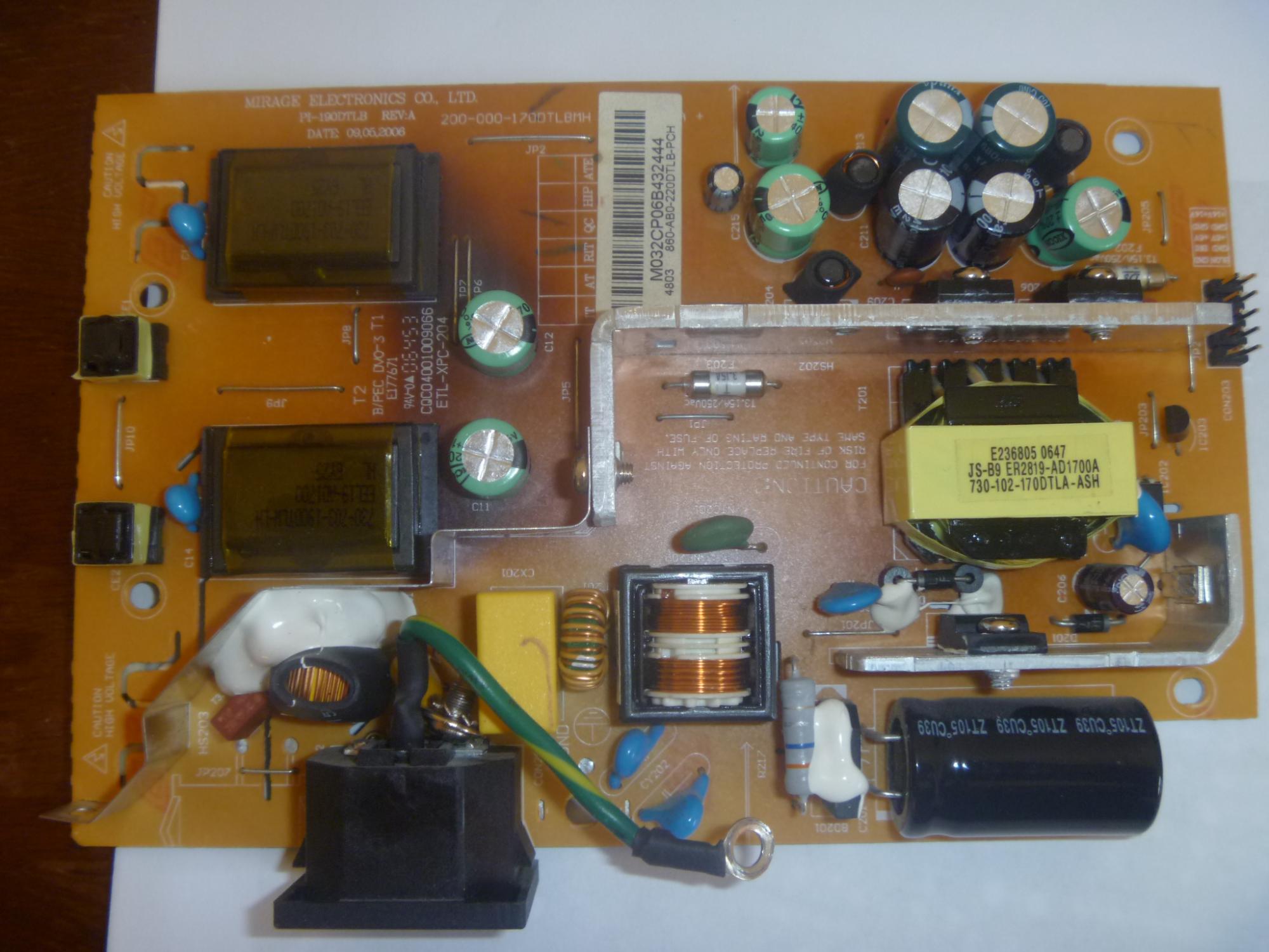

              Now I replace 2 Tip3055 transitor now powerlight on but backlight turn on about second & off. Find out top backlight is on & bottom not on that why is shut off run out option need held
              Here the top & bottom board picture
              • retiredcaps
                • Apr 2010
                • 9271
                Re: KDS Business K Series K22mdwb not turn on
                Try testing both transformers as per step #4
                https://www.badcaps.net/forum/showthread.php?t=10419
                Compare all measurements. The 2 transformers should be very close or identical.

                • ecking767
                  • Oct 2009
                  • 492
                  I'm 100% percent sure you have replace your output transistors with the wrong part. TIP3055 is a transistor, On that particularly board the output transistors are MOSFET. Here is the part number PHD3055E
                  http://www.alldatasheet.com/datashee.../PHD3055E.html
                  I have seen this board using a AOD444 for the output transistor too..
                  please confirm..

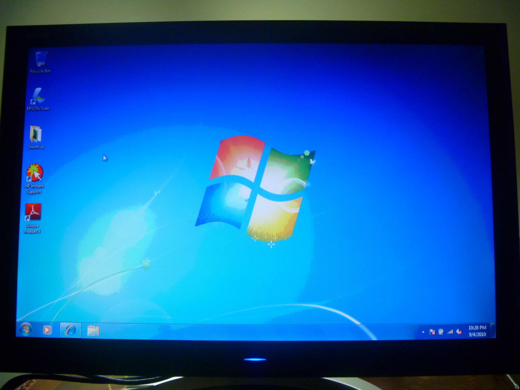

                                I find another power/inverter board with some bad cap (replace all new cap) now I had another problem the screen not right color
                                I take some picture, some one help me
                                thanks
                                • seanc
                                  • Nov 2008
                                  • 1319
                                  If you're referring to the gradients showing as banding, check your display properties are set to use 32bit colour.
                                  • hoadle
                                    • Jul 2010
                                    • 174
                                    I check all setting & follow to display color calibration but still the same (if thay had goog picture & can't see text + display dark)
                                    Need help
