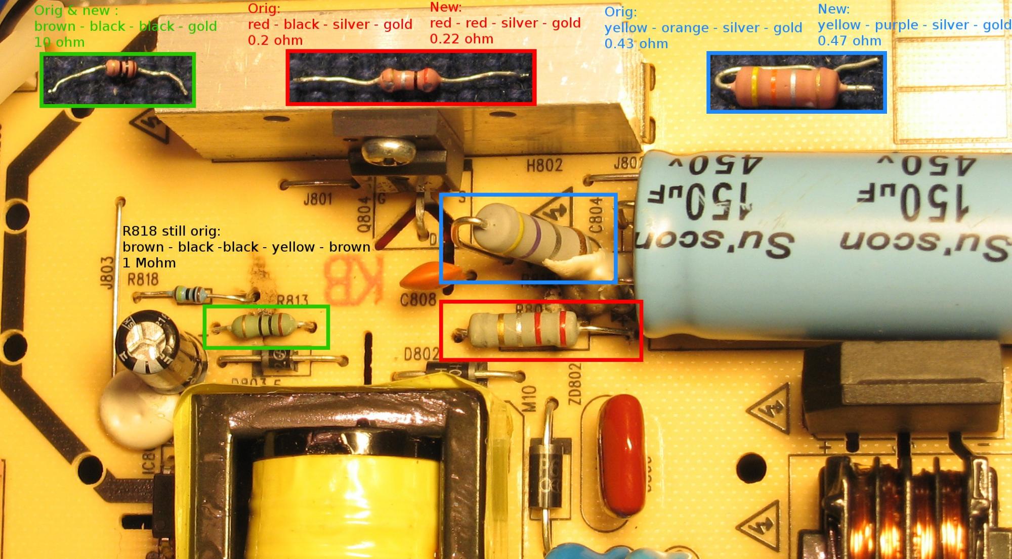

            Re: LG 22W2234S troubleshooting and spare parts
            I also thought the change in voltage must be due to resistors. However, all resistor values in the pcb section related to LD7522 seem fine to me (measured off-circuit). See the attached image for details.
              See if d803 is shorted?
