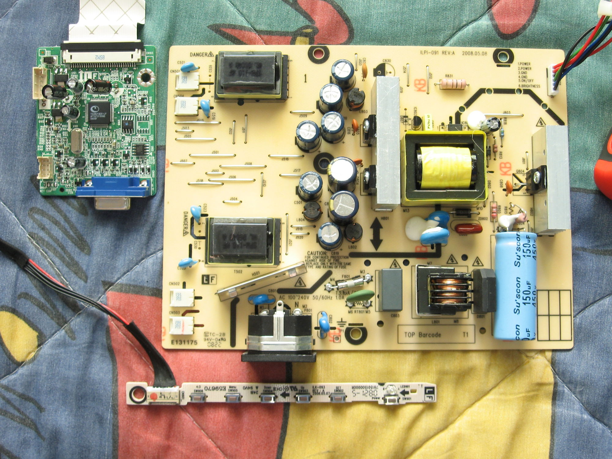

    I took a look inside. Previous owner had already attempted to fix the display by replacing electrolytic capacitors (excluding the one big fella) on the power pcb. Only thing that caught my eye was that many solder spots had pretty dull surface hue just like cold joints. Everything seemed to be firmly attached though.
    The fact that the display power stayed on for several minutes straight before losing both image and led power seemed to suggest the origin of this problem is located somewhere on the right half of the pcb.
    Next I began measuring voltages from the IC near the upper-right corner on the back side (note that I've swapped the back side image to help with visual component alignment), before and after the power-out phenomenon. I got some value differences measured before - BANG, I must've accidentally shorted two pins with a dmm probe, successfully rendering at least three resistors and the damn IC dead
    Now I'm short a 2-watt 0.43 ohm metal film resistor and a LD7522PS IC. They seem pretty hard to find online.
    Any help to find spare parts and thoughts on where the source of the original problem might be much appreciated. Maybe I could add two of these parallel as a replacement resistor (0.5 ohm vs 0.43 ohm)?

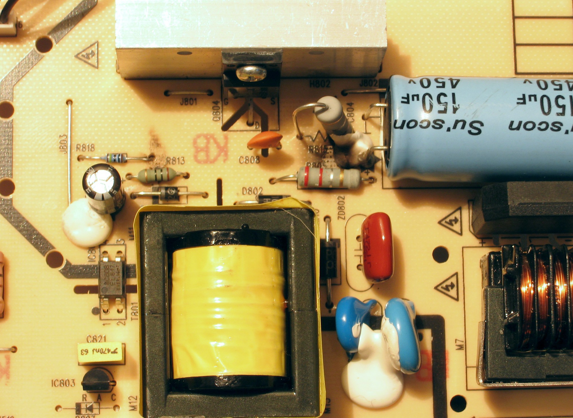

              Ok, I got the replacements. Install the IC and resistors. Connect power - BANG! Oops, I mixed resistor places. Replace resistors with correct placing, connect power - BANG! Oops, shorted due to having forgot to trim the legs after soldering. Good job. At least the IC is still intact.
              After I finally got everything set up, the red-red-silver-gold resistor keeps still blowing up at the moment power is connected. Something I haven't yet noticed must have also gone wrong when the IC was shorted
              The original R805 was carbon 0.2 ohm, the new one is metal oxide 0.22 ohm. The original R815 was 0.43 ohm, the new one is 0.47 ohm. I assume these modifications should not cause the explosion? I'm a complete beginner in electromagnetics so what comes to troubleshooting the problem....well, not going to happen on my own. Any ideas what to do?

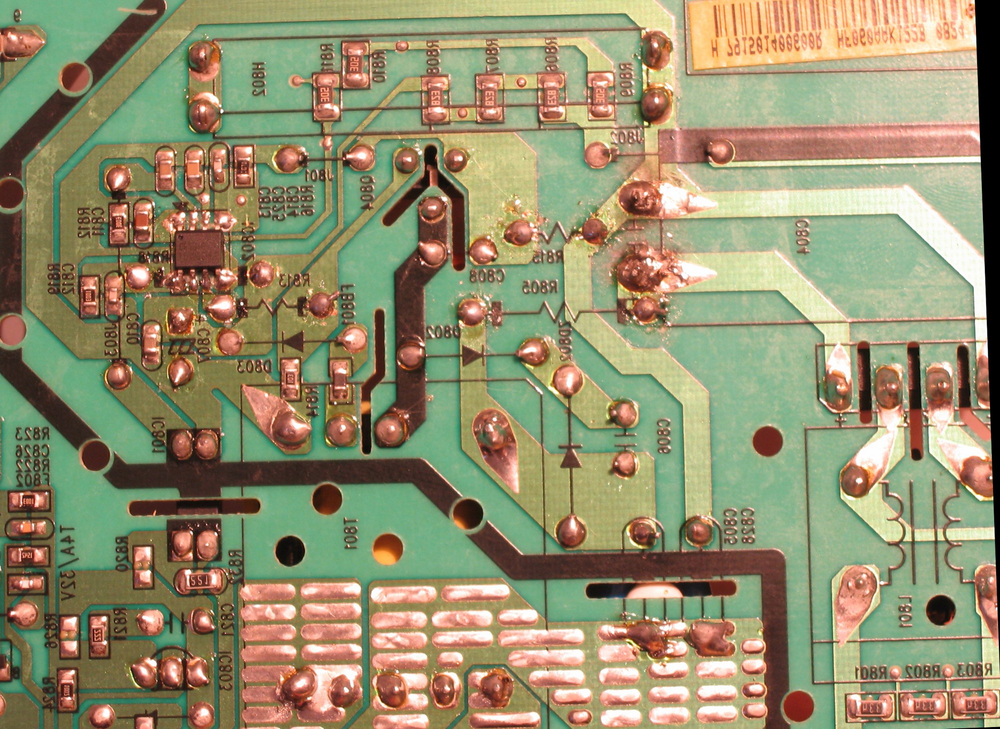

              Attached are close-ups of the area where the culprit probably must be. I've again swapped the back side shot so following signal routing should be a bit easier.
                You need to slow down and double/triple check your work. Rushing leads to mistakes. Luckily this time, there was no damage, but next time you could be reaching for the fire extinguisher or checking into the emergency room.
                Check ZD802 to make sure it is not shorted. And check D802.
                  Both diodes appear fine. I'm getting one-way reading in DMM diode measurement setting.

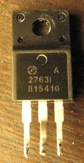

                                I couldn't find datasheets or anything with the exact code (2763I ?) on the component. Maybe this is the one? http://www.digchip.com/datasheets/pa...763-01-pdf.php
                                This might be the datasheet for 2763
                                http://pdf1.alldatasheet.com/datashe...SK2763-01.html
                                If correct, now you have the correct specs to find a replacement.

                                  Actually, I found a thread on google. The correct mosfet is http://www.a-power.com.tw/ProductDetails.asp?M_ID=157 . Unfortunately they are pretty hard to find
                                    Re: LG 22W2234S troubleshooting and spare parts
                                    How about this for a replacement?
                                    http://search.digikey.com/scripts/Dk...e=FQH8N100C-ND
                                    Maybe send digikey an email with both PDFs and ask them if they think it will work. If not, ask them to make a suggestion.

                                      Thanks for the link. Good news: I found a Chinese eBay seller who had AP2761I-As for sale. I sent him a message about if he could get AP2763s and got a fast response saying he's already got them and that he can list them right away. I already purchased two, just in case. I'll have to get back to this topic once they arrive which is probably going to take another two weeks.
