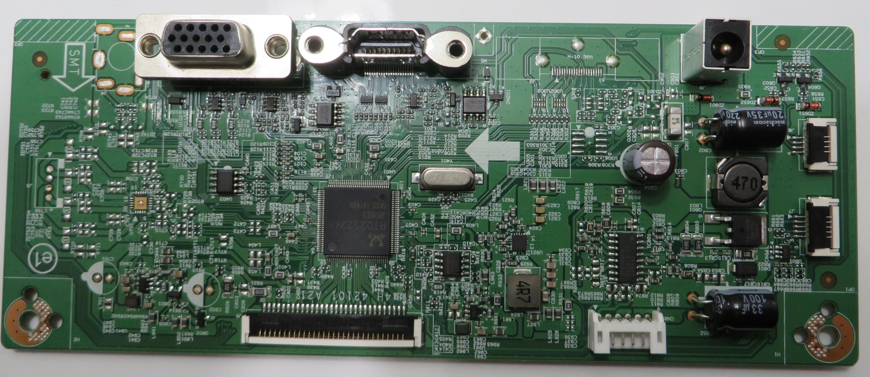

    I have an Asus VL279HE, PCB model is 4H.42101.A21
    The symptom is that there's no power at all with it with the AC adapter hooked up. The fuse tests ok, but when the AC power adapter is connected, I do not get a voltage reading with my DMM from the pins on the back. The connector itself tests ok, which leads me to conclude that there's some short on the board which is triggering protection in the AC adapter and causing the voltage to go to 0.
    I am not certain where to start looking beyond the fuse though.

    Re: Asus VL279 (VL279HE) - possible short?
    Rather, the problem is in the power supply itself (electrolytic capacitors) does not hold the load and the power drops from it.
      No, that can't be it, I tried 3 different known good adapters. I'll try replacing the NIKOS PA410BD TO252 MOSFET.
          Could be a bad DC jack too. Measure for a short at that DC jack, or from the fuse to ground.
