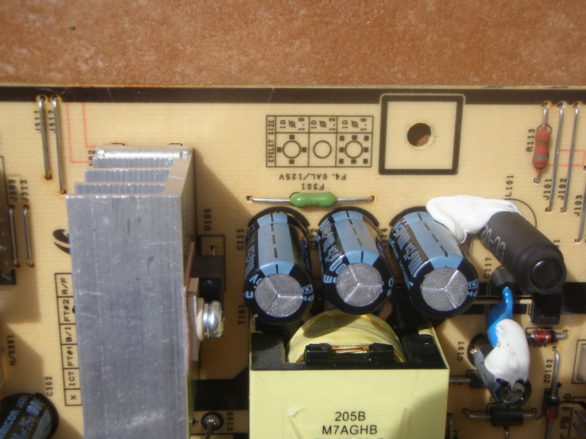

      Re: Samsung 2232bw recaped and still nothing
      Hello

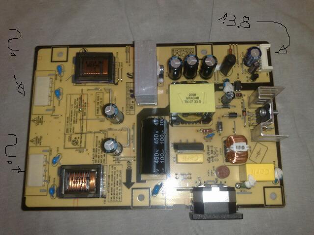

      Sorry about the missing info.
      So it is like this. As you can see on the photo I had recapped 5 pieces. And before there was not a sign of life at all but now the blue LED on the on/off button goes on and stays on when a plug it the ldc in. The button does not respond if I push it.
      I had instaled Jamicon 1000uf 25V 105 C.
      The voltage on the conector that goes to the other circuit board is 13.8V. Is this good? What voltage should be on the other conectors?
      Bye

          It depends on the monitor, but some logic boards will list the voltage right on the PCB.
          Other typical voltages found are 3.3V, 5V, 12V, and 19V. A few pins might be GND.

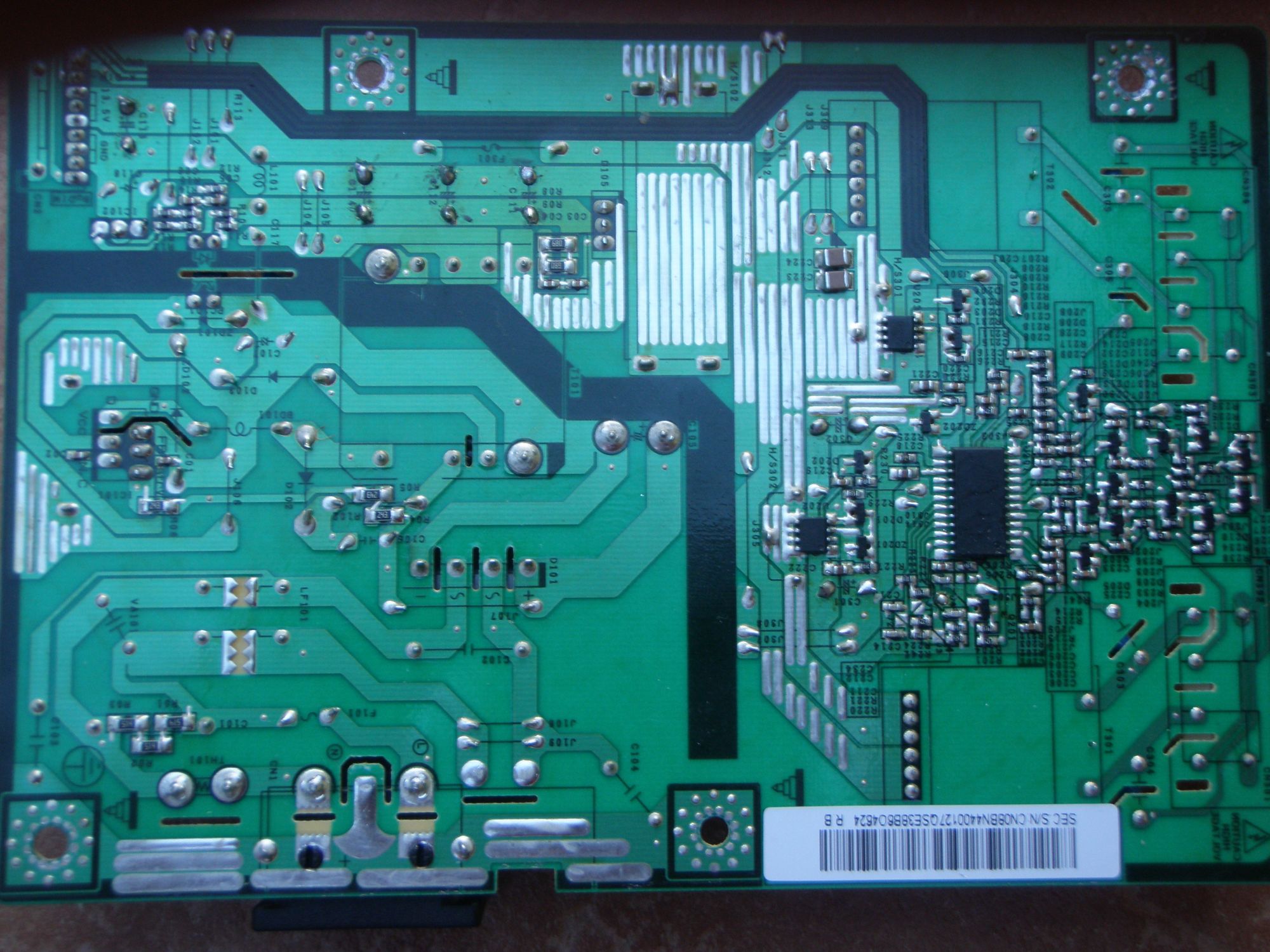

              Hello

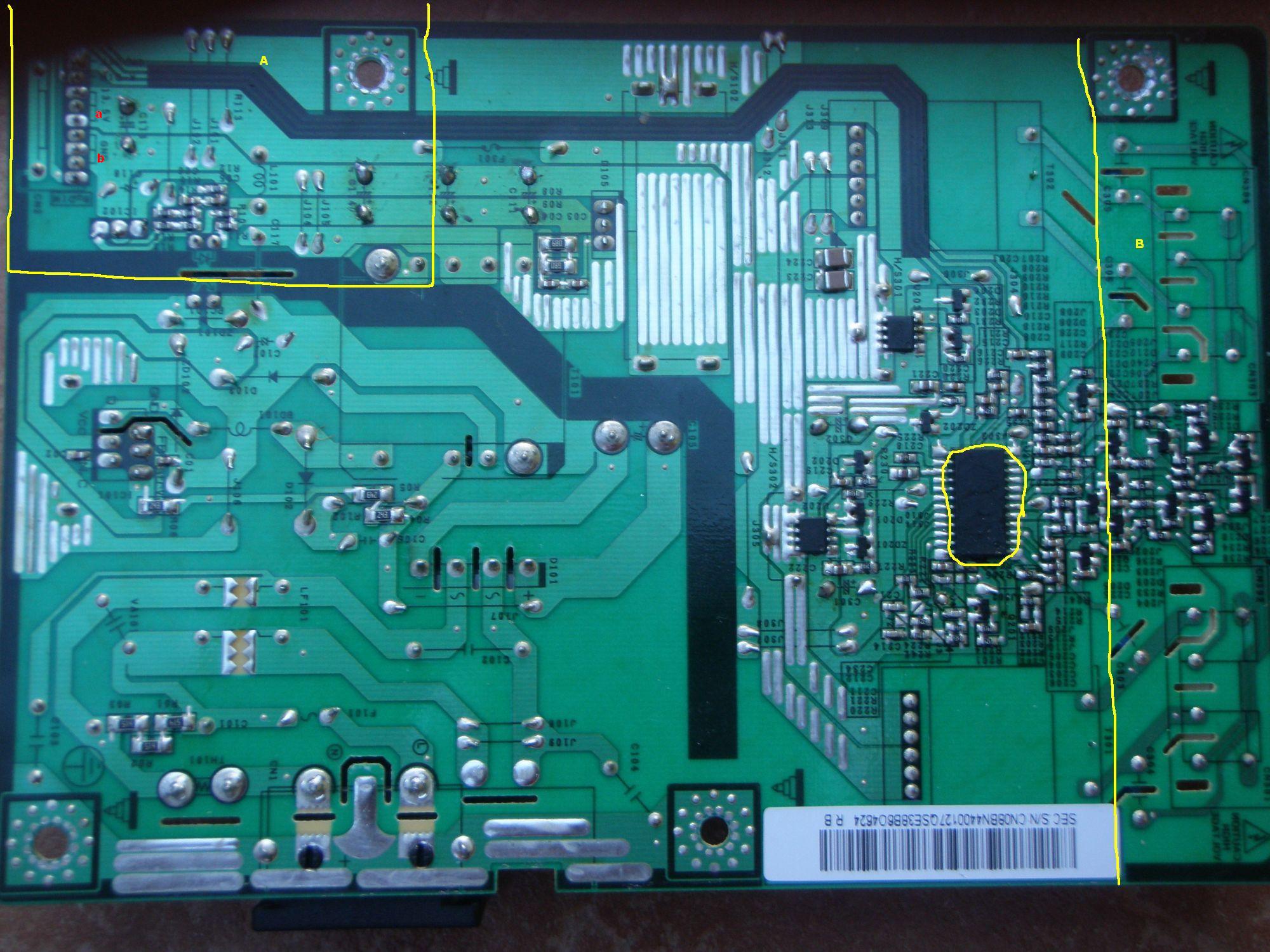

              So here are the pics. Good enough?
              Please help.
              Bye

                The pictures are very good. Unfortunately, you may have missed a couple of important areas. First of all, what is the voltage between the two point I have marked in red as 'a' and 'b'? It should be 13.5 volts.
                Second, recheck your connections, particularly the cable connecting to that connector. Also, make sure the cable from the switches on the front panel is properly seated at the logic card.
                If you need additional help, I would like a picture of the upper left area of the bottom of this board - the area I have outlined in yellow and labeled 'A'.
                  PlainBill
                  Yes the voltage is corect, it is 13.7V and on my volt meter that is about 13.5V.
                  Should I measure anything else?
                  The logic card is the circuit board on witch you connect the DVI or VGA cable, yes?
                  More pictures tomorow when there will be sun light.
                  Bye

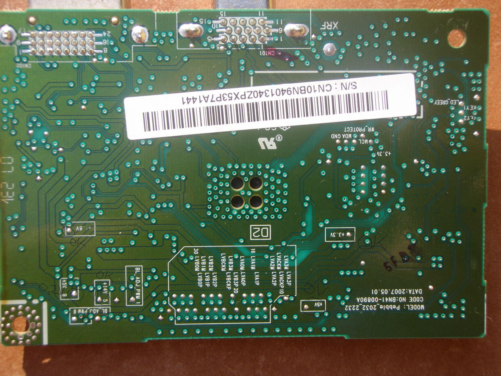

                      PlainBill

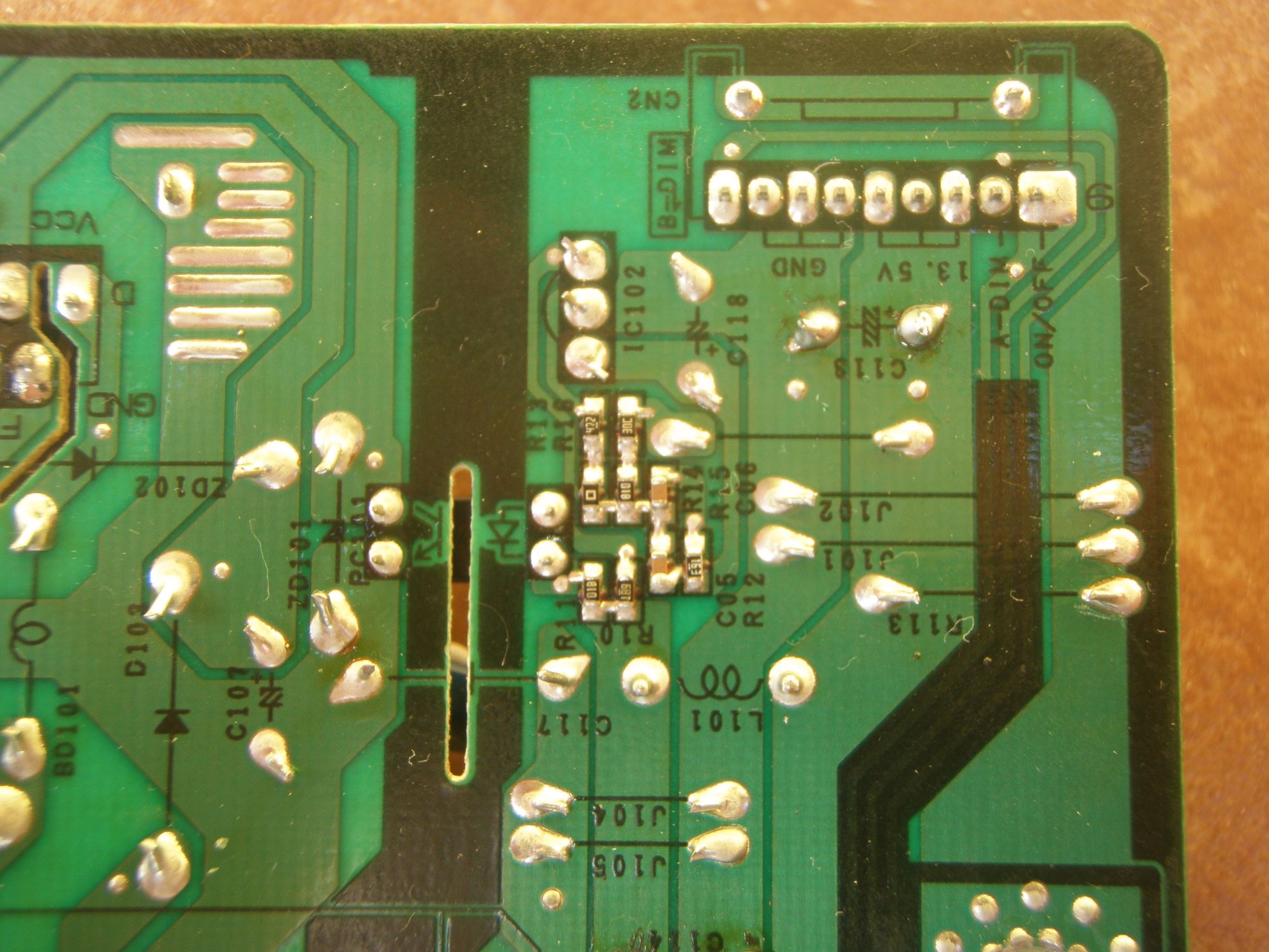

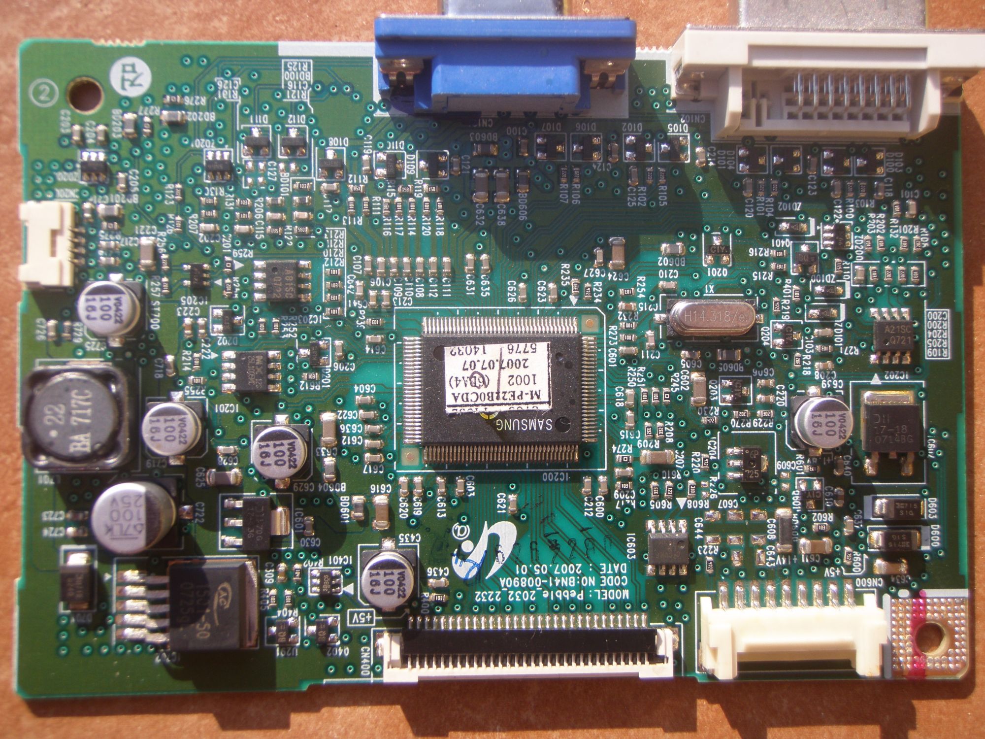

                      Ok here are additional pics.

                        • Slovenia
                        I have some more infomation.
                        I took out one cap from the three in a row, and nothing changed
                        I took out two caps from the three in a row, and nothing changed
                        I took out all three caps from the three in a row, and the voltage fell to about 4V and the blue led started to blink real fast (much faster then in the standby mode).
                        Hope it helps.
                          And one more question.
                          On this picture, must there be that voltage on that pin by witch it is writen?
                          Bye

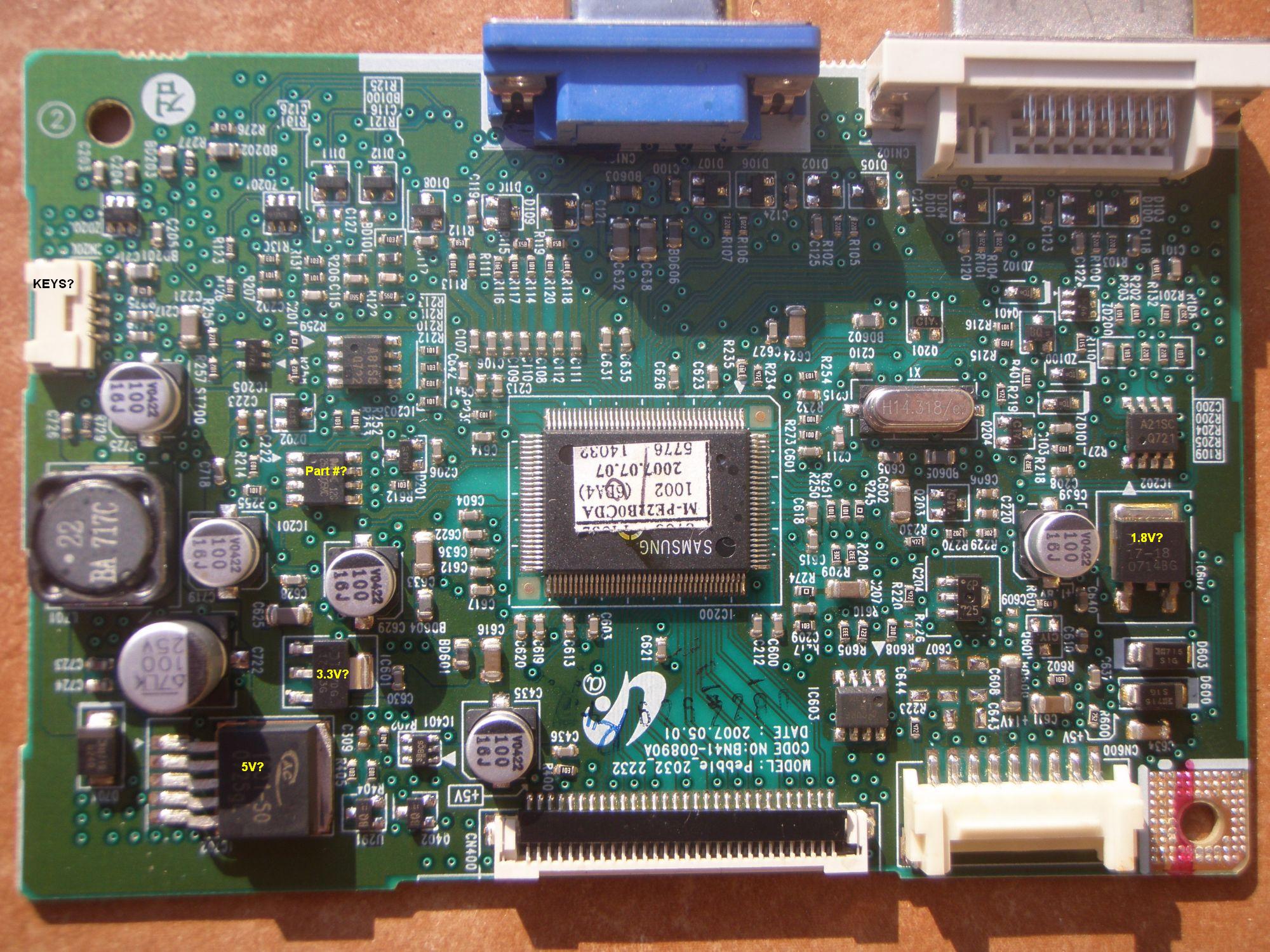

                            Very good!!! I had requested a picture of the top of the logic board so I could identify test points. You have found them for me.
                            Yes, the indicated voltage should be present at those points. One or more of them missing could be the cause of the problem. Also, on the right side of the picture are points Key1 and Key2. The voltage at those points should change when you press a button on the front panel.
                            PlainBill
                              PlainBill
                              As you see on the picture, the 5V points are not good. One has 0.2V and the other 0.0V.
                              And yes, if press the on/off button there is a change of voltage on the pin Key 1 but on the pin key 2 it stays the same.
                              Any ideas what is wrong?
                              Bye

                                Most likely there is a bad voltage regulator. I will need a picture of the top of this card to identify them.

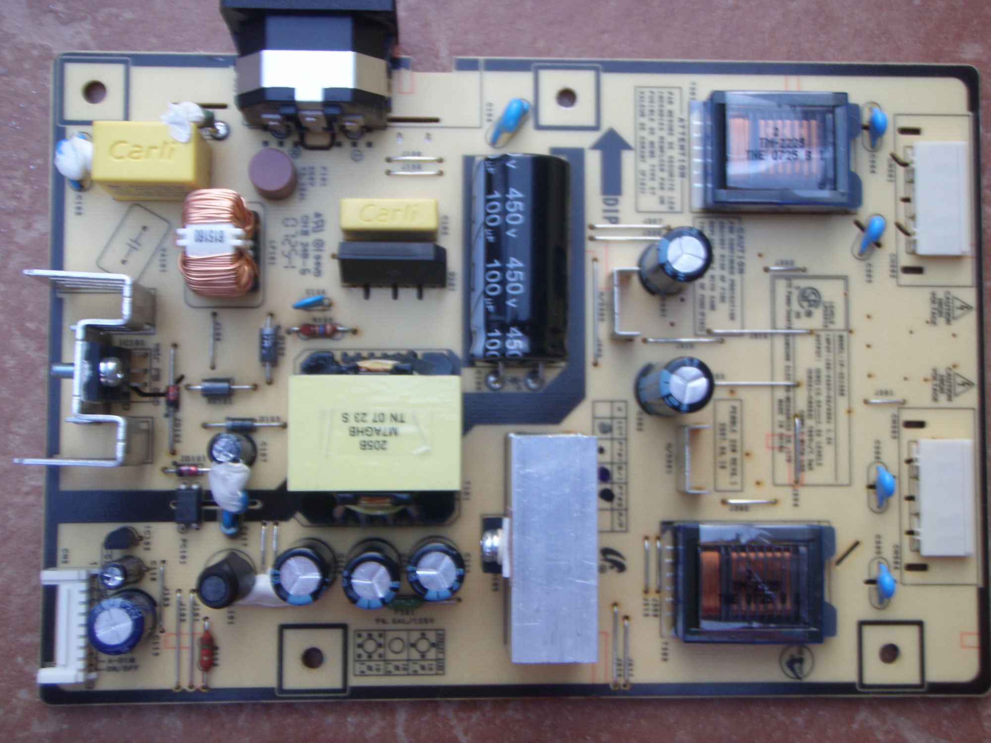

                                • benobeno
                                  • Jun 2010
                                  • 25
                                  • Slovenia
                                  PlainBill
                                  Here it is.
                                  • PlainBill
                                    • Feb 2009
                                    • 7034
                                    Originally posted by benobeno
                                    Here it is.
                                    Wow!! Fast and excellent quality.
                                    I've identified the ICs I believe are responsible for various voltages. There are a number of things I would like you to check. Use the pad around the mounting screw hole in the lower right corner as ground for your meter.
                                    1. CN600 in lower right corner. What are the voltages on each pin? (Choose which end you want to start with and let me know).
                                    2. There seems to be 5V and an arrow pointing to the anode of D600. What are the voltages at each end?
                                    3. 5V? regulator in lower left corner. What are the voltages on each pin and the tab? The arrow pointing to the topmost pin indicates pin 1.
                                    4. 3.3V? regulator. What are the voltages on the three pins (I think the tab is connected to pin 2).
                                    5. IC201 (marked with Part#?) What is the part number?
                                    6. Connector marked Keys? What are the voltages on each pin? Do any of them change when you press the front panel buttons?
                                    7. 1.8V? regulator. What are the voltage on the pins?
                                    8. Check the cable from the keys connector to the front panel very carefully for any broken wires.
                                    PlainBill
                                      1. From left to right
                                      3,4V 0V 0V 0V 13,8V 13,8V 13,8V 0,15V 0,20V
                                      2. The end that the arrow shows is 5,2V and the other end 4,6V
                                      3. From up to down
                                      13,8V 5,1V 0V 5,2V 0V and the tab 0V
                                      4. From up to down
                                      0V 3,3V 5,2V and the tab 3,3V
                                      5. Part name
                                      MX 12G 25L1005MC
                                      6. From up to down
                                      0,7V 1,8V 1,8V 0V
                                      On the second pin from the top changes when I press the on/off button or the middle, right or left button.
                                      On the third pin from the top changes when I press the other remaining buttons.
                                      7. From left to right
                                      0V 1,8V 3,9V and the tab 1,8V
                                      8. Checked and all seems to be ok.
                                        3. From up to down
                                        4. From up to down
                                        5. Part name
                                        MX 12G 25L1005MC
                                        6. From up to down
                                        0,7V 1,8V 1,8V 0V
                                        That is not good news. It's time to search for a service manual or schematic. I am afraid that the problem is the processor chip has died.
