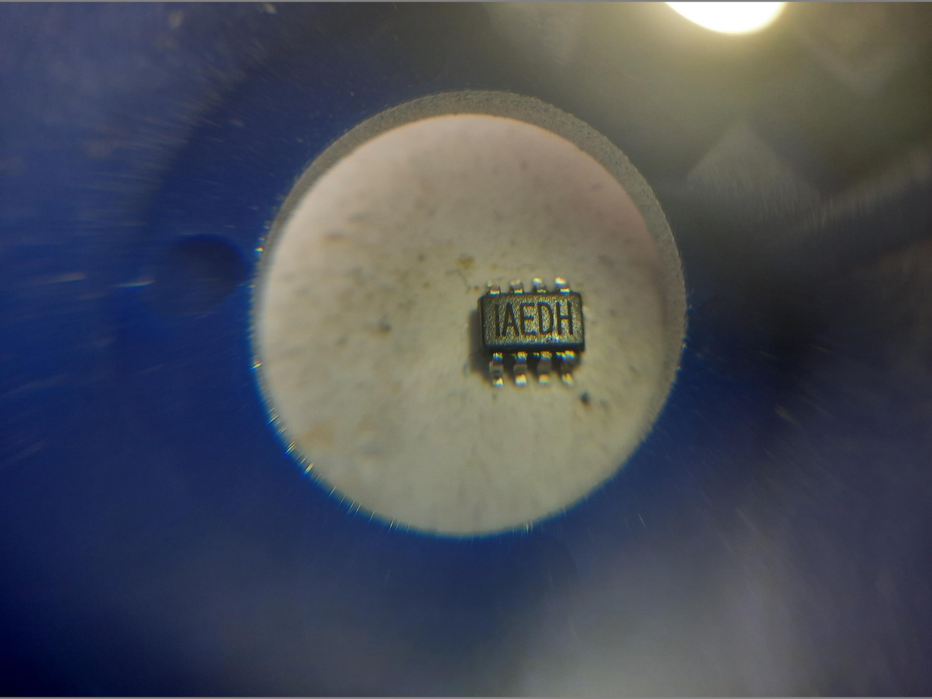

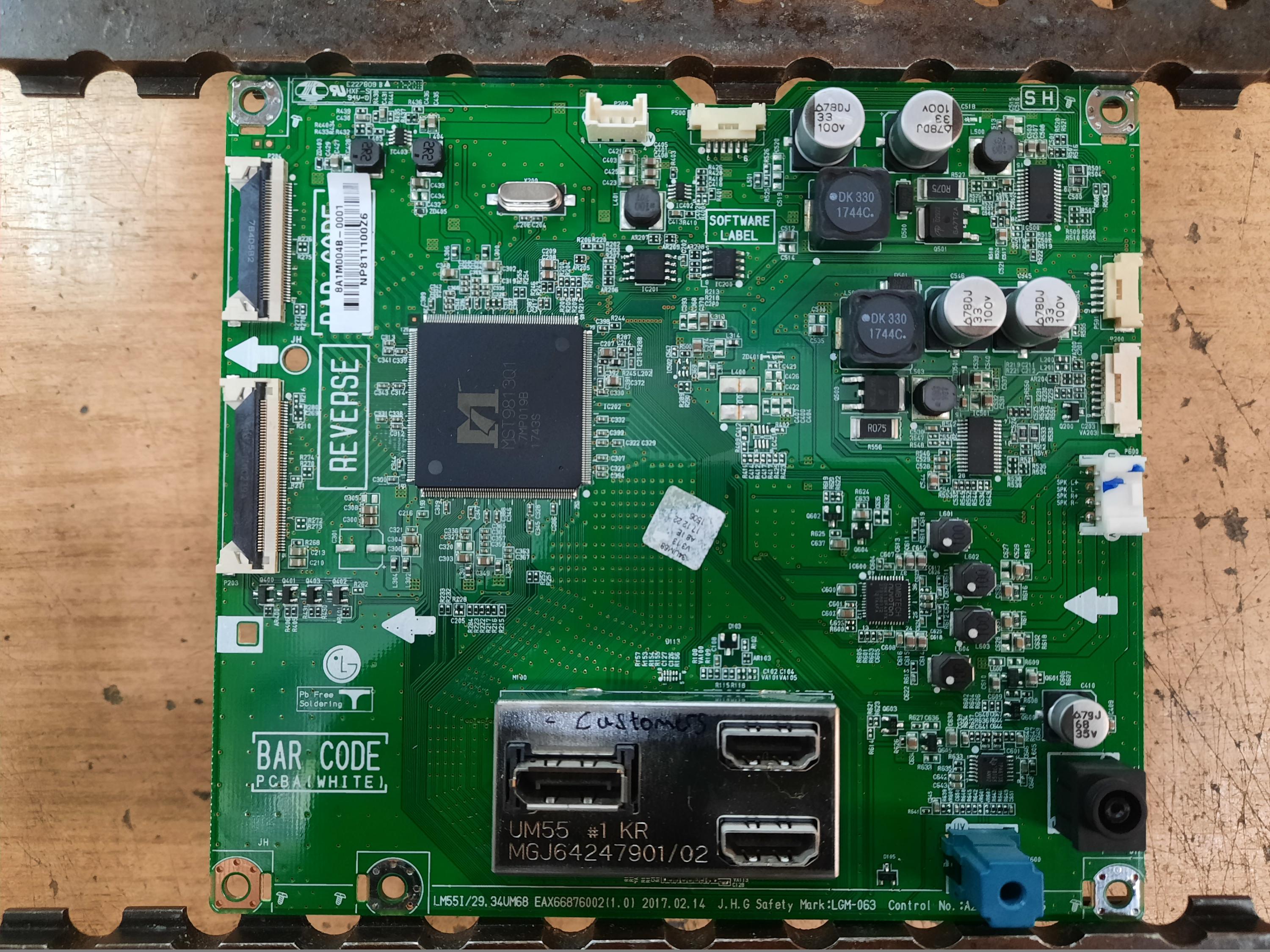

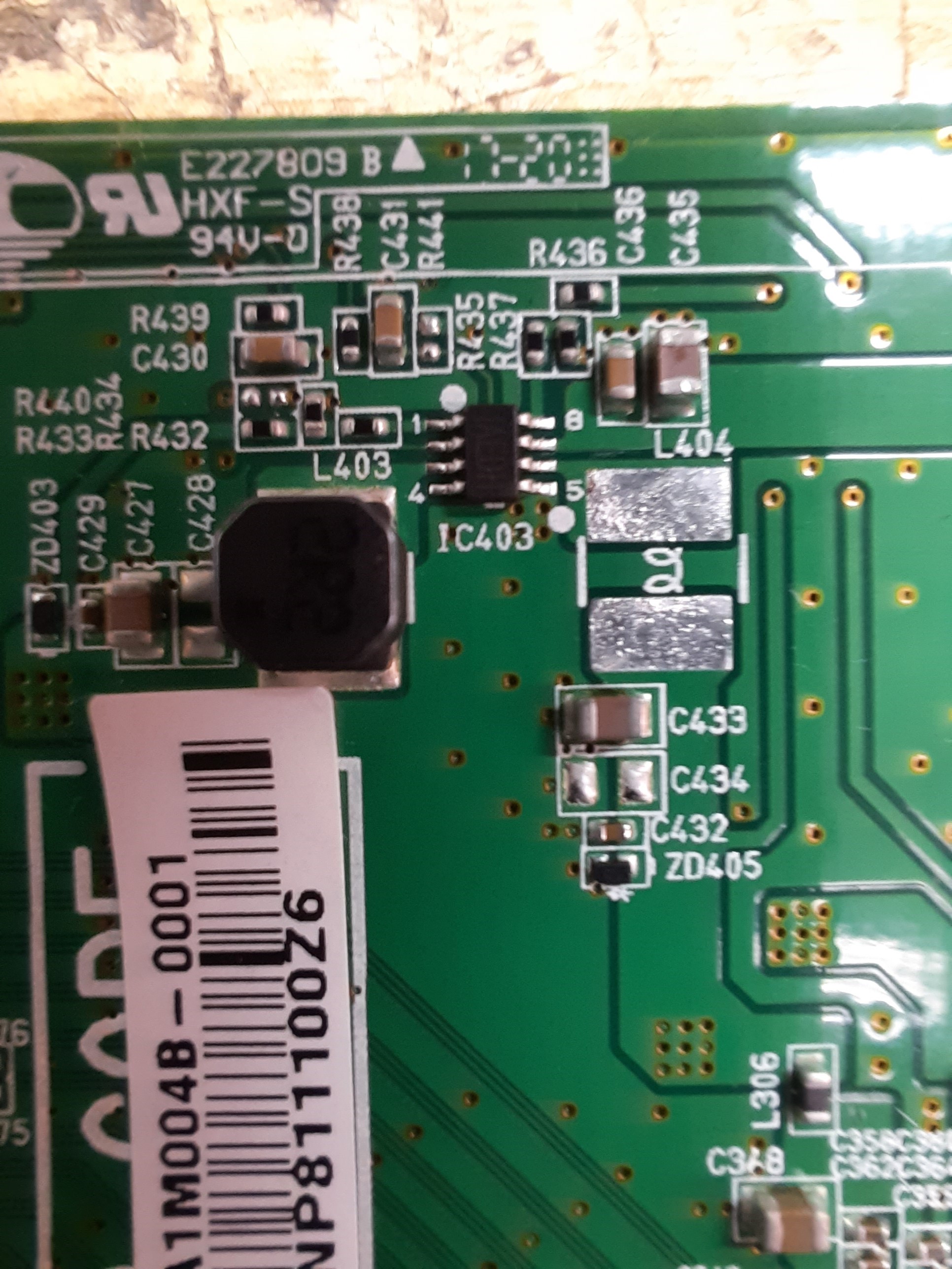

    Hi all
    This monitor not powering with white front LED on .
    Discovered buck converter IC403 to be faulty . It's marked IAEDH .
    PIN 6 ( GND ) measuring S/C with PIN 5 ( 1V8 O/P )
    The 1V8 supplies the CPU , which hopefully hasn't been damaged .
    Package type i believe is SOT23-6 , but could do with some help to ID device .
  • lotas
    • Jan 2016
    • 4670
    • Russia
    Re: 34UM68-P , LG monitor schematic / part ID help please
    Mp2122gj-z
    • zen
      • 511
      Thanks very much Lotas , checked schematic & found same .
      Package type TSOT23-8
