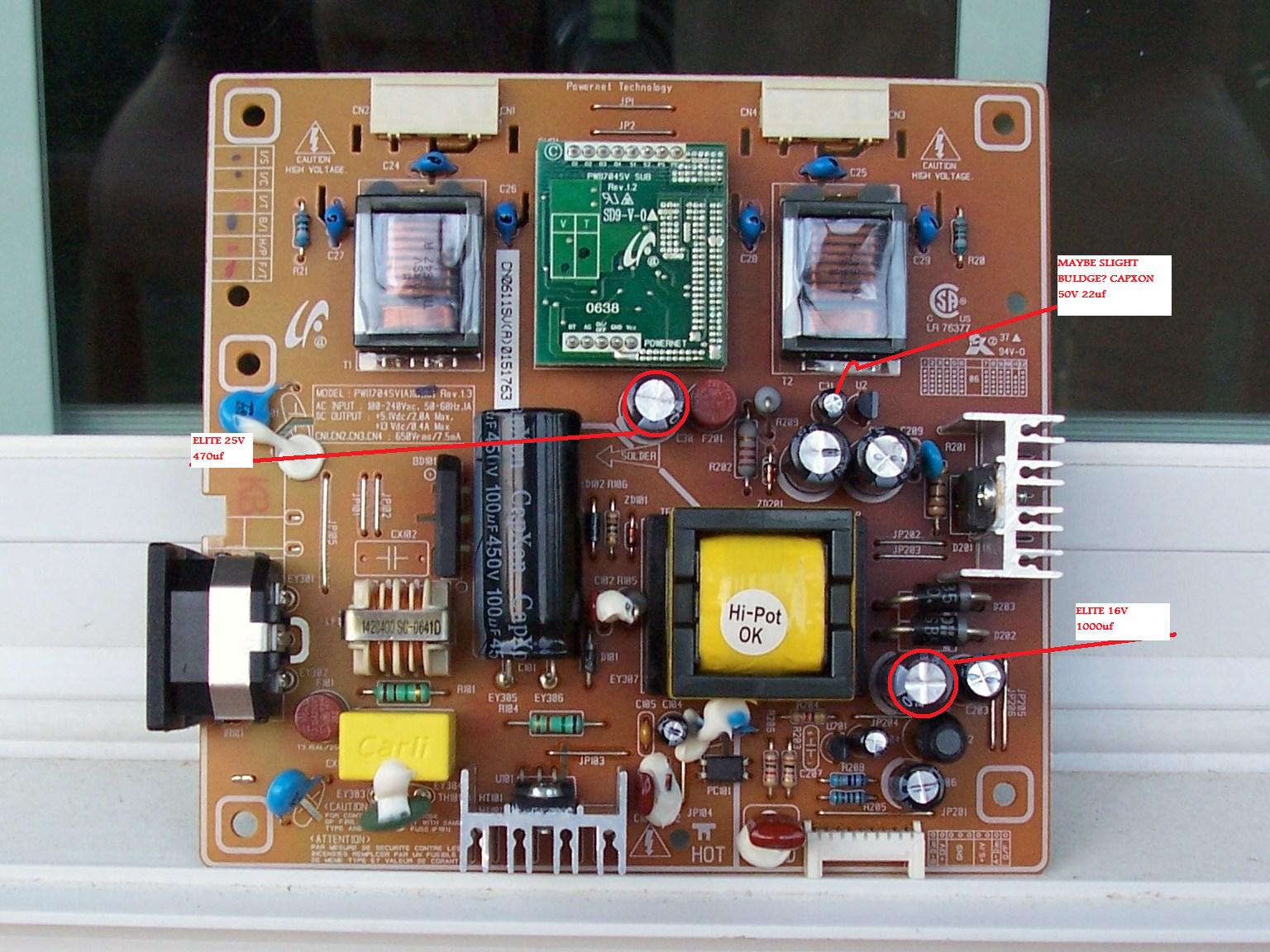

    I have what seems very common on this board, yet on my board(ip board that is) When I turn the monitor on, the power button turns blue and stays blue. Problem is that when the monitor turns on, the screen lights (very dimly) showing desktop, then 2-3 seconds goes "Black" ....however the monitor detects sleep mode (light blinks) when desktop goes into "standby" after idle time. I bought this on ebay thinking I could dive into and maybe repair a few bad caps thus having a nice monitor. Opening the monitor up its for sure someone has been there done that In the image I upload here today shows that they replaced a few caps with "ELITE" series.. I will place the values here also.
    Elite bottom right red circle is: 1000uF x 16v EL(M) 105' c (C)0416 10mm x 20mm
    Elite Center board red circle is: 470uF x 25v E8(M) 105' c (C)0416 10mm x 17-18mm
    now, not sure these are even correct. Anyone might know?
    I'm opening to whatever you guys see fit as the pro's'

    Elite are probably the original caps. I believe 0416 is 2004 week 16 so the caps are 6 years old.

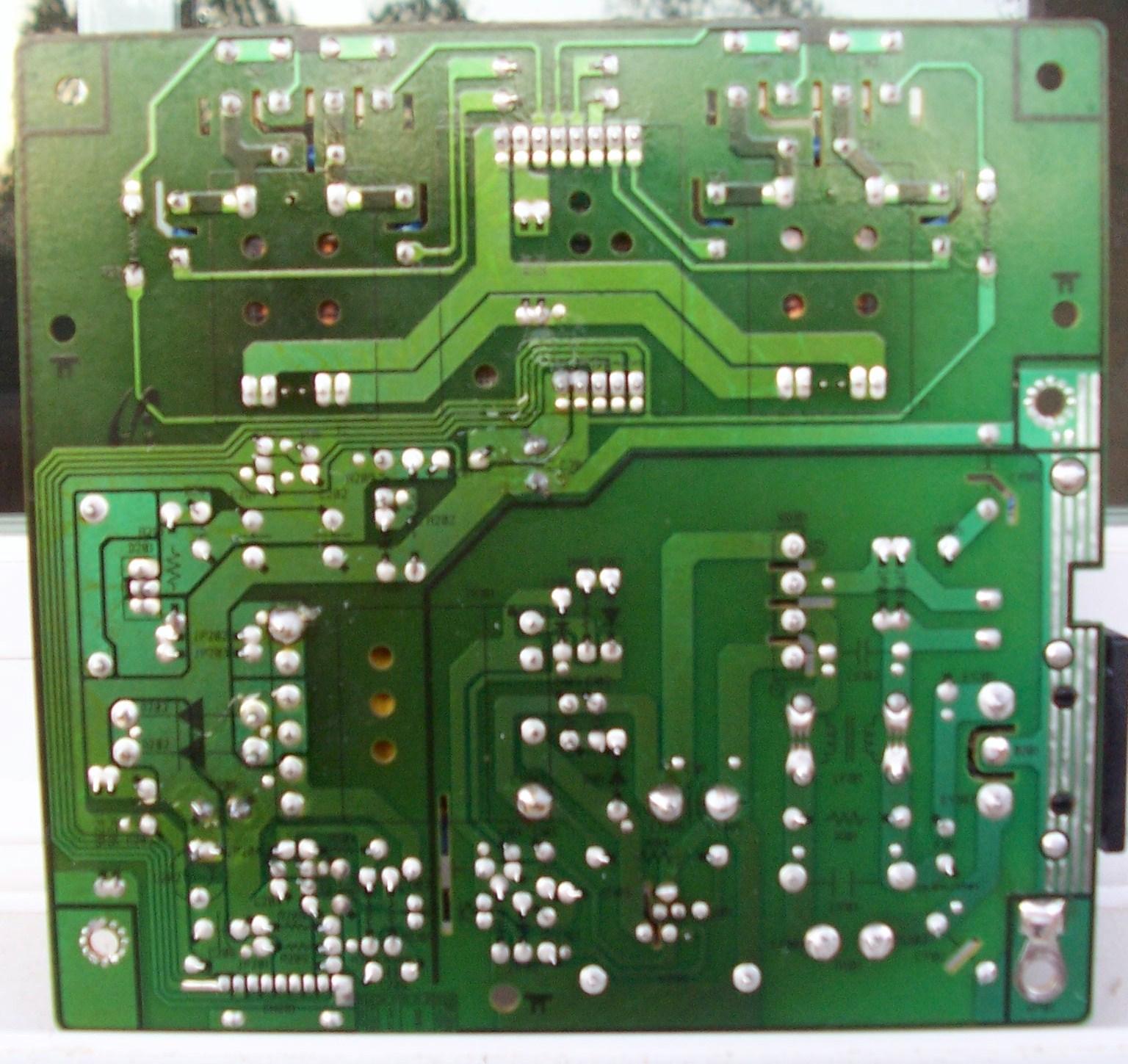

      Odd thing is... on the back of the board in the second photo you can see where someone has been there is how it appeared to me. The board had some residue from flux core solder it seemed. Normally I would have guessed thats where the caps leaked. Unfortunatly those caps dont show any real signs of physical trouble, and the residue I mention on the other side dont seem possible for leakage being the opposite side? The rest of them caps are capxon also.

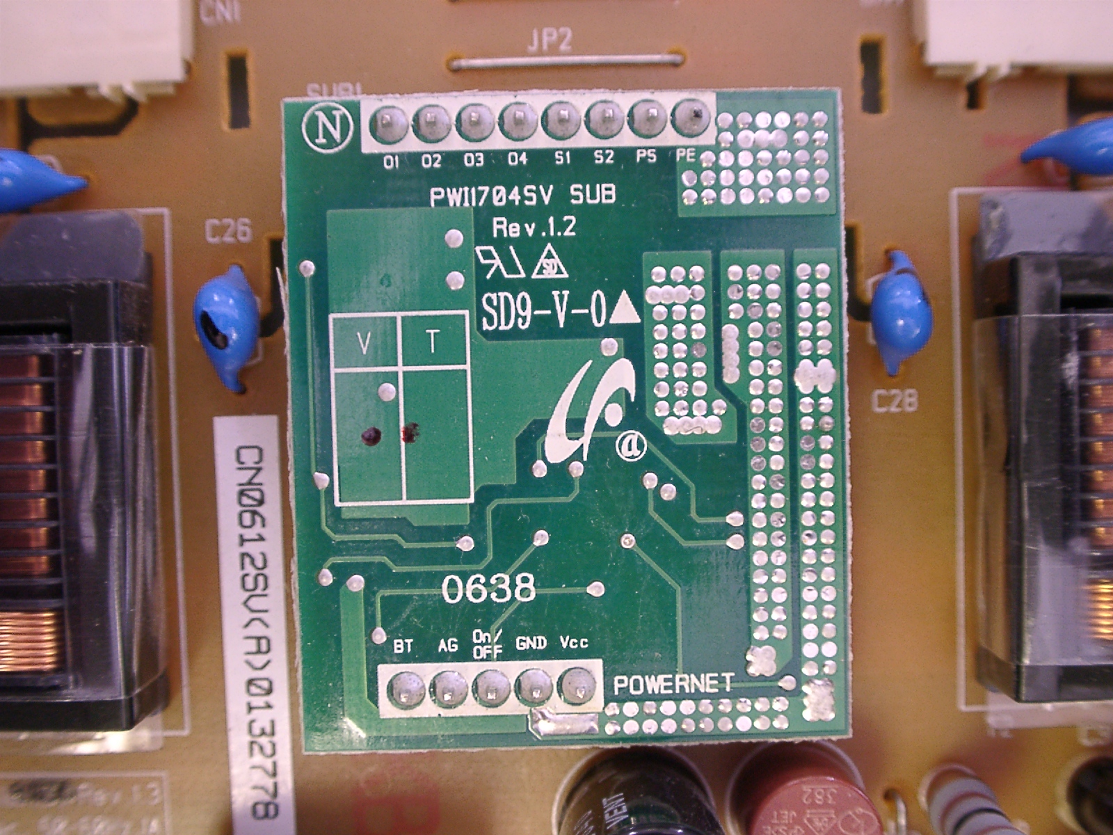

        Odds are your problem is sitting squarely between the two inverter transformers. That green module is a known source of problems on Samsung monitors. You may be able to find some discussion of it in a few threads here.
        It's a peripheral issue, but as far as someone replacing the original (failed) Capxons with NOS Elites, my initial reaction is if someone replaced old, worn-out garbage with old, unused garbage they really haven't improved the situation much.

          .....That green module is a known source of problems on Samsung monitors. You may be able to find some discussion of it in a few threads here.
          PlainBill
          I'm kinda new at this, but a quick learner. PlainBill, since your one of the Holy Grails around here and responding to my post Any chance anyone might tell me what this little green thing is? heheh

            Assuming you didn't just bite into an apple (old joke), that 'little green thing' is a hybrid. It's one more way to increase the circuit density. Sometimes it is also one more way to decrease the reliability.

                                  You can't buy that green hybrid IC.
                                  On this board, if replacing all the secondary caps (including the 470uF/25V you have marked) did not solve the problem, I chuck the board aside and move on.

                                        Here is a pix of the Hybrid IC. It is soldered thru those headers.
