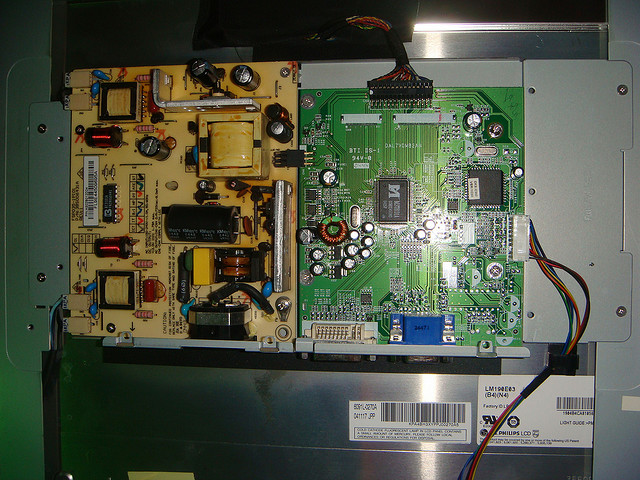

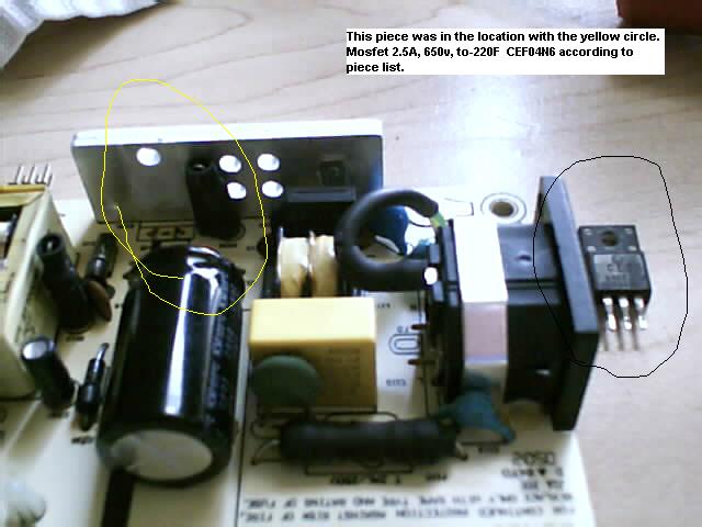

      Ok, just to update, I resoldered the pins to the transformer that is on the failing side of the inverter board. I believe 1 side works, and the other doesn't because of values I've found on other threads match up. I desoldered 1 leg of each resistor that has heat shrink tube around it to test its value, and they are both in tolerance, (which was disappointing because the really big Cap was holding voltage for like 10 minutes and I read on another thread about that happening and a resistor being faulted and that solving that problem... )
      I have also desoldered the MOSFET to test. When my DMM probes are not touching in OHM mode, it reads (blinking) 1 (not blinking)0.00M ohm. Closed (probes touching) it reads .1 ohms. With the continuity tester it has a blinking 1 followed by .000K when open, .001k OHMs when closed. And on diode mode 1.470 V open and 000 V closed. Just point of reference for the following tests.
      ohms:
      1-2 Blinking 10.00M
      1-3 blinking 10.00M
      2-3 17.68m counting down
      1-2 no continuity
      1-3 "
      2-3 "
      Diode
      1-2 1.470
      1-3 1.469
      2-3 .489V
      Can anyone tell me if I have successfully tested this MOSFET? I don't know if I even tested it right or not, and if I did what the results mean. Also, I tested with the black probe on the left, then went back with black on right, and that way they all failed...

        • retiredcaps
          • Apr 2010
          • 9271
          #44
          Re: Viewsonic VX910
          Those results look okay.

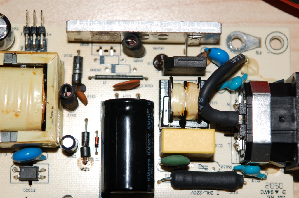

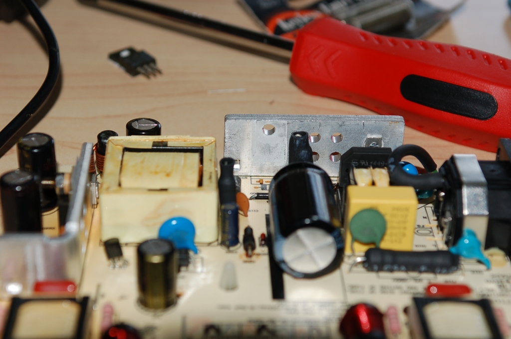

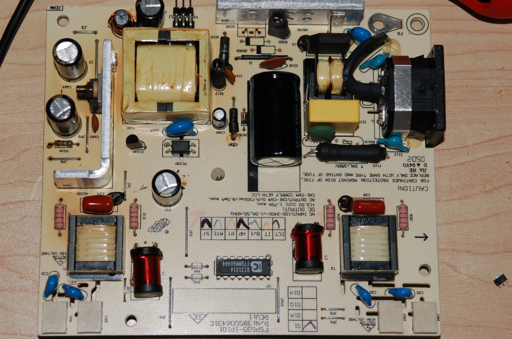

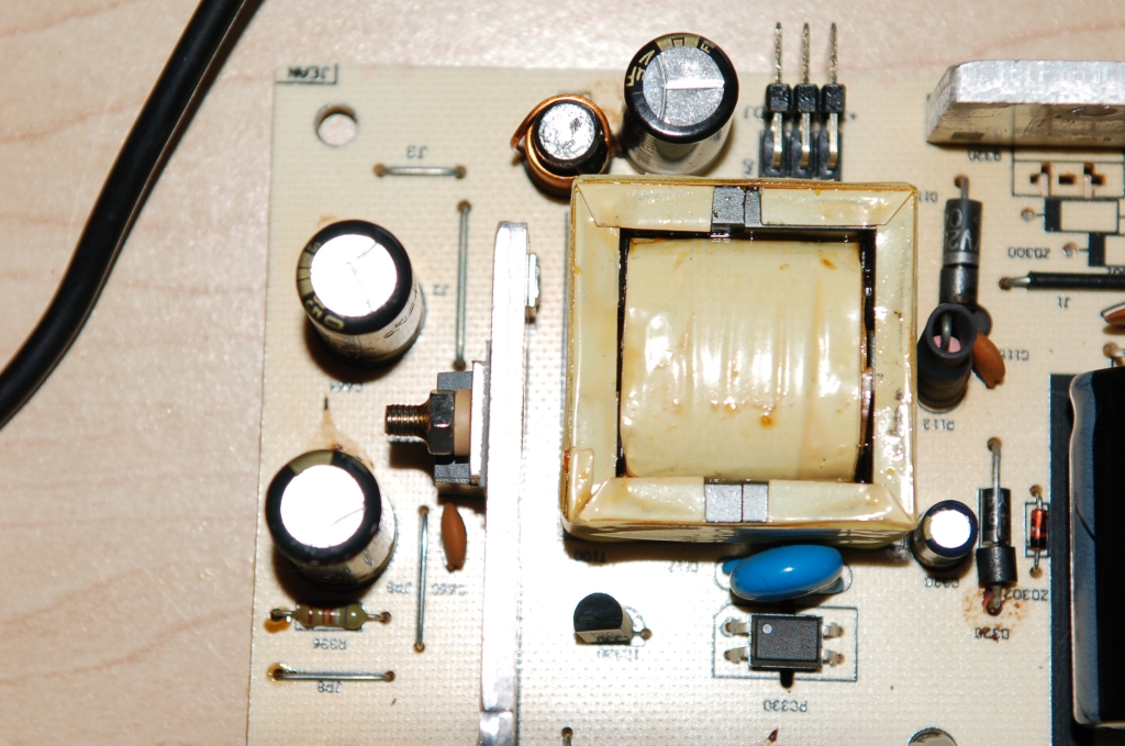

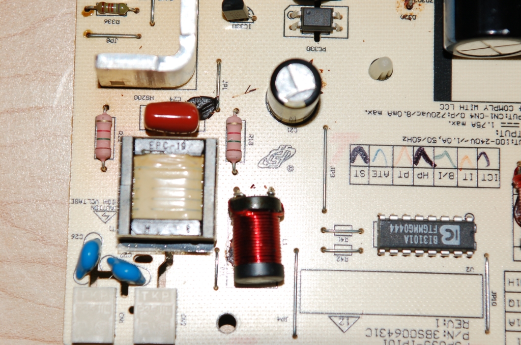

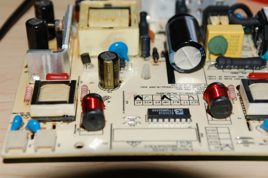

                Here are some good pics. (hint taken) Now keep in mind that this board has been recapped before with blue Xicon's and there is no way to know how much of the burn marks (dark areas) are from previous repairs and my repairs. In this pic, all the aluminum caps have been replaced with Panasonics (including the start up cap now) except for the big Kahuna. I have enough ceramic caps on order to replace the 2 little blue ones right by the littler transformers as well as the poly cap thats red on the other side of the transformer.
                I can't perform that test right now because I have taken off the little transistors on the bottom to replace and I haven't reinstalled them yet. However, after removing them and testing them via ohm and diode test, it actually tested good, but I destroyed the other on removing it (they are tiny little suckers...). So I may not have popped them as I had thought before. No way to know now... OH I just remembered I actually did that test again, and no I don't have the exact number but it was around 55 ohms before I removed the transitors.
                I'll do the test again once I have them back in place. Also, I should have the rest of my parts tomorrow for the other repairs.
                Also, I tested the resistors in R18 and R22 and they are in tolerance to about 10%.
                And also in these pics, the MOSFET is out. you say it sounds like its working?
                • retiredcaps
                  • Apr 2010
                  • 9271
                  #48
                  Re: Viewsonic VX910
                  To test the transformers, you don't need any of those transistors installed.
                  You just need to measure the resistance (with power off and unplugged) of the legs of those EPC-19 transformers. Ideally, they should be measured out of circuit, but let's measure them in circuit once more. If the readings look funny, we can remove the transformer and remeasure out of circuit.

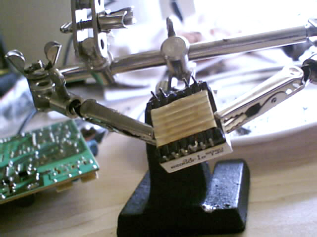

                            I pulled the transformer, because with all this tinkering, and the fact I have a desoldering tool helps, its becoming easier to start pulling parts... I think this may be a problem. I attached a picture of it, and I'm not getting ohms readings and barely any continuity between pins. If looking at the picture, lets call the top 4 pins T1-T4 then Bottom 6 B1-B6. To simplify, I only get ohms readings between pins T2 and T4 429 ohms, B1 and B6 .2ohms B2 and B4 .2ohms B3 and B5 .2 ohms. Continuity tests agree with those pairs. Nothing else connects... Sound good or bad? I can't find a data sheet other than dimensions anywhere. On the parts list it says X'FMR, EPC-19H (12P), D=0.05, 1700Ts, FSP035-1PI01, 150mH Anyone want to decode that please? I know its a transformer, and the model is EPC-19 H Beyond that... It is also 10 pin. The letters on the side of it are
                            SPI STJ00029
                            0505 1 FC
                            • PlainBill
                              • Feb 2009
                              • 7034
                              #54
                              Re: Viewsonic VX910
                              SPI STJ00029
                              0505 1 FC
                              The continuity readings would be normal. Remember, this is a Royer oscillator. Look at Figure 2 in this application note.

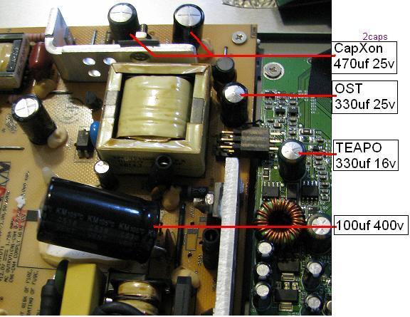

                                Yeah, so I FIXED IT!!!!! With all y'alls help of course. I got my parts in and I don't know exactly what part fixed it, because I just decided to replace EVERYTHING, and didn't do tests in between... SO on this board, I replaced all the Aluminum Capacitors, the 2 ceramic blue caps by the transformer on the right side of the board, the 2 little transistors on the bottom of the board, the red poly cap on the top of the board (with one that was the same amounts, but it was bigger 15mm leads instead of 10mm leads, but I bent them to look like spongebob Square pants and legs and it fit fine... , resoldered the transformer, tested the MOSFET, tested the resistors at R112 and R320 by desoldering 1 leg and doing an ohm reading, all in tolerance. And now it works!!! All in all, less than $20 in parts and shipping, still cheaper than a new power supply!
                                SO my suggestion to anyone who has this board and will come on this thread in the future, change your caps (including the tiny startup cap, but not necessarily the huge one unless its bulging) replace the little blue caps right by the transformers, the red cap in front of the transformers marked 154, and replace the tiny transistors on the bottom of the board. Not really hard, just be careful with your soldering iron that you don't miss and hit something else... :/ And watch the videos on this thread about surface mount soldering. Thanks to RetiredCaps, PlainBill and everyone else that helped me with this repair!!!
                                Someday I'll get a capacitance meter and be able to figure out which of these caps actually failed... Yes, I will keep them until I can check them so I know... LOL

                                      I am happy to your success and I am motivated to fix my 2 monitors now…
                                      Is it possible that you can provide the part numbers and where you ordered them from?
                                      I have replaced some caps already but still didn’t work. (See img)
                                      Thanks for you help…
