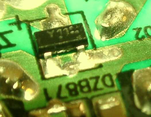

                Can someone with a Samsung Syncmaster 245BW identify on the power supply board the following two zener diode marking on the part ?
                - DZB871
                - DZB872
                Both are SOT-23 packages and start with the "Y" prefix. The next one or two
                digits is what I need.
                Thanks in advance.

                            Re: Samsung Syncmaster 245BW
                            Here are the close ups from mine:
                            Y6 and
                            Y11
                              Y6 and
                              Y11
                              Thanks Lucky13 ! We now have confirmation that they are Y6 (18V) and
                              Y11 (30V). Let's hope those are the correct zener values. I have leaded
                              versions on these zener diode values so I should be able to test it out
                              tomorrow when using the old ICE3B0365J controller. If everything works
                              out I should be back to a flickering display when turned on.
