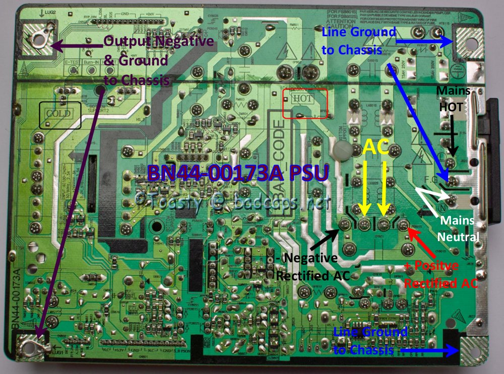

@Toasty,
I did some more checking last night. I rechecked the other two 68 ohm resistors to make sure thay had not opened up after my replacing the first one. They were still good.
I was doing some probing and accidentally hit the hot hotsink with the grounded portion of scope probe. Should have setup that isolation transformer after all! Before I can continue, I will need to get a replacement fuse.
I did not get a chance to try your disconnection suggestion before I blew the fuse.
