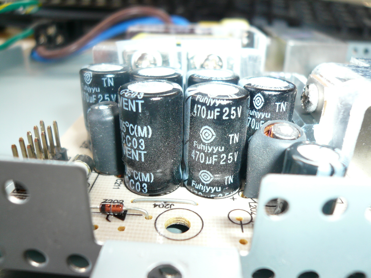

    The monitor blanks off in 10-15 secs after power-on. I've read up a lot of posts on this model LCD monitor. Here's what I know, please correct me if it's wrong: A definite fix for a 2-second display problem is to replace the caps, but maybe not for a 10-15 second display problem. Replace all caps on the board with Panasonic FX series--they may (or may not) fix the problem, but the caps are not good caps because of heat specs.
    So if the caps do not fix the problem, what else could it be?
    Can you please tell me what part numbers to use to get them replaced? I've used DigiKey years ago, but I'm not familiar with their part number filter system.
    Enclosed are pictures. Are there anything else to be said for this problem? I find nothing burned or bulging caps and the fuses (three of 'em) are fine.
    Thank you

    First read this thread.
    You can't use Panasonic FX series caps; AFIK, they don't exist. Nichicon has an FX series; that's an audio grade cap. Don't use that either.
    Caps are one possible cause of the 'two seconds to black' issue, but not the only cause. Other possible causes are bad CCFLs, bad solder joints, arcing, bad transformers, bad diodes or transistors, etc.
    I've described the mechanics of the problem countless times; if you are into self flagellation, search on my name and 'two seconds to black' and read the ugly details.
    10 - 15 seconds (assuming you have timed it)* is an unusually long time for this problem. I'd first check the BL_ON signal (from the logic card to the inverter) to make sure that isn't turning the backlights off. Then start looking for bad solder joints in the inverter.

          Got it working!
          1. Re-Soldered both transformers.
          2. Re-Soldered any joint that looked cold under a magnifying glass.
          3. Replaced the following caps:
          2 - 10MFD 50V C3, C25 5mmx11mm P10316-ND
          2 - 100MFD 35V C10, C11 8mmx12mm P10294-ND
          6 - 470MFD 25V 10mmx16mm P10275-ND
          1 - 220MFD 25V C219 8mmx12mm P10271-ND
          1 - 47MFD 50V C203 6mmx11mm P10321-ND
          1 - 100MFD 450V C201 22mmx30mm P14100-ND (bus wire required for leads)
          That was it. Put it together (partially) to see if fixed. Still running good. Fixed!
