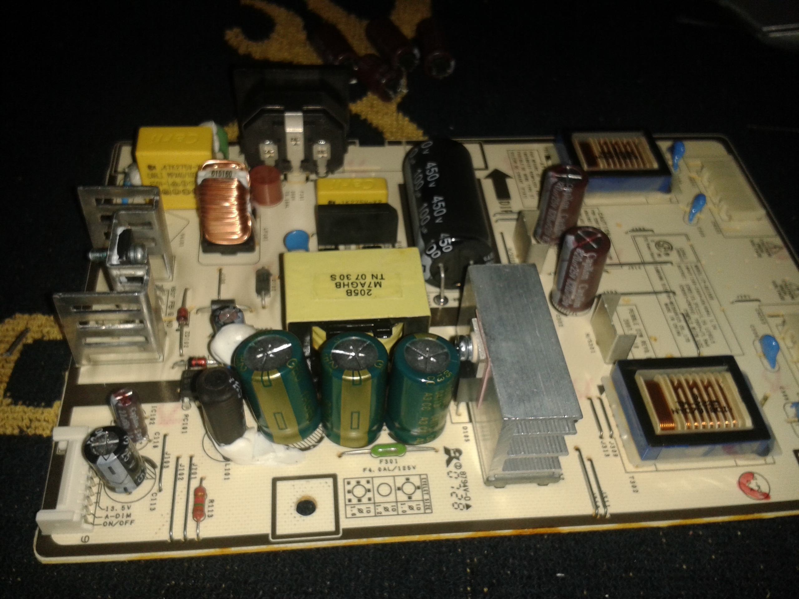

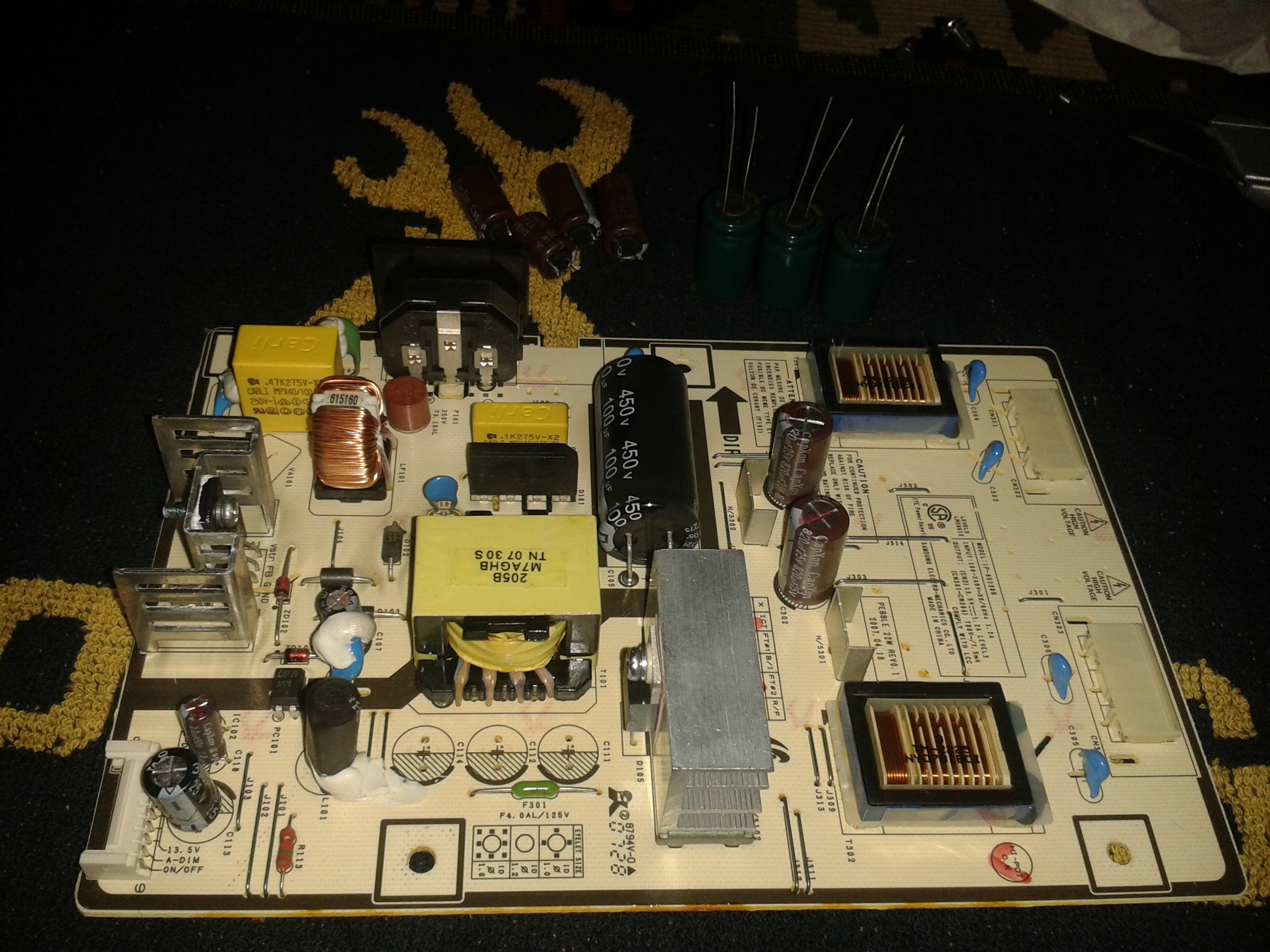

    Here are the other pics

      Just a first quick question:
      Are you aware that capacitors have a polarity and you have to have them the right way round?
      I ask as in your picture the three green ones do not appear to be correct.
        I was totally unaware of this fact lol, i get new caps tommorow and install them the right way then see what happens, tnx for helping.
        • selldoor
          Slow Learner
          • Dec 2010
          • 7870
          Re: Flickering Samsung SyncMaster 2232BW
          Ok - They have a positive and negative side - the side with the stripe is negative and
          on a new capacitor is the shorter leg. The stripe is lined up with black side of the circle on the board ( Mostly but not always) Luckily I think you have pictures before you removed the caps so you replace the new ones the same way round as the old ones.
          If you have any your not sure about ask again.
          The C113 in the corner also seems to be wrong?
            well, this noob did it!, i bought two new caps today and this time i put them all the right way in and...no more flickering! im very happy that i tried it and by doing so saved my money buying a new monitor.
