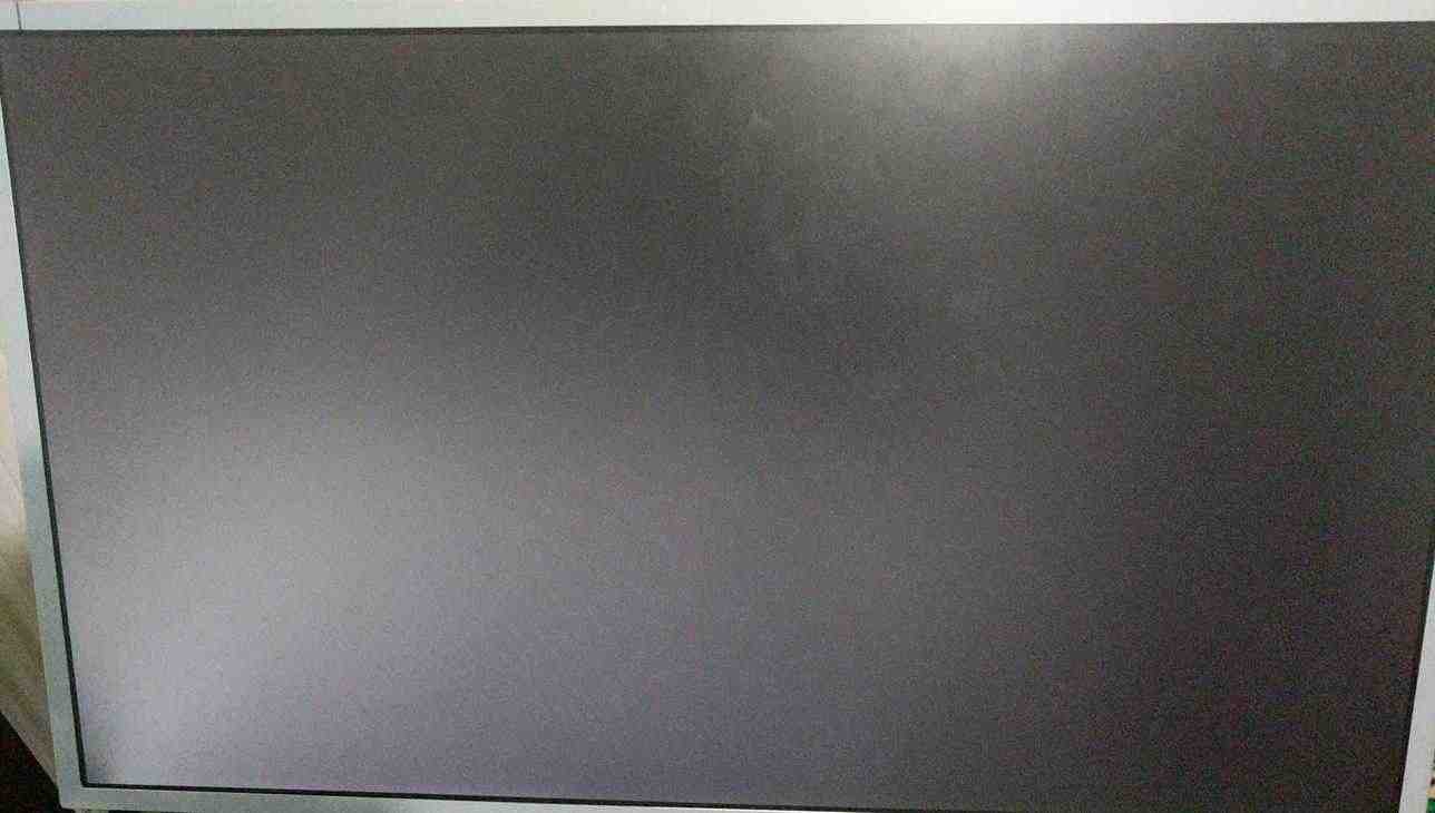

    Hi folks I am new to this forum, so please bear with me.

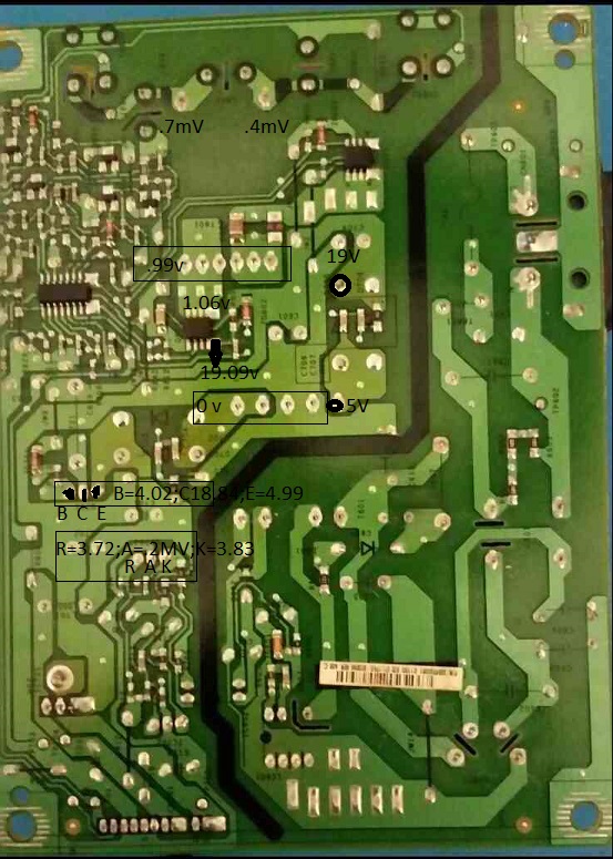

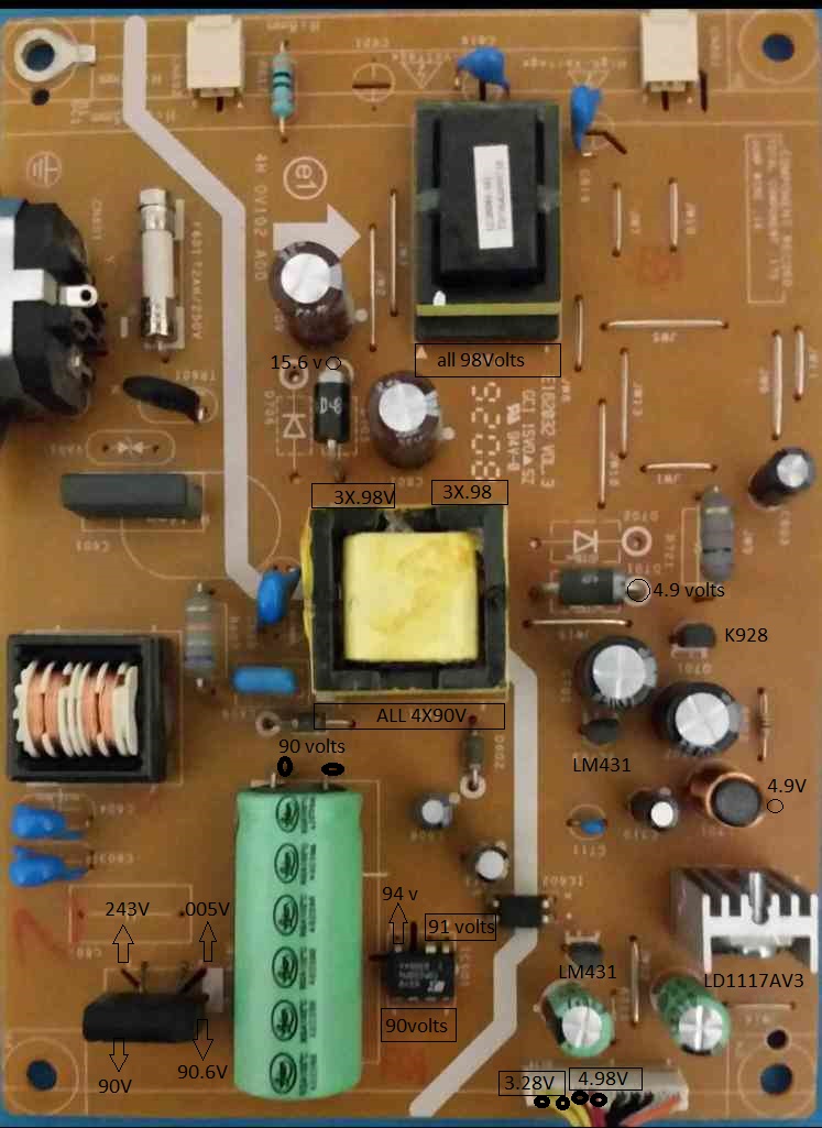

    My monitor first became pinkish at the bottom half of the screen and then second day it became blank. If switch on with the same pinkish colour at the bottom left of the screen and the screen goes off exactly after 10 sec. I am enclosing the photos of the power panel with voltage reading and screen shots. These screen shots were taken using CCFL inverter. You will see the left of the screen is illuminated and right sides are dark. The 10sec. switch off to me indicate some caps are gone, but apparently they seems ok as you can see in the photo.
    I just want to be assured that it is the back light and not any other problem. Thanks for your help.
