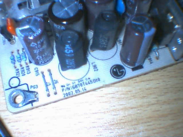

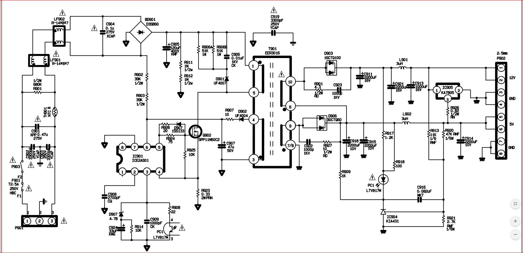

    I Need the circuit Diagram For Dell 1800Fp LG Power Supply. P/N :6870T445D10
    No Power No Output voltage

    https://www.badcaps.net/forum/showth...ht=6870T445D10

      6870T445D10 pdf

        Thanks Guys
