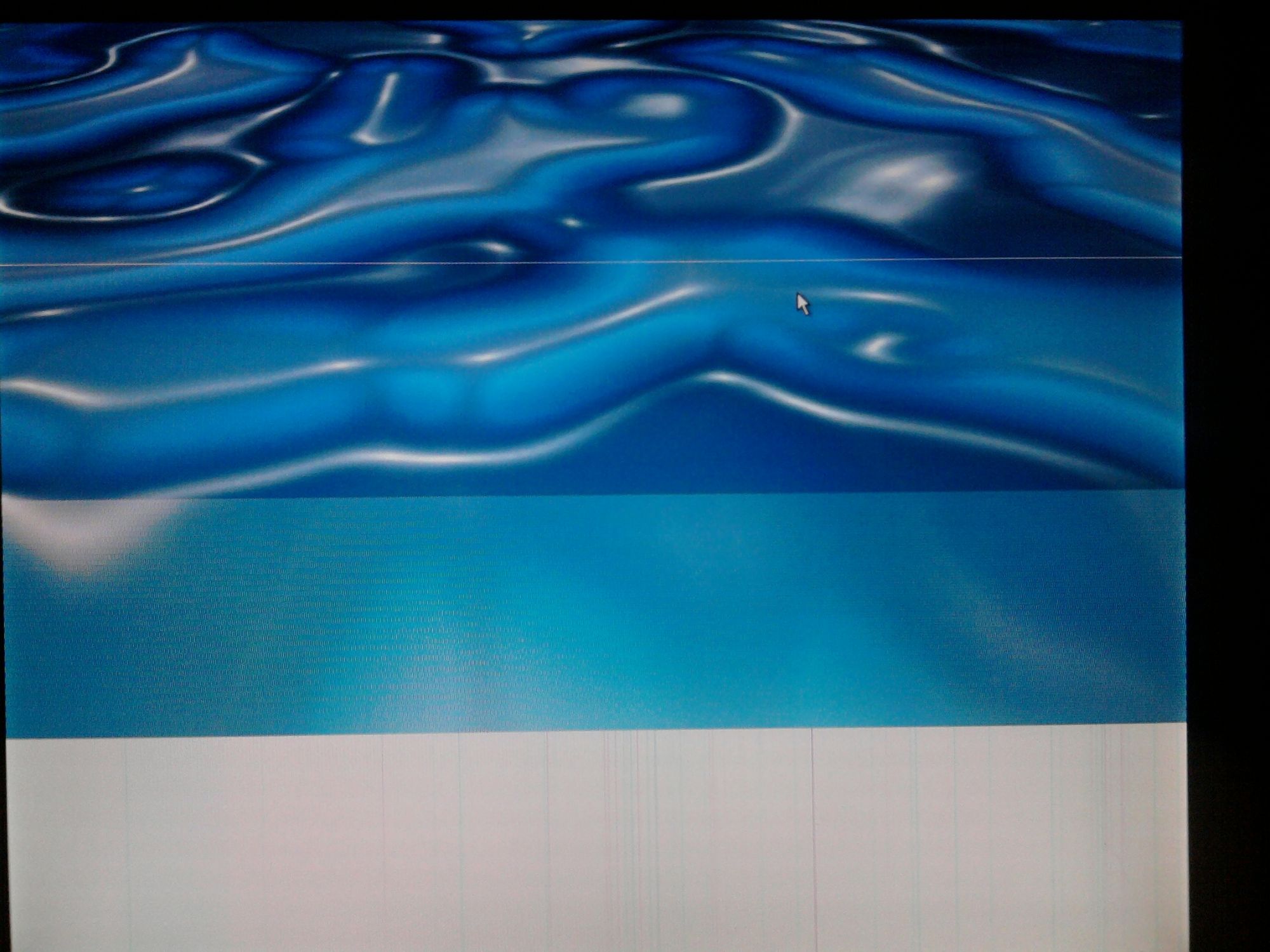

    Hi guys...
    i wonder if someone could help me in this...
    My monitor have a weird problem.. some horizontal lines in the screen
    Please see the atached video and tell me what could be the problem..
    Thanks in advance

    Re: HP pavilion f1723 LCD "horizontal lines problem"
    Panel is bad. (Or connections to it are)
    You could try moving it about etc and see if the problem appears / disappears....
    But you need a new panel.
    Can you give us some history on how this happened?
      hi,
      thank you for your reply.
      IΒ΄ve moved the panel and check the cables.. Everything seems fine!!
      The caps also seems fine.. no leakage or something like that.
      ItΒ΄s very strange.
      It happen all the sudden......

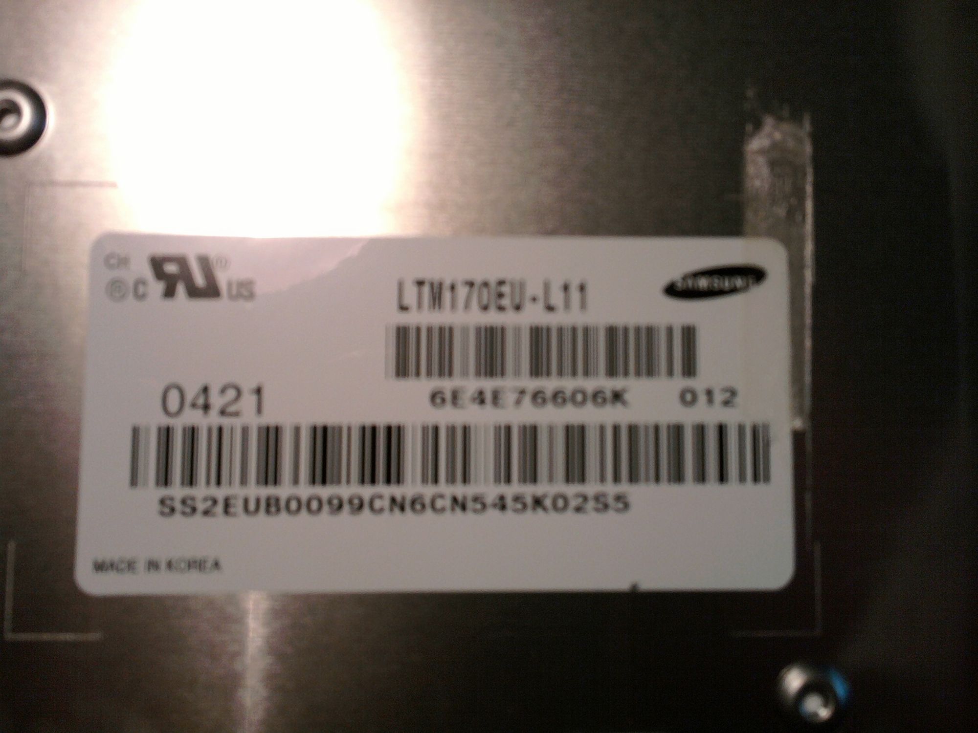

          hi..
          Model and Part Number on the photo..
          • EGuevarae
            • Nov 2008
            • 1336
            Originally posted by rmps
            hi..
            I have two LTM170EUs - both dead, with vertical lines.
