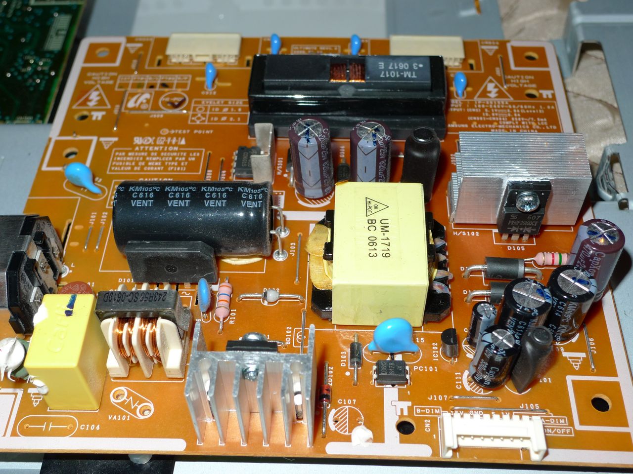

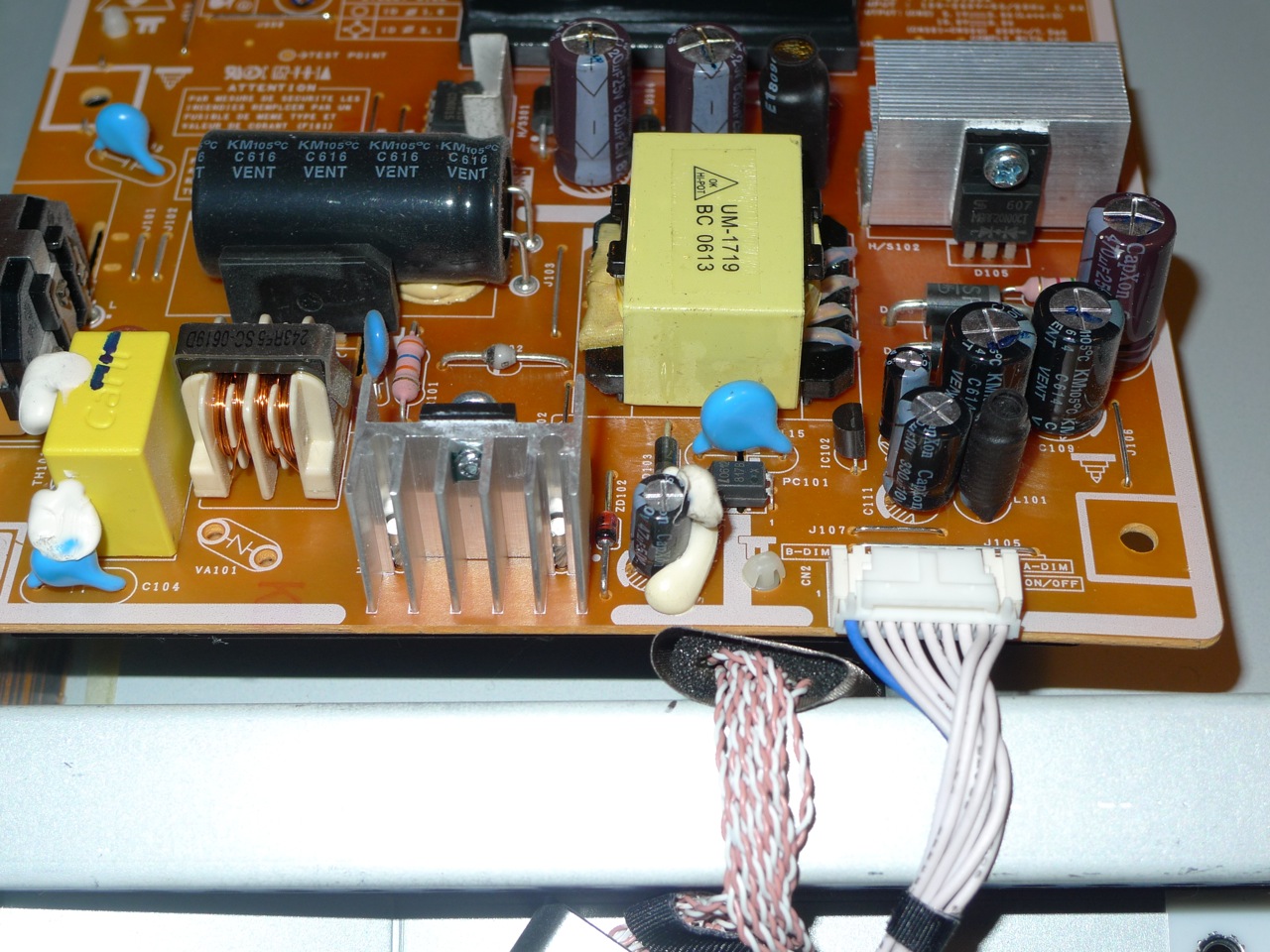

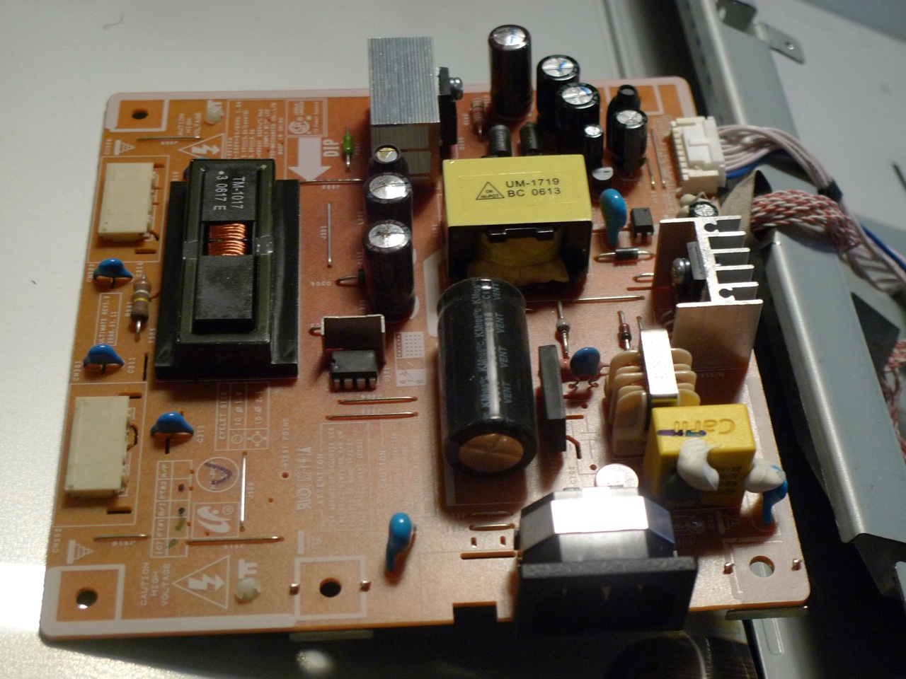

        Ok, attached is the board for monitor #1. As far as I can tell, there are 3 caps with a rubbery substance that I'm assuming is leakage. Two others look like they could use replacing. The rest of the photos are the board from different angles. Any thoughts?

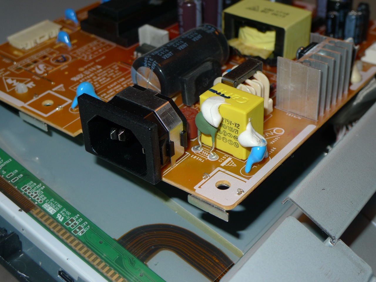

          Nope, that's an adhesive goo used to provide mechanical support against vibration etc - totally innocent, ignore it. If it is restraining a cap you are trying to replace, just separate it with a thin blade.
          Certainly two and maybe three are showing signs of failure (bulging tops). Basically replace all the electros except the big one lying down. If there isn't one already, there needs to be a tutorial on the things you need to do:
          A. Before ordering replacements:
          1. Write down the cap rating (uF and working voltage) of each, together with brand and series (often two letter code).
          2. Note the dimensions of each cap (diameter, height). Replacements need to fit, and using the info from 1 alone can lead to a red face later. Pin spacing is pretty much standardised by cap-size nowadays.
          3. Someone here will advice which caps to order as replacements, and where from.

            Took a decent look at the pics. Three definitely bulging, and yes your board has the polarity marked for you. But you will still need your sketch to record value vs location.

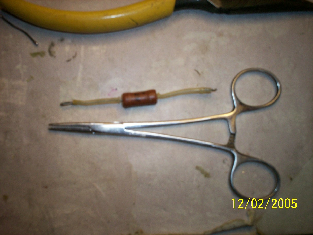

              I discharge caps using an axial leed 1k ohm resister with insulation on the leads and a blob of solder on the lead ends. Then short the capacitor leads with this resistor, count to 10 and your done.

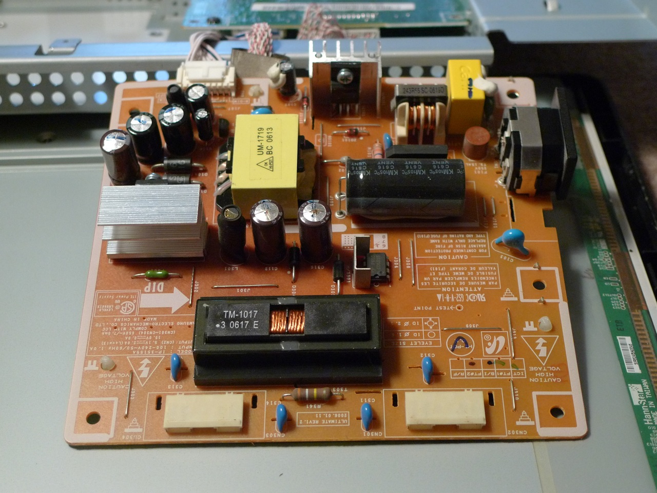

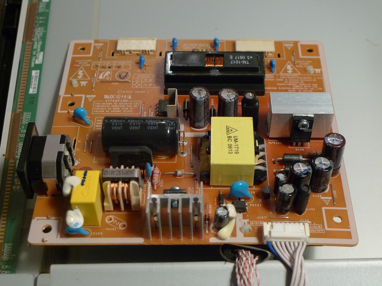

                    Here is the photo for monitor #2. Looks like the same 3 are bulging. That should make replacing them easy. I wonder, should I replace all the caps while I'm at it, or just the 3 that appear to be bad?
                          i'd like to see a pic of that thingy..... would really be appreciated.
                          • Kevin O'Henly
                            Ontario Member
                            • May 2009
                            • 48
                            Re: Twin Samsung 931b monitors
                            See picture of the cap. shorting resistor.

                              Seems like this is a dual output board (13V (measures about 12.6V)), (5V (Measures about 5.3))
                              You can easily replace those 25V ones with 16V ones. 10V with 6.3V. General use capacitors where Low ESR is not needed. You might even get by cheap with replacing all with 16V 1000uF caps (if there is space)
                              Nothing is critical here. Not ESR, not Capacitance.
                              After the rectifier but before the choke (PI filter) keep low capacitance but high voltage-25V.
                              After the rectifier and after the choke, use caps rated at slightly higher than operating voltage (16V for 12V).
                              You may even leave the caps already there and replace only the ones bulged. It will
                              save you some work and the LCD should work just fine.

                                It really doesn't pay to leave any bad caps on the secondary they are cheap and it will save you the labor of having to do the same job twice.
                                Not to mention the black caps are also Crapxon its straight foolish to leave the same brand caps on that board that bulged.
                                When working with lead free boards I always wet the joint with some leaded solder to help the braid wick it away.

                                  • PlainBill
                                    • Feb 2009
                                    • 7034
                                    You need a good soldering iron to do the repair. I had problems with 45W, there are quite wide traces (helps a lot to heat with a dryer). Once the iron got really hot it worked flawlessly. Anything under 20W is just to weak.
                                    Gas operated soldering irons are not worth it.
                                    With all due respect, that is REALLY bad advice.
                                    It's going to cost less than $10 (including shipping) to replace all the caps on each board with first rate low ESR caps. While I do appreciate the value of a dollar, the fact is low ESR caps are required for the output of the SMPS. Reducing the voltage to save a few pennies and using general purpose caps sets the owner up for replacing the caps over again in a few years - or maybe even sooner. There is a thread here where someone used standard ESR caps to recap a monitor, and the inverter would shut down after a few seconds. Replacing the caps with high ESR caps solved the problem.

                                      No, it is not the cost of capacitors. It is that this SMPS was designed to work with cheap capacitors and using LowESR in such circuits can be detrimental to the SMPS performance, especially in terms of ripple.
                                      LowESR does not necessarily mean good performance nor long life.
                                      Actually, you have to try it out. Sometimes it is better to make as little alterations to the circuit as possible.

                                        Actually this SMPS requires low ESR at high freq. The capacitors placed in there when board is fresh was around .02-.06. Our shop services Samsung stuff so I have full access to new boards when ordered in to replace defects under warranty.
